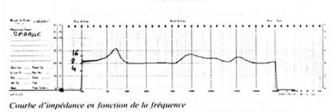

I am a novice DIY'er, i have decent soldering skills but not much electrical knowledge. i do read alot here and slowly do start to learn more. my speaker setup for the moment is a pair of cabasse sloop M4 speakers, 94 db. sealed, 12 inch woofers and presumably, going of old documentation from cabasse, a minimum of 8 ohm impendance as you can see in the attached picture.
