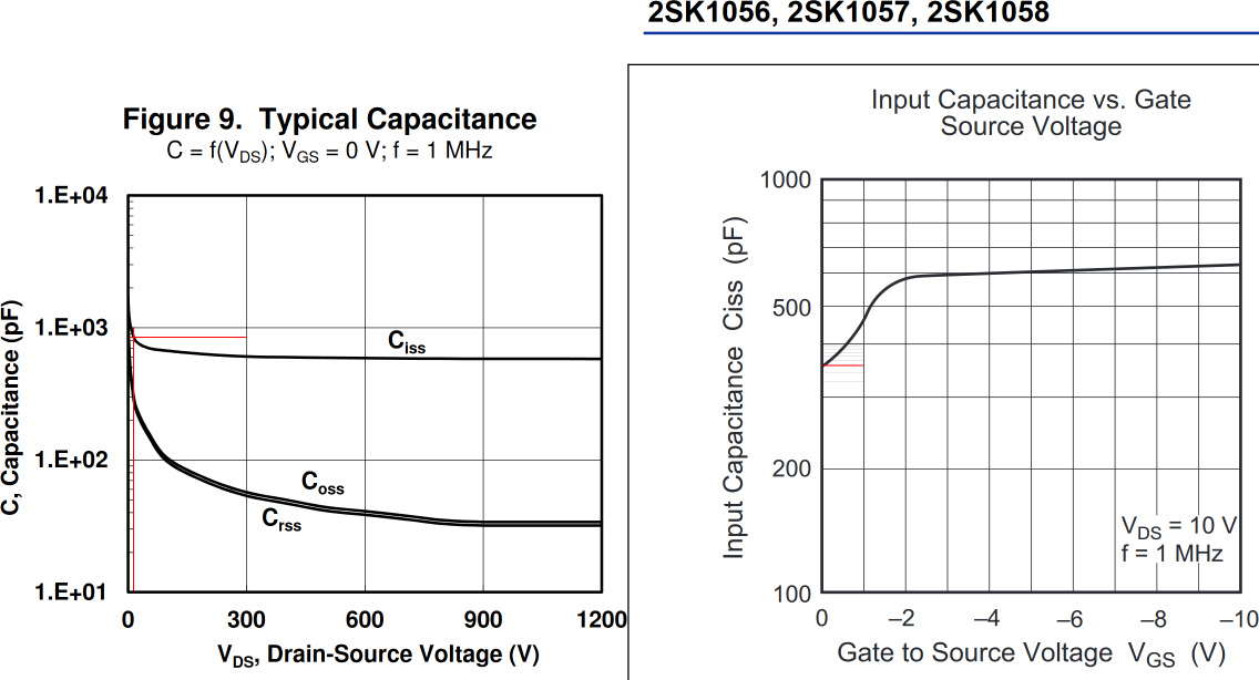

Weeell, but the SJEP data sheet gives the capacitances at Vds = 100V / Vgs = 0V, while 2SK1058 is quoted at Vds = 10V / Vgs = -5V. If you correlate the data based on the charts (at least for Ciss, there's no Coss / Crss chart in the 2SK1058 data sheet), you get:
SJEP120R100
Ciss = ~850pF
2SK1058
Ciss = ~330pF x 6 = 1,980 pF
Still a lot, but not 5.5x as much, "only" 2.5x. So perhaps 4 in parallel selected for the highest yfs would just about cut the mustard... (2SK286, with 1.4 typ / 2.5 max yfs and Ciss of ~400pF, could still be a cheaper / easier to find option.)

P.S. Found the capacitance charts for the 2SK1058 in TO-3, née 2SK135, so at comparable Vds / Vgs (10V / 0V), we'd get:
SJEP120R100
Ciss = ~850pF
Coss = ~300pF
Crss = ~300pF
2SK1058
Ciss = ~330pF
Coss = ~310pF
Crss = ~10pF
