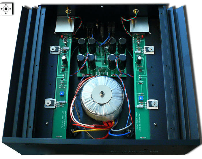

Ok, the Edcor's are shielded in the factory M2 (so probably not much more you can do without much work):
The Edcor's are the small boxes just below the RCA connectors.

Thanks for the pic, I can at least crack the case and double check the Mu shields are in place.
