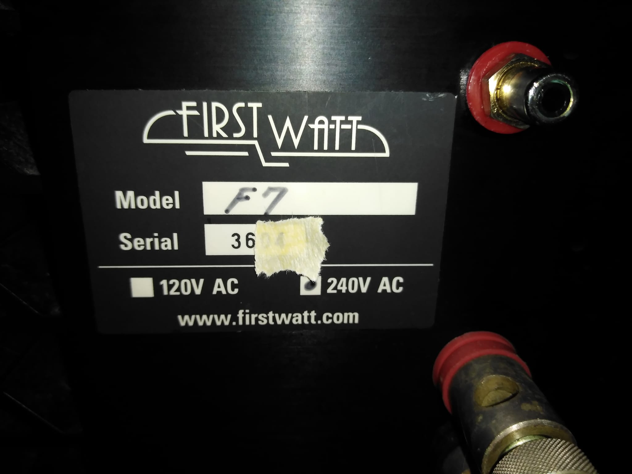

The RCA and binding posts in post #1 also don't look like what I have seen on other Firstwatt amps.
The one binding post clearly visible looks corroded to me. 🙁

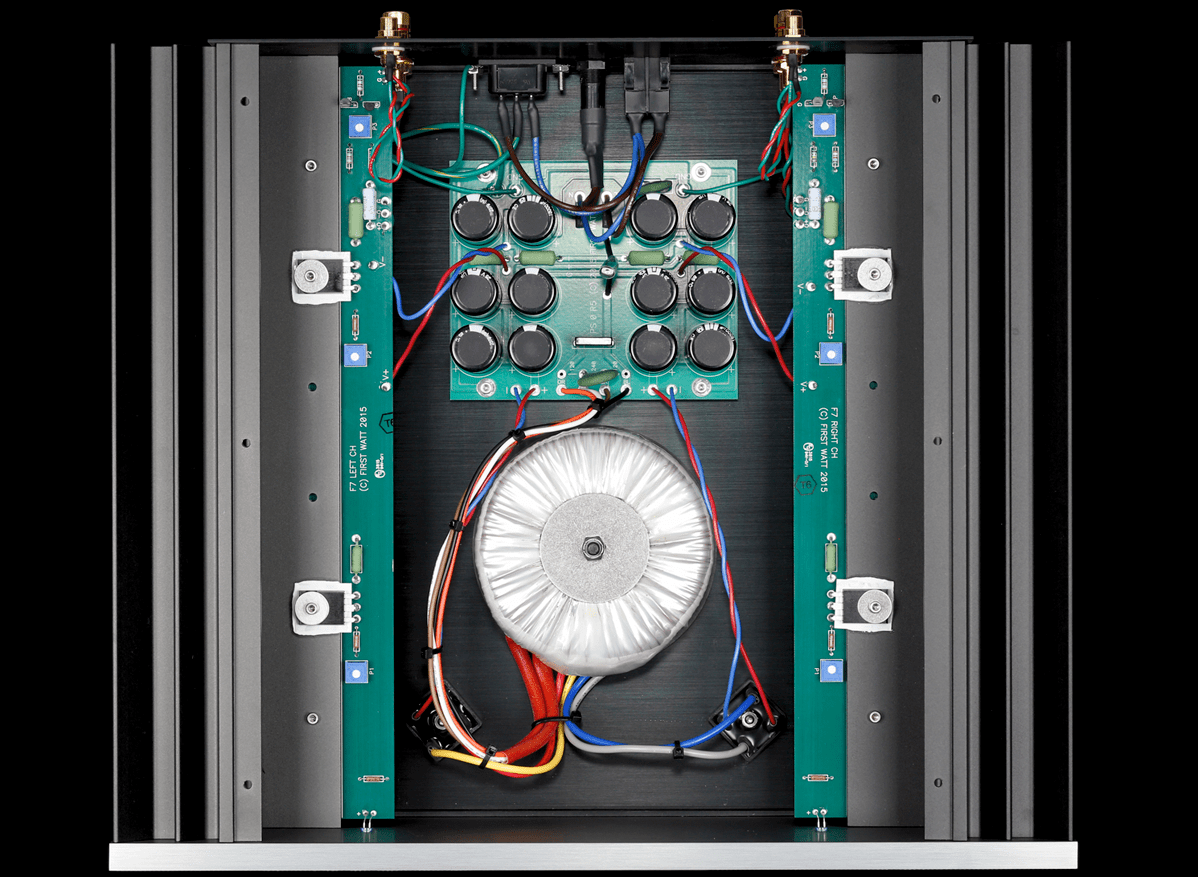

6moons has a review of a pilot run F7 with a lot of photos. It might not be exactly the same as what you have but
should give you an idea of what an original would look like.

Could it be a clone, as indeed the sockets look wrong, and the label is too close to them, compared to published production photos?
It's real my friend bought it new. He put those big ugly things on with silver cable. I guess all I need to know is the optiman bias current. Everything else I can restore to original.
