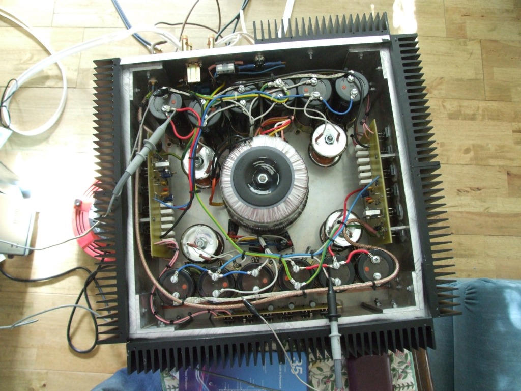

The Aleph 3 (I think - the baby of the Alephs) is also not too difficult to build, the Aleph 4 and the Aleph 1 require some serious matching of components which make them very expensive.
I didn't build mine, it was inherited by my Son-in-Law, luckily some of the photos of it's build are still in existence.
A true Aleph 4 is absolutely immense. This one has 2 x 500VA transformers in it and is just one HUGE heatsink.
The F5 is a dwarf in comparison.
