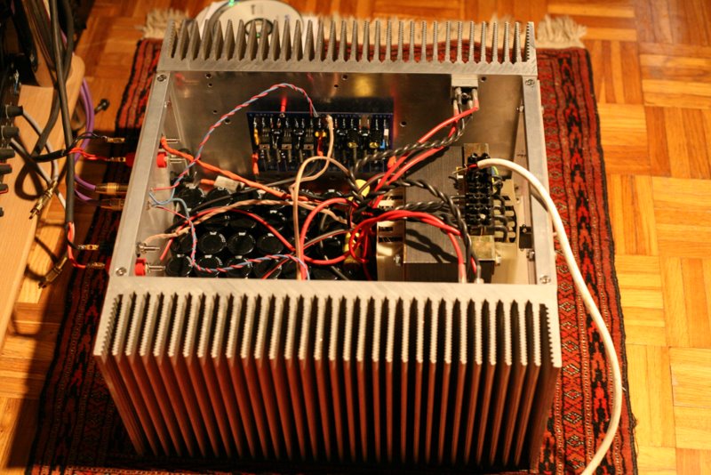

I make both F5 and A5. F5 is wery pleasant for ears ,fast and deep bass,very open sound,
A5 is more smooth,very detailed and has more dinamic and power than F5.Both good amplifiers.I have one problem with A5 with crc PSU.when i turn it on i have big thump on loudspeakers,about 6 v DC.what do you suggest?
this is aleph 5 ,but is not finished yet.

i would not fit the bridges on the main heatsinks, which vill run them uselessly warm. The bottom plate is a better place, imo.
Thank you,i will put bridges on bottom plate when will replace PSU resistors with coils,because bottom plate is even hotter.Hm i think the aleph 5 is better ,after listening about 5 hours of jazz and acoustic music on A5 i plug back F5 and sound become less detailed and open,more flat,maybe because of my loudspeakers.Dont understand me wrong,F5 still sound superb, but A5 is sounds better on my speakers.
