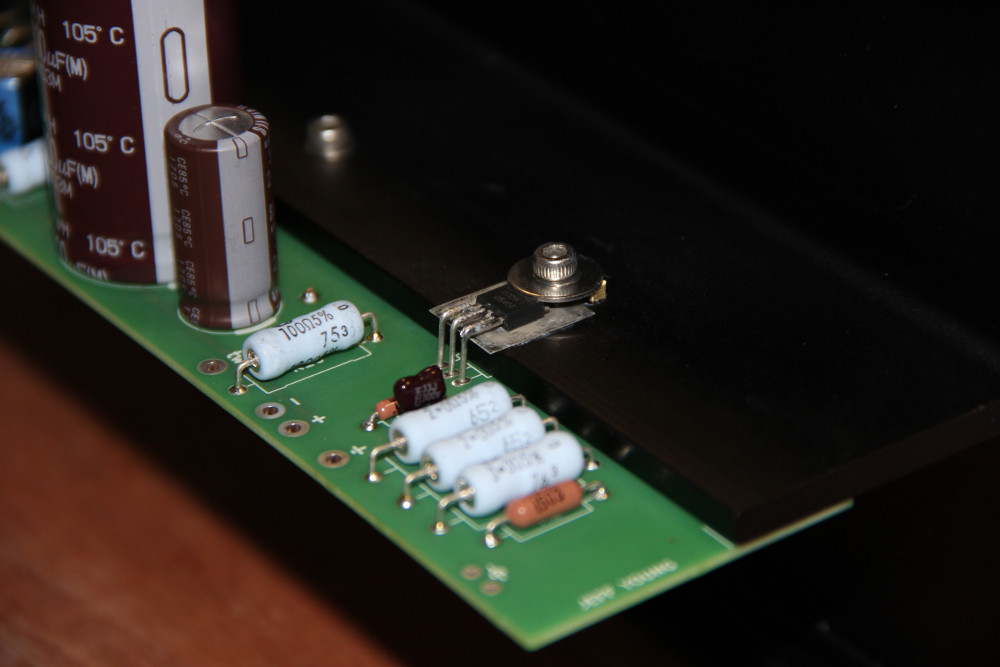

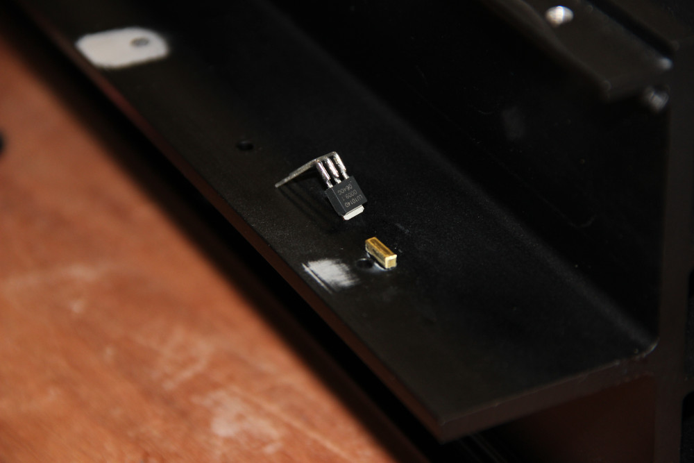

For those of you using flanged heat-sinks, here's how I mounted my JFETs:
I trimmed the legs to just cover the horizontal distance, and soldered on resistor leads to cover the vertical distance. I super-glued a small piece of brass bar behind the mounting hole to act as a fulcrum:
attachment.php
From bottom to top: polished heatsink, thermal grease, mica, thermal grease, JFET, fender washer, Belleville washer, cap screw:
attachment.php
Jeff.
