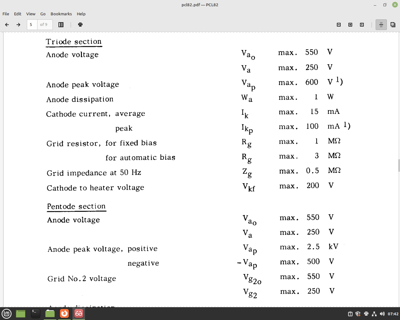

Re the valves operating conditions, download the full datasheet for the complete specs. What you posted and see on the valves main page on the Valve Museum's site is only a small part of the data available. The first place to start with any valve is the "limiting value's" see attached. the full datasheet also gives a couple of "standard" operating conditions for both the triode and pentode section, but you don't have to stick to these conditions. As long as you don't exceed the "limiting values" your ok.
Can you post your DC readings for the amp again please, including the HT at the first big cap - C1 and at the second big cap - C2, voltage out of the heater reg and voltage after the LM317.

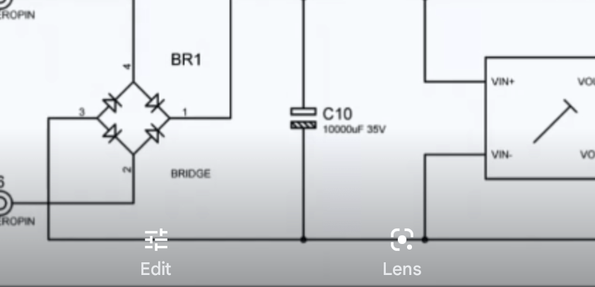

Might be worth noting that C10 from the schematic was omitted from the circuit entirely. I never initially intended to use a MT so left it out.
I do have it though so could ad it in.

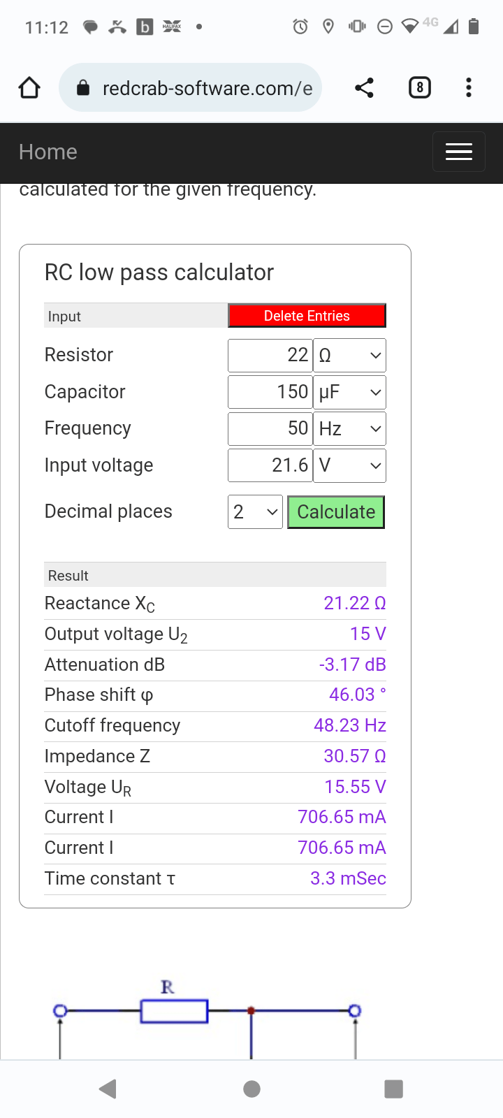

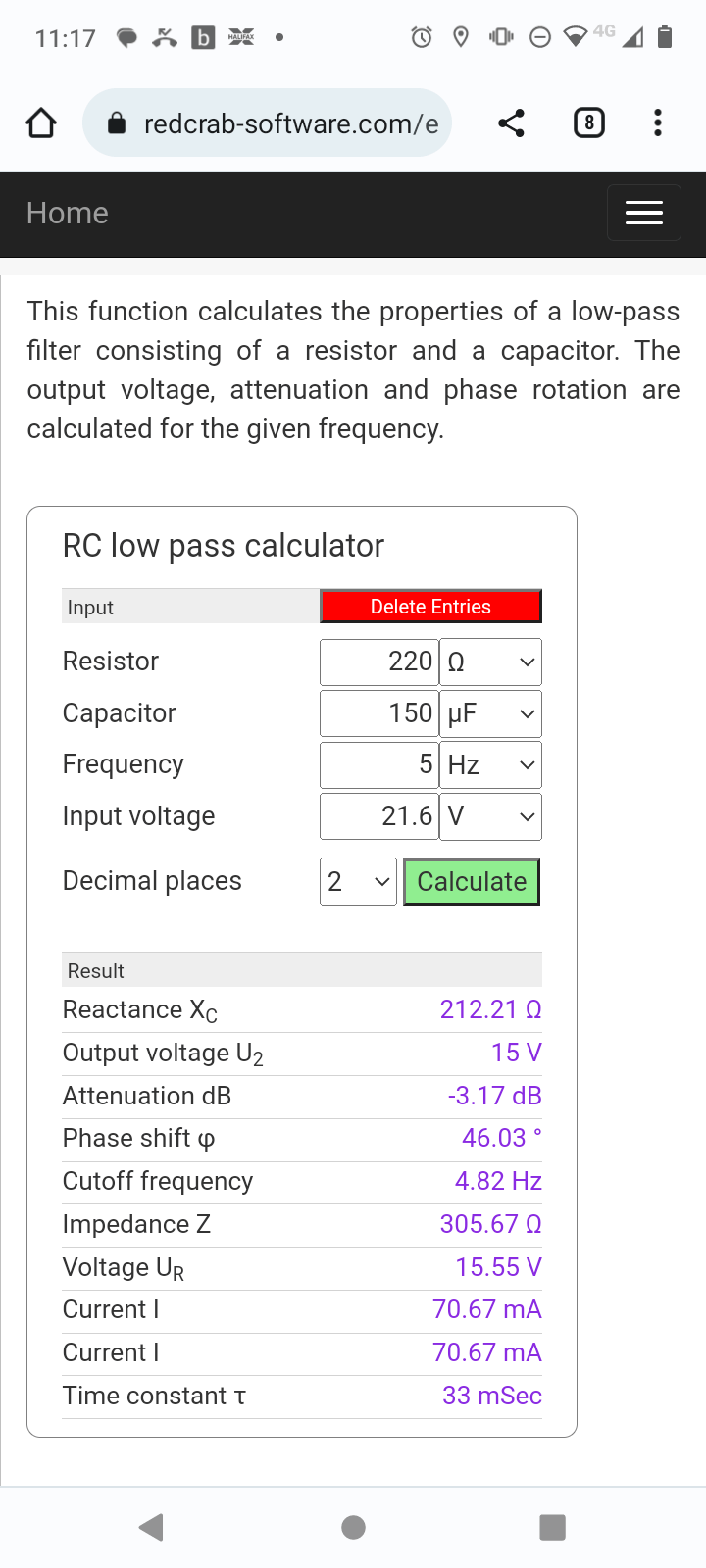

The 230 - 12-0-12 MT arrived yesterday. I've installed it and knocked up a bridge rectifier to supply the heaters. Output after rectification was 21V DC. I'm putting this down to the fact that the mains voltage here is getting on for 250 volts. I is the inputs higher than obviously the output will be?
I'm just looking at RC filters to get this down to 16V.
You both mentioned 'RCRC' filters in relation to he B+ voltages. Is this just 2 RC filters one after the next?
Anyway, I'm using an online calculator to work out the values I need for the capacity and the resistor for the heaters RC filter. For the frequency value, is that just 50?
Providing the above his correct, this is the closest I've been able to get it.
I will take a reading of all the voltages once I've got the heaters running off the new MT.
Can't wait to ditch the laptop power brick for good 🤣
Yep, tfmr/linear supply is better, far more reliable.
My mains is about 246v RMS so yes, higher IP V = higher OP V in regards to the tfmr.
Re dropping R, using ohms law you have 21v, you want 16v, are you using the LM317 here?, so, if no LM317 we need to drop 5v, so 5v/0.6A = 8.3r I make but thats if valves are connected in parallel, if heaters connected in series, then 5v/0.3 = 16r ish, but you'll find you may need to experiment so try a 10r or 22r and you should be about right. A 5 - 10w jobbie should be about right, again experimentation will help suss this out. You can just power the heaters only for a short test.Yes, it's 50hz but it doesn't specify if rectified, in which case it'd be 100hz.
Re RCRC filter, yes, it's just one RC filter after another or you could use an RC filter then two RC filters per channel.

I think the last thing I tried was a 3r3 which got to 10ish VDC. Which, actually worked enough to produce music but I can't imagine it will do the valves much good in the long run... I am getting low on resistors so wil order more of a selection to play around with. I only have 2w as well so I'll get some 5w ones this time around.
The heaters are wired in Parallel. I was using using 50hz in he calculator.
All good learning!
When I've checked the rectified DC voltage for the heaters again, it's coming out at just over 16v. That's with the RC filtering part removed, measured on the diode legs, (off load). I'm sure I measured 21v yesterday :scratch:

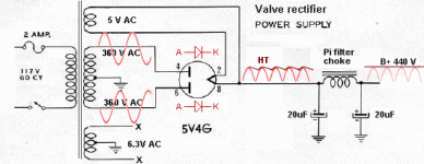

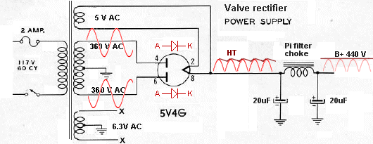

Any DC supply must have a rectifier and at least one cap. If you rectify AC with just a bridge rectifier you won't get 100% DC. Any power supply that delivers a rectified DC current will have to some extent an AC component or ripple voltage, see the attached image (courtesy of Lenard Audio Institute, see -http://education.lenardaudio.com/ ). It's a HT supply but the same physics apply. Without getting into the subject in more depth covering peak, RMS etc your heater supply isn't up to the job, you need a reservoir capacitor. This is why you are getting "odd" readings.
Right, experiment time.... connect a bridge rectifier to the winding on your tfmr, measure the voltage from the + & - on your bridge. Next connect a 20r or two 10r resistors from + & -, measure V. Now bung a capacitor after the bridge, measure V, then connect your resistors, again measure V. All four readings will be different, figure out why, do your research.
There's loads to cover here but most of it is basic electronic theory, which your weak on at the moment, which is cool, we all started out knowing b*gger all.Gen up on AC v's DC current, rectification & series parallel connection of components.
