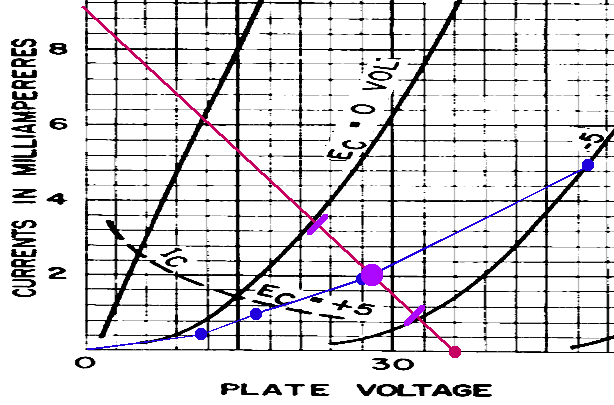

...Quickie is my design,...The circuit is very simple....
Thanks. It plots as 28V 2mA, Zout<2k, Vout 10Vpp or 3.5Vrms, gain near 2, THD surely <5% at clipping and few-% at normal signal levels.
2mA/channel gives >100 hours on standard 9V batts. The way I used to listen, that's a month. Some folks listen 16 hours/day and then it is only a week.
