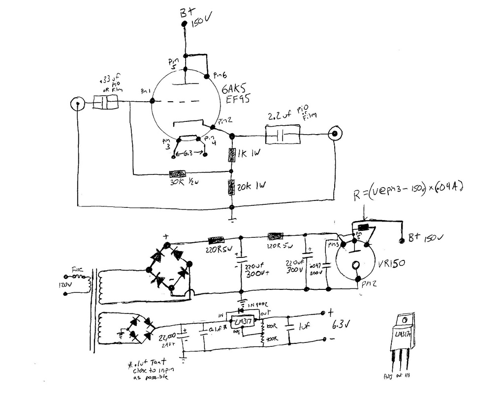

Ok, so that build has a high chance of issues that a first time builder would struggle troubleshooting. thanks for keeping me know, i really don't have the experience with analogue stuff to know what I'm looking at. what about something like this, i found it on a Canadian audio forum and know the little Yaqin amp it's based on has glowing reviews.

The problem you have is you want simple, cheap and fool proof. You might be better served by some of the simple guitar amps out there like The Laminton
I think the circuit diagram hooman posted here is not a simple amplifier to build by a "first timer" builder if I have understand this thread starter correctly. Lot of chances for instability/oscillations here if you do not have much building experience.
Also I do not quite understand how the lower triode gets its DC bias. Expecting a resistor connected to earth here, but I may be wrong.
Mea Culpa, I definitely overlooked those two 680k resistors connected to earth 😱.
But anyway, due to the feedback applied in this design it gives trouble to prevent oscillations when one takes the wiring for granted.

If you do build it, consider replacing the ECC82 (12AU7) with a 6C4. They're only using 1/2 of the 12AU7.. and that's what a 6C4 is. Same heater voltage, too, but different pin assignments, as the 6C4 is a 7-pin tube.

Unless I'm misreading something, somewhere, running 2ma through that stage leaves Vg = -10V with Va = 150V, which is more of a 12ax7 operating point than a 12au7 (which really wants 10mA )😕
The original Mullard used an ECC83 but as a longtailed pair. I nearly built a 6S4A PP amp driven by 12au7 and ended up with much smaller resistor values in the design.
....12AX7 !
My comment was directed at the fact that only 1/2 of the 12AU7 is in use, which seems wasteful (unless the other 1/2 was being used for a second channel). But as a single channel, the 6C4 is the same as 1/2 of the 12AU7.. it's the more economical approach.
That said, I'm not used to seeing a 12AU7 type used in a balanced phase splitter such as this. Typically, it's a 12AX7 / 7025 type.
