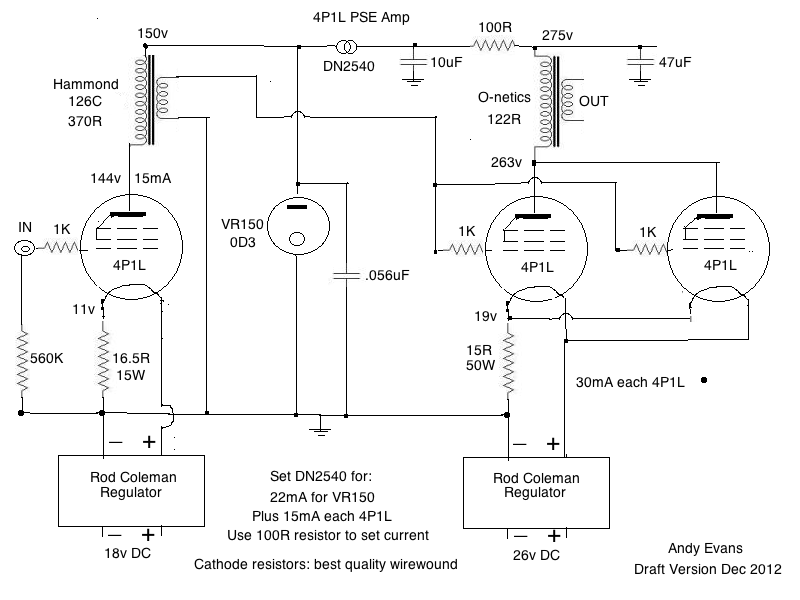

Here's another recommendation for a 4P1L PSE amp. The parts are very cheap - just get a dozen 4P1L to start with. They are very reliable and measure quite close together. Add your Edcor OPT and a Hammond 126C, which isn't expensive, and you have an amplifier which is as good as or better than 300b SETs. It is all in filament bias, as you will see from the schematic. What this means is a separate DC supply for each tube, so a few small cheap filament transformers. It's best to use Rod Coleman's regulators but you can also use LM1085s in current mode. Very cheap and does the job - you need to heatsink them, though. So the filaments need more attention. But the results are great - no coupling capacitors and no cathode bypass capacitors. Very pure sound.
