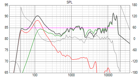

it honestly looks pretty alright how it is. this is not for an audiophile. my ears get used to a speakers sound signiture and it never bothers me much. my main goal is to get it below 40hz. i know im making a lot of compromises for that. it wont ever need to be loud. 75db would be plenty of max volume i think. my parts are already ordered and a big part of this will be taking pride in my own design.
The lump is the bass drivers output rising as you come away from the bass port frequency. I can't think of an easy way to level it out much but I will take a look.
Poly fill will damp the port response hence the very low frequency lump would most likely flatten out a bit as the port Q would be reduced. Probably won't affect the second peak much it might even make it slightly worse as poly fill reduces the speed of sound in the box hence the walls look like they are further away (it take longer to reach them) and hence it makes the box look bigger.

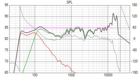

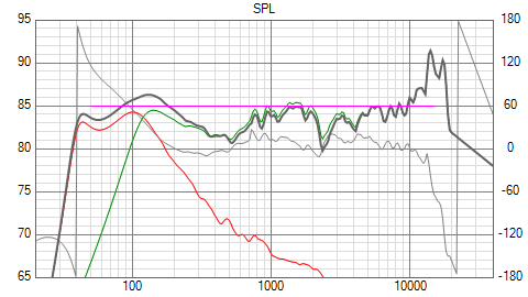

The resistor wants to go after the inductor next to the speaker as shown as it forms a bit of an LR filter with the inductor as well as adjusting Q. It performs much more effectively in this location.
Plots below 12mH no resistor and 12mH 15R after inductor and 10R after inductor. The 10R version shows the impedance dropping to 3.5R at low frequencies so will place quite a load on the amplifier if you play it loud.

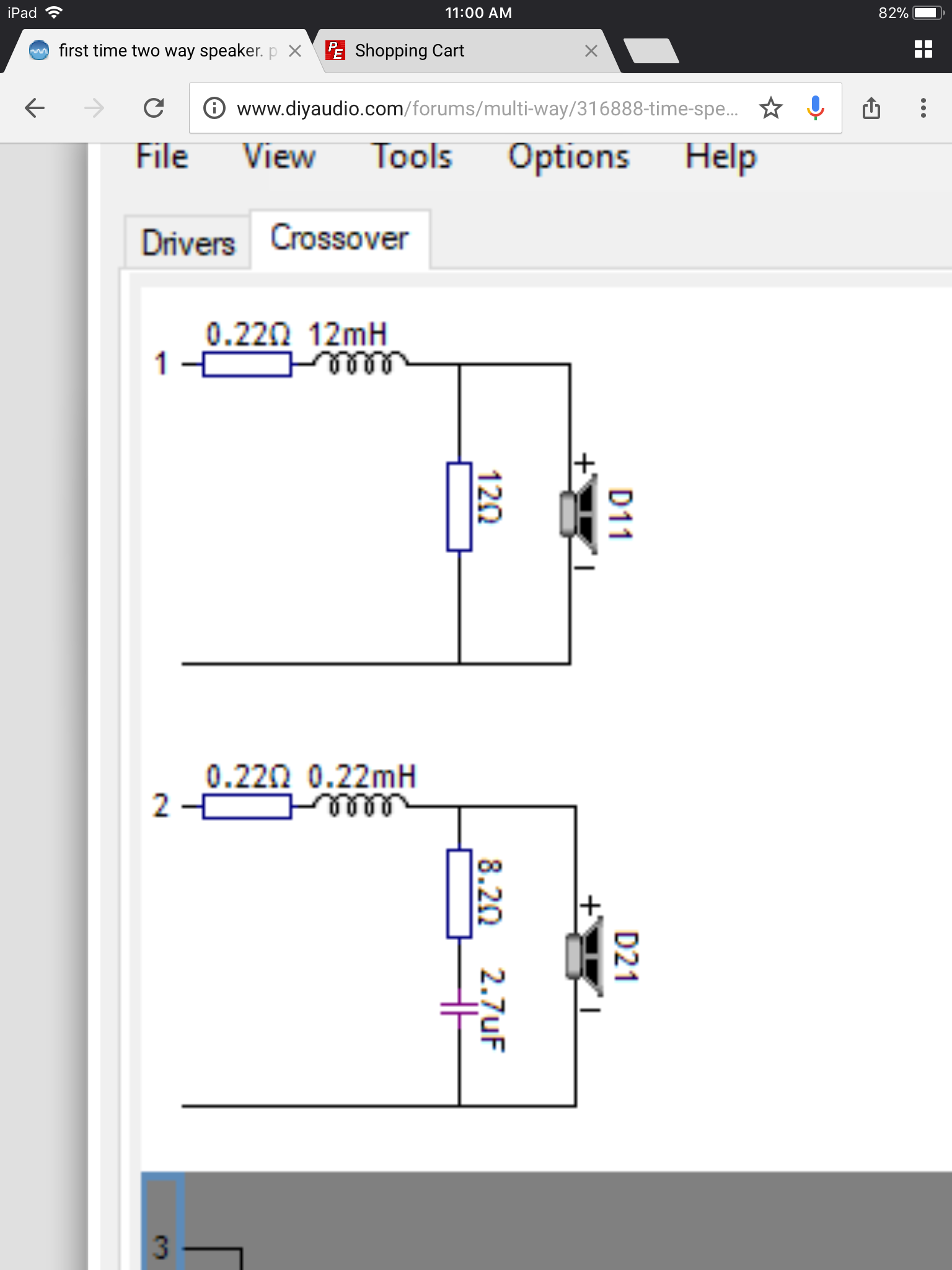

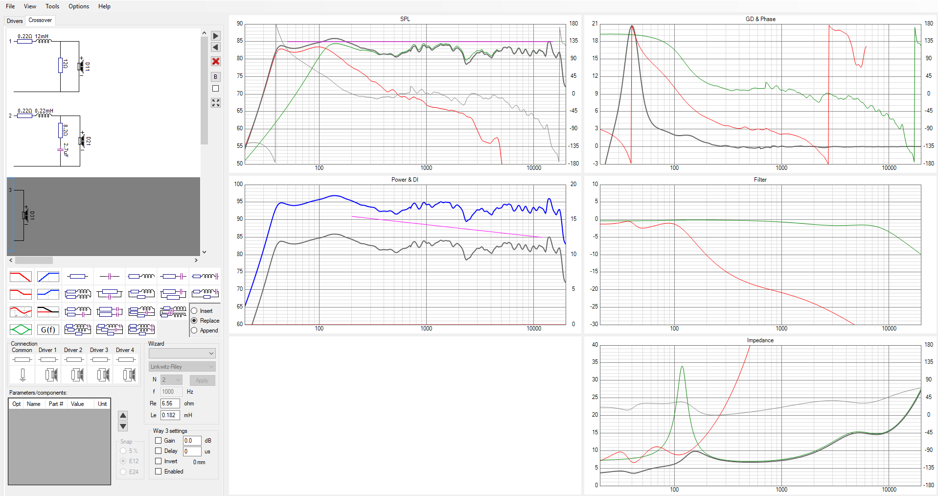

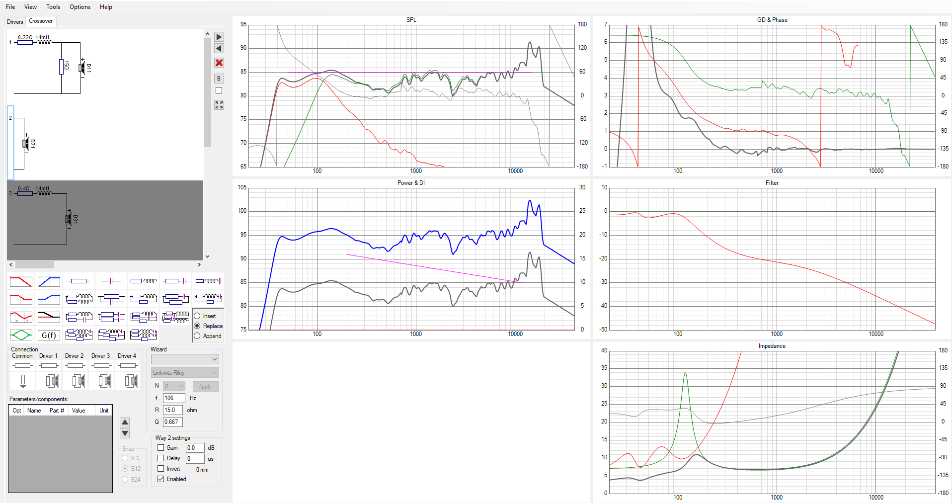

However if you find the top end is a bit harsh, which some full ranges can sound, you could tame it with a hi frequency filter. This will cost a bit more in parts as you will need a L C R solution. The L wants to be air cored and of fairly low resistance (I have simulated 0.22R but you could get away with a bit higher). The C should ideally be polypropylene but a cheap electrolytic would let you know if the approach was going to work (they can add a bit of distortion and change over time as they dry out but that is many years)
I have shown one below you can see how it reduces the peak at the top end and lowers the mid range, this will give you more apparent bass signal.
You can also see how bass resistor reduces the impedance at low frequency (bottom left) I have put a 12R in this circuit to provide another example.
are these the components i would need for that last simulation you posted? if so ill probably do that. seems silly to go to all this work and not spend a few extra bucks. also, this is the amp i got for the project. suitable?

Yes, those are the components used in the sim.
