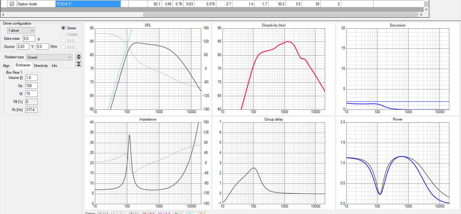

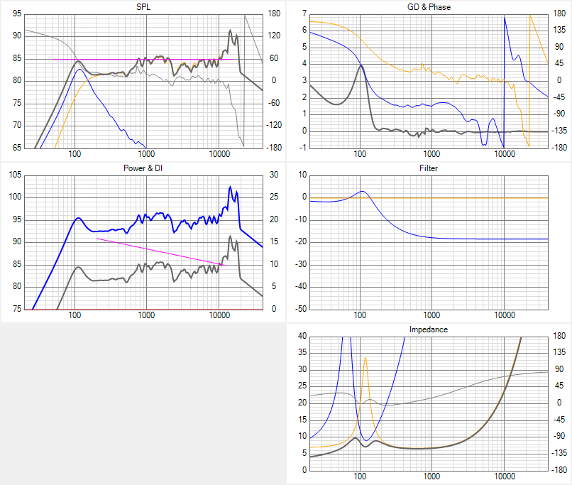

As I had some spare time and it looked like an interesting challenge. I had a go at a simulation of your current proposal. It was not easy as you are using acoustic roll off for half the crossover but I think I have got something fairly close.
The two bass drivers are in an enclosure that is 12.7L size (This is far too small for a no peaking response) I don't understand your comment it will be tuned to 35Hz as in this enclosure the bass is no where near 35Hz. Any enclosure will push Fs up and you started at higher then 35Hz.

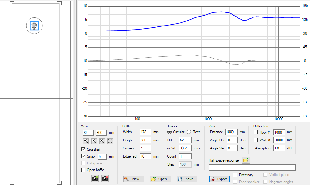

The full range is in a 1.7L enclosure, I have added baffle simulation to it to simulate the half space to full space level loss. Keep in mind if this is near a wall you will get a lot of it back again (a little later) from the reflection.
The 14mH inductor seems to do and OK job of integrating the two but I would think that this design will lack deep bass as boom at bit at the peak. If I have misunderstood something then let me know and I will try to correct it.

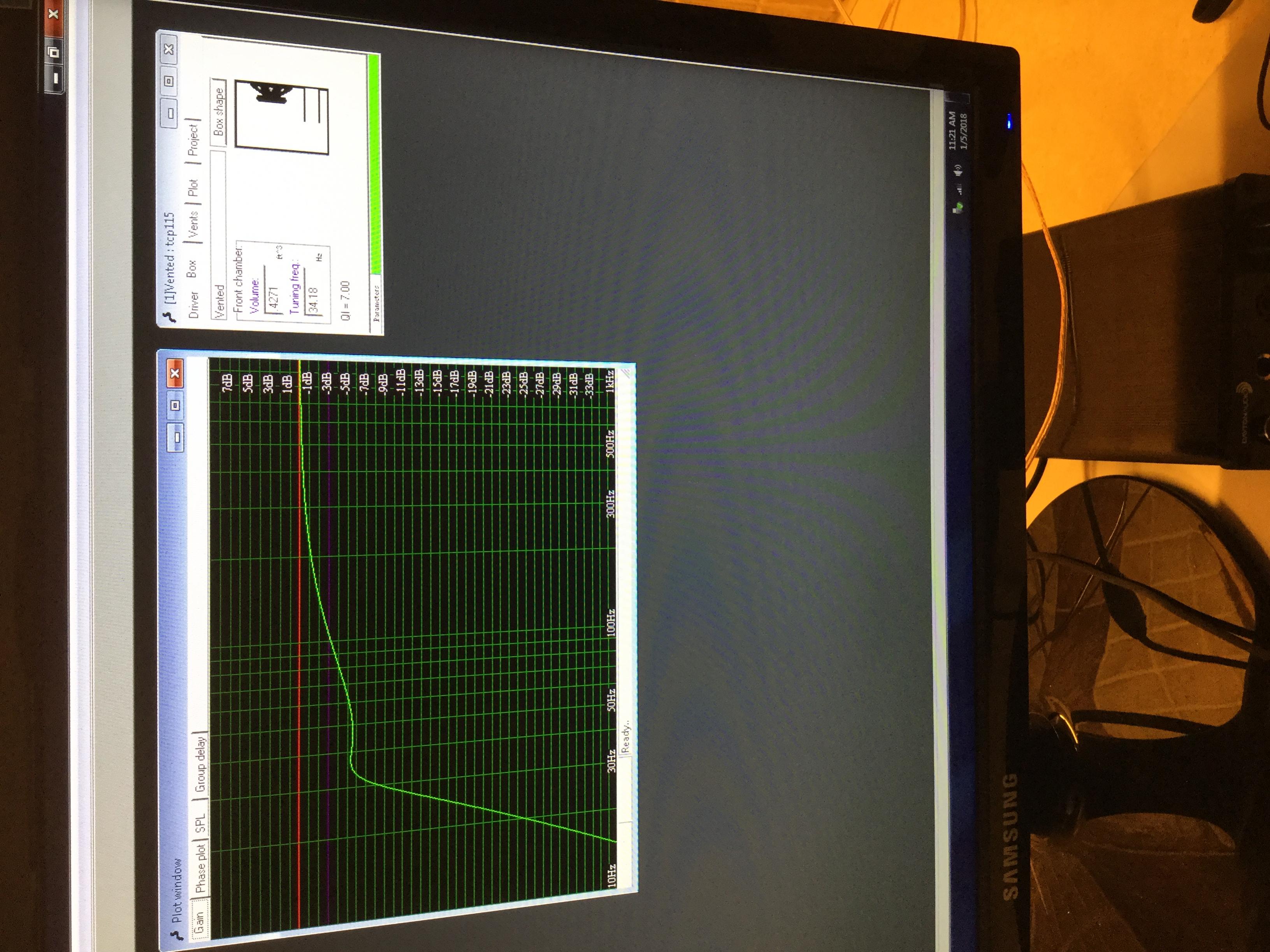

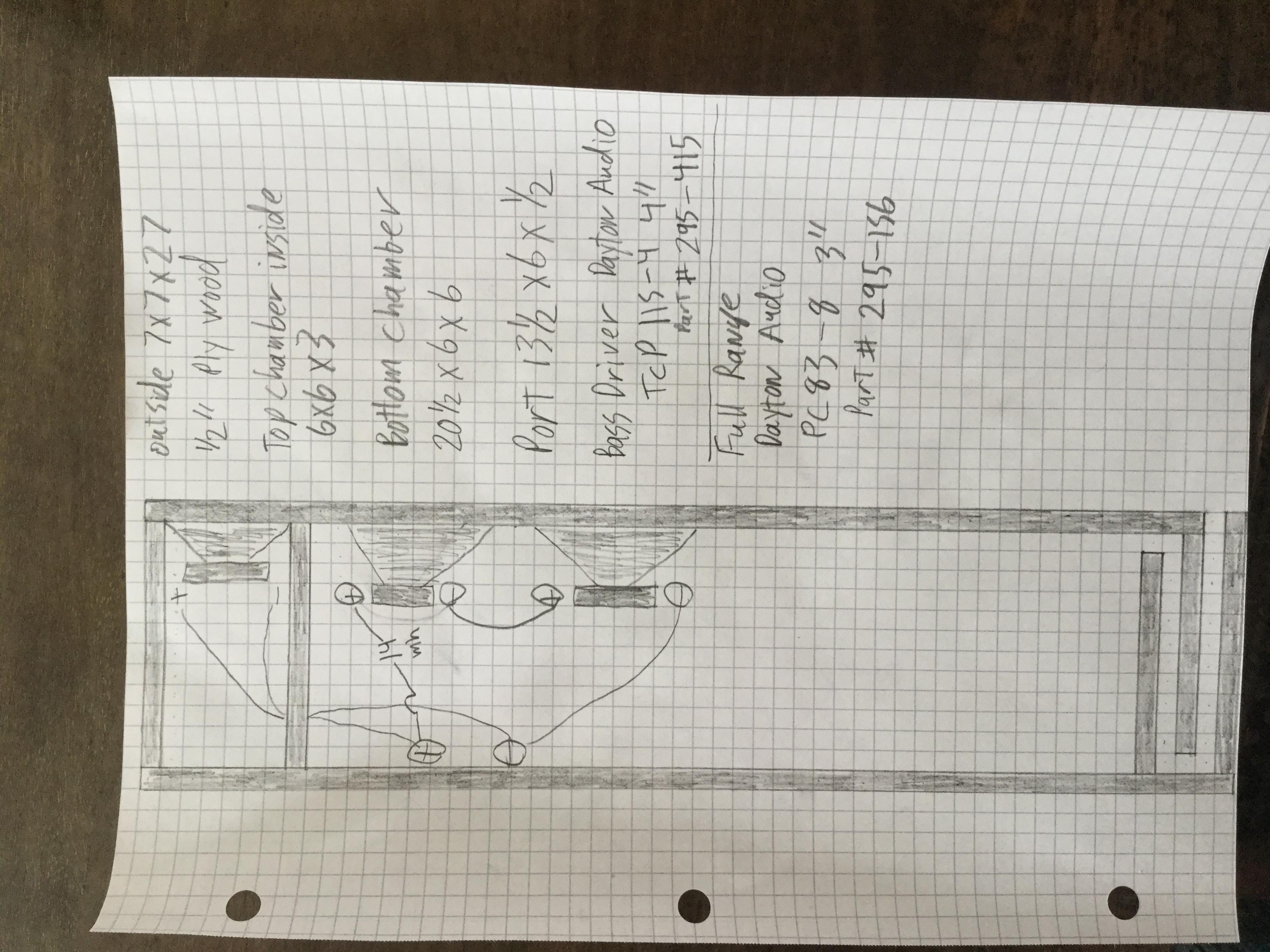

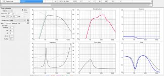

this is just a quick thank you for doing this for me. later today ill show you what winisd was telling me, only tool ive got for this sort of thing. ill draw up the side view on some graph paper too.

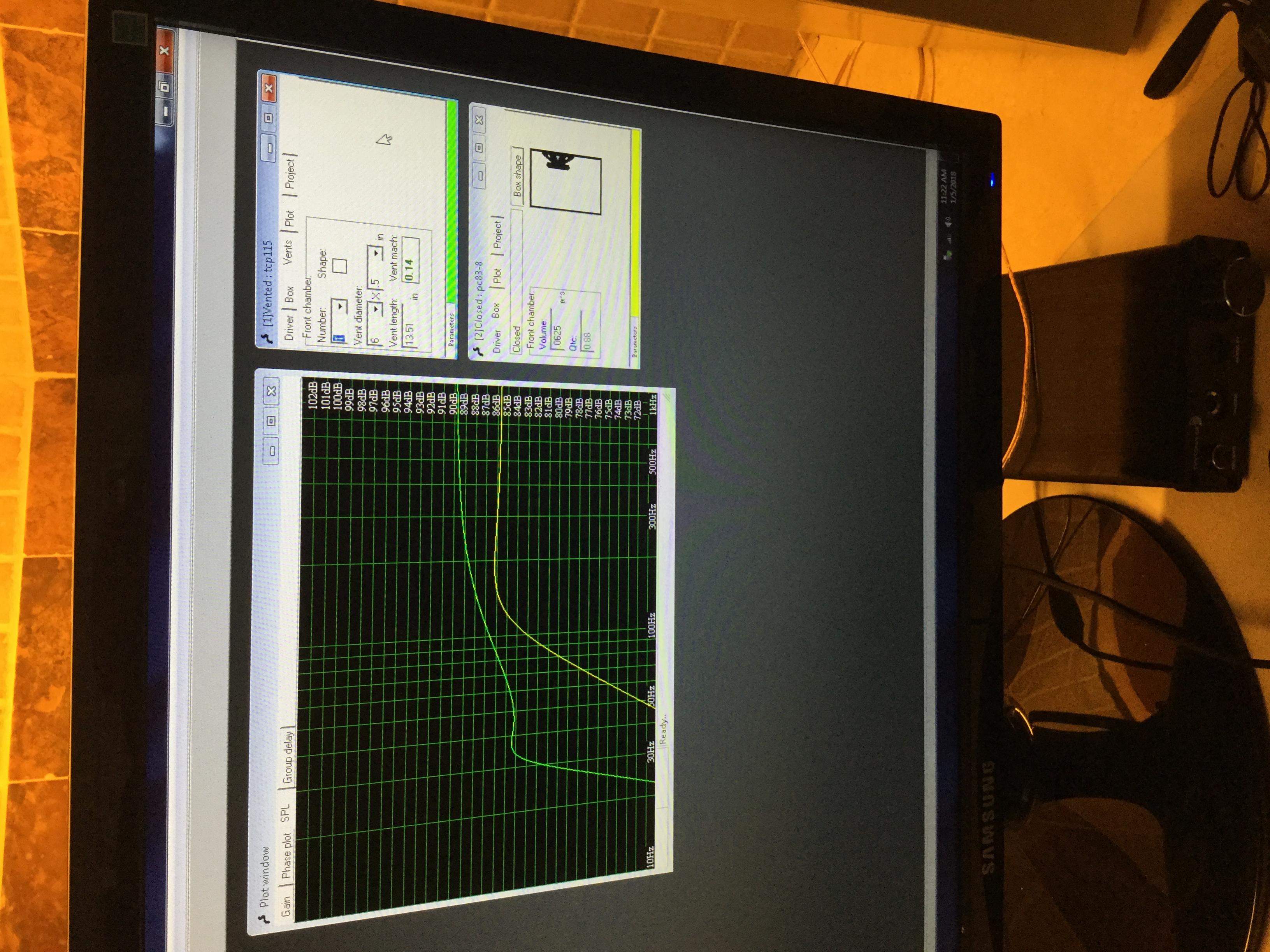

so the 3rd grader level drawing each block is a half inch. one image of winisd is just the two bass drivers showing box volume and tuning. the other winisd pic is the spl of all the drivers together and showing the port mach of the bass drivers.
Ok what I hadnt appreciated was that you intended to use a ported enclosure. I can rework it for that now I have the info.

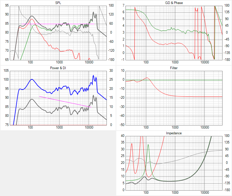

I have now simulated your extended bass shelf bass solution. and combined it with the full range with the 1.7L enclosure. I have not added baffle diffraction and loss to this but it would raise the 1K region and reduce the low frequency.
As you can see this is going to give you a lumpy bass response.
