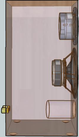

Matt,
If you're going to use the Pioneers, you could do worse than putting them in a 6 litre (I'm only good with metric) enclosure, with a single 5cm (or 2-inch) diameter port that is 12.5cm (5 inches) long.
The 6 litres is internal volume and does not include the driver volume (if you're using half-inch thick wood, that would be about 0.2litres) or port volume (about 0.35 litres).
If you make it with half inch boards, that makes the external dimensions 14 x 20.5 x 32.5cm (or 5.5 x 8 x 13 inches) - give or take. Port should be 2-inch plumbers pipe.
Should look something like the attached (lousy drawing - I know). Once you've built it, listen. There will be things you may not like, and things you do. Then it'll be time for your second attempt (there is always a second attempt). You may even use the same driver(s), just want to change the box a little (or a lot).
OK Jon; what did you use to sketch that box,?? I usually use ( or abuse ) a texta on old butchers paper.

Moondog55 said:what did you use to sketch that box,??
I'm sure he used Google SketchUp (free version available)
