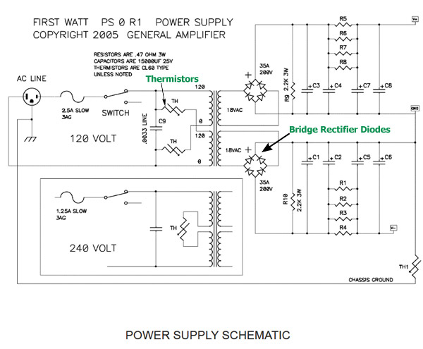

Okay guys I'm sorry in advance because I'm sure this has been addressed before but I'm completely out of my depth and having trouble finding a step by step guide to building the PSU. I found the transformers but I am unsure which capacitators to use for a regular F5 build. Which brand, type, voltage, mF, etc.
Thank you, I can't wait to hear this thing!
The rectifiers are what turns the AC into DC and the soft start is the thermistor wired into the power input leads.
So these are necessary to build a functioning amplifier? Or just nice bits to have. Also I'm taking a look at parts for the PSU and once again I'm a little confused. I read that the T0-247 are the way to go for resistors, but i checked out mouser electronics and I have no idea what the correct resistance is. Does it matter? Is this something I should be able to figure out myself?

A TO-247 packaged resistor is usually a very high wattage one (say 50 to 100W).
You don't need anything like that in building an F5. For the power resistors,
the Panasonic 3W ones are a popular choice. For the smaller ones, standard
1/4 to 1/2 watt through hole 1% metal film resistors will be fine.

T0-247 is the case shape of the resistor....has nothing to do with the resistance value. And yes, the resistance value is important. And they are, for you, probably not the way to go (expensive, they won't fit the boards in places and they are way overrated for wattage in most positions). Stick to the guide and BOM.
And yes, some of this stuff you should be able to figure out on your own before you build the amplifier. Otherwise, it's going to be very frustrating. But you will get there. Keep studying. Don't work on anything involving voltage from the wall (mains voltage) until you understand what you are doing. For safety's sake.
Okay, this is actually starting to make sense to me. All of your guidance has been indispensable. So just to be clear. I'm looking for 3w Panasonic 2.2k Ohm resistors? Sorry for the redundancy but this is my first time building any sort of electronic and as Hikari1 says, Safety First :) Also does the resistance matter on the capacitors?
On the power supply board, each large resistor is 0.47 ohms, 3 watts.
The capacitors are rated for voltage and capacitance, not resistance.
The spec is 15000uF and 25V, but you are much better off with a higher
voltage rating, at least 35V.
