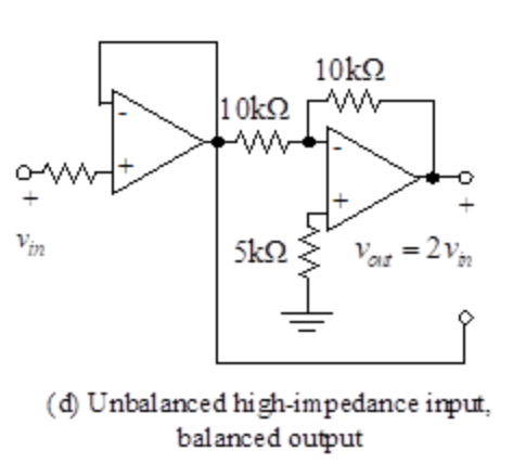

The purpose of a balanced line driver is:
As said: To drive two lines in a balanced way: That is, same voltages, same outputs impedance.
That said, in audio the usual solution is:
From the asymetrical output stage that is typically an opamp output with 47 ohm outputing out+.
Add an opamp to invert the signal to make out-.
That is: Half a NE5532, two 10k resistors, a 47 ohm resitor to provide out-.
With some 22pf across the feedback 10k and most important: a 0,1uF ceramique cap across V+ V-.
Of course, it doesn’t look symetrical inside, but who will know but you, what matters is symetry outside.
An XLR socket with out+ and out- at pin 2 and pin 3 with chassis at pin 1.

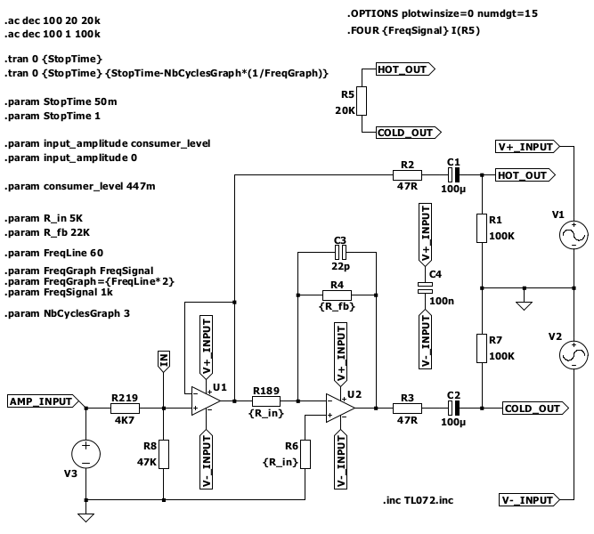

Thank you for your reply. Yes I have seen this trick while researching the subject, but this is dependent on the source impedence which in my case can vary. For example my first use case is a phono preamp which has discrete push-pull emitter follower output.
I've come up with a discrete version that sort of work but it would be dependent on transistors and resistors matching and distortion is high-ish. The dedicated balanced driver ICs offer the best performance but are high priced.
So I'd go with the dual op-amp implementation like mentionned in post #15, a voltage follower buffer feeding into a 6dB inverting gain stage for the complement. This would be independent of source impedance. The 22pF and 100nF capacitors will be added to the basic circuit below. 0.1% low tempco resistors might be needed.
Thank you for your advice. There is already a coupling capacitor at the output of my phono preamp but I will add it to the line driver circuit as an option for other use cases.

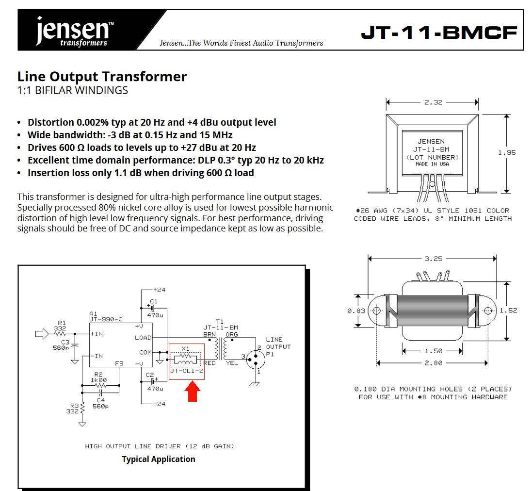

I would use the output caps for sure. Disliking electrolytics is not a valid reason to remove them. All this messing around to produce a balanced output and you end up with a small DC residual? Not in my gear. If it makes you feel better, use a film cap, and do the math on the appropriate value to use. No one says the 100k resistor is the 'right' value either. Even 1M could work, which helps the capacitor sizing.
Those Jensen JT-11 output transformers are the best solution. Superior CMRR than anything you will build, and robust/bulletproof as you can get. No need to worry about compensation, gain margin, stability.
Most importantly, they could care less what type of equipment you are feeding into - perhaps it does not have a DC blocker. No problem with a transformer.

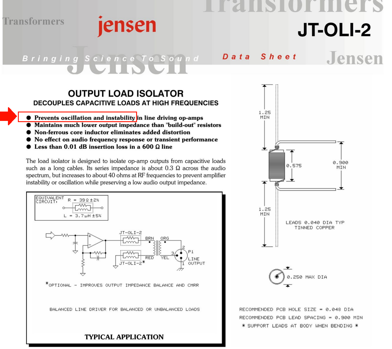

Jensen Transformers worries about stability of JT-11 circuits so much, that they manufacture and sell a transformer compensator product called JT-OLI-2 which "prevents oscillation and instability". The very first figure in the JT-11 datasheet calls for a JT-OLI-2 in series with the JT-11.
Isn't that simply a kind of snubber? I wonder if one could just use its equivalent circuit as a discrete 3.7uH miniature RF inductor and 39R resistor in parallel for the same effect.
If so I would put it as an optional path on this project's pcb to allow usage of a transformer instead of the big output 'lytics. This would provide yet another avenue to try out.
_
Don't blame the transformer, blame the op amp.
Still the optimal solution for all the challenges at hand.
Reactions: benb
Yes.
Transformers work best (lowest LF distortion) when driven with zero ohms source impedance but this is at odds with the capacitive load intolerance of pretty much any opamp (except some very special types) and also discrete amplifier circuits.
The L//R breakout is a simple and well-working solution.
