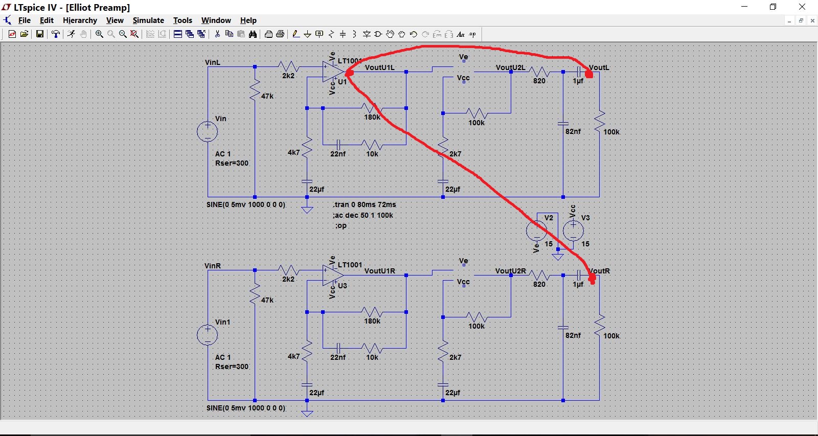

Lets try and get some output from the faulty channel by cross connecting the opamps.
Which 'side' of the opamp is left and which is right ? I'm assuming pins 1,2 and 3 are 'left', the good side.
So with U2 still removed, connect pin 1 of U1 to pins 1 and 7 of U2. That will feed the known good output into both channels. You should get identical audio from both channels.
If that is OK then we look next at the faulty side of U1. Its very difficult without actually seeing it all and without using test equipment such as a signal generator and scope.
However... U1. Can you measure and record the exact DC voltages you are seeing on pins 1,2,3 and pins 5,6 and 7. Do this with no music playing, The voltages will be very small, in the millivolt region, but lets compare them one channel to the other.

Have the circuit in front of you and try and follow the logic 🙂
With both opamps fitted, all the pins apart from the power supply should be at zero.
Here's your circuit:
Now we remove U2 and feed the known good output into both pins 1 and 7 of where U2 was.
This should give identical output from both channels proving that from U2 output pins to the outside world is OK. The green trace is perfectly overlaid by the blue which is why its not visible.

This is sounding more and more like you have more than one problem, and that these problems could be physical issues rather than component problems.
Lets work with this:
That proves beyond doubt that you have a definite problem with the signal path from the right hand output socket to U2. There has to be a break between these two arrowed points. Now you may have other problems as well, but this one is definite.
(You say you have proved (earlier post) that the leads and amplifier are OK by you swapping leads around)
So connect a bit of wire to either pin 1 or pin 7 (doesn't matter which because both are linked) and dab that wire on to the output socket. You must get audio doing that. Then move the wire back along the signal path dabbing it on the cap and series resistor.

1) Yes, its still set up as before (when you had this).
2) There may well be other problems with the amp, but still having no right hand output when its connected as above proves beyond doubt there is a problem with the feed from U2 output to the outside world.

U2 could well be OK but we need to work back to prove it all.
Work with what we know to be definite issues 🙂 You've got sound from both outputs now, so we know there must be either a problem with the continuity from the socket back to U2, or that there is a short somewhere on those components that's killing the audio.
Fix that one issue first. You need sound from both outputs when U2 is removed, and when pins 1 and 7 are linked and connected back to U1 (just as you have it now)

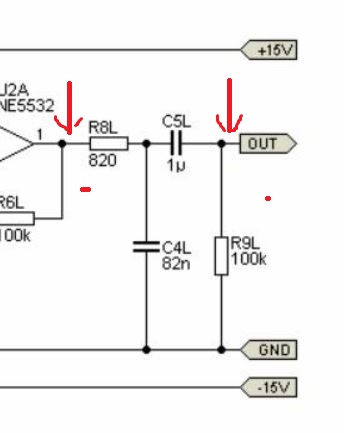

Going back to what I said earlier, when you connect the output of U2 (which is still removed and pins 1 and 7 linked) to the output sockets you should have identical audio on both channels. If it is not then there has to be yet another issue but this time external to the preamp.
Just think about the logic of that. We are feeding the same signal (coming from the same point on the board) to the left and right sockets directly. So the audio you hear has to be the same on both channels.
Now... if you mean it is 3-6 db different with the 820 ohm and 1uf coupling cap in place, and that the audio is now passing through those (so not directly linked with a piece of wire from the sockets to U2) then there has to be a simple problem with either the connections of those parts or the value of them... such as the 820 ohm being something else on one channel.
I'll have more time tomorrow if you are stuck 🙂 but try and look at the circuit and apply logic to what we are doing. We are attempting to prove/disprove faults by linking out complete sections at a time and feeding the same signal to left and right.
Ok, with U2 removed and the wire links (U1pin1 to U2pin1+7):
I am definitely getting ~2dB difference between L+R channels. Under normal stereo conditions this would make sense.. but here we are sending the 'L' channel to both L+R output correct? So you're saying they should be identical - but they're not, hmm.. I can't seem to understand how that could be happening.
With this same setup, if I take a wire from U2pin1 (or 7, they are linked), and tap the R channel output socket, the R channel output jumps to ~3dB higher than the L.

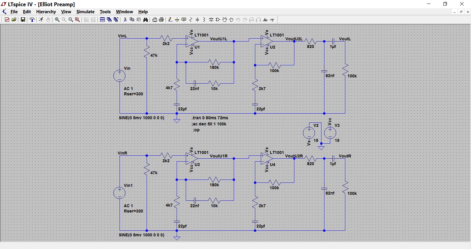

So... to recap.

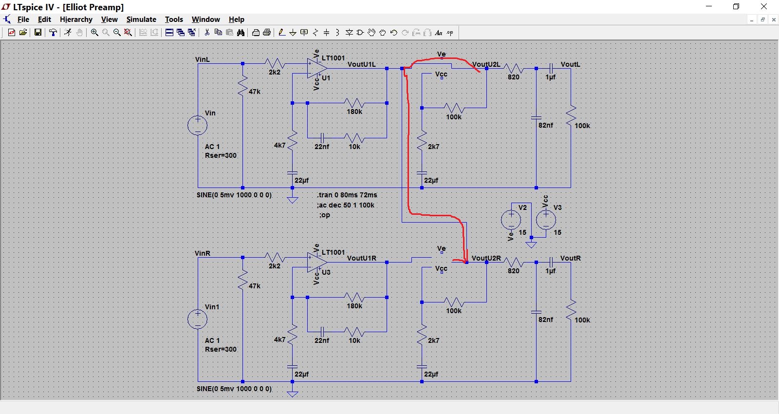

Here is your preamp. With U2 removed and with wire links as shown you should be getting equal volume from both channels.
If you have it connected as per the middle diagram (which means feeding to the 'socket side' of the 1uf, exactly as drawn) then you have to have identical output from both sides.
As proof that you have wired it correctly for this test, you should be able to measure a dead short (0.00 on DVM on low resistance range) between the centre pin of left and right output terminals.
If you still hear a difference in level then the cause for that must be external to the preamp.
Does that make sense ? If your not sure or don't agree then say so 🙂

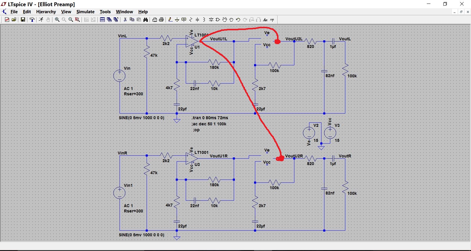

I believe I had it connected as shown in your last diagram... that would be with U1pin1 to U2pin1+7 correct?
If I'm understanding correctly, the middle diagram is showing U1pin1 going straight to the L and R socket? That I have not tried yet, but.. I can't possibly see how that would NOT result in identical outputs on L+R !
Connected as the in the last diagram could give non identical output on each channel if there were a difference (such as a construction error or wrong value part) in the components to the right of the connection point. That's what we need to prove.
Connected as per the middle diagram has to give equal output on both channels. That proves that your listening setup is giving equal loudness to both channels... it has to in that configuration.

Ok, now I'm really confounded..
I set up as shown in middle diagram: no U2, U1pin1 going to both L+R sockets.
With this setup I'm still getting ~2-3dB higher on the L channel.
I ensured that the preamp gain levels on my interface are identical for L+R, so I really can't see what else could be causing the difference.
There has to be the same signal at the sockets when wired as per the middle diagram.
Do a check. If you unplug the leads from the preamp to your main amplifier at the main amplifier end then you should be able to measure continuity (a dead short) between the centre pins of the two leads (L&R)
