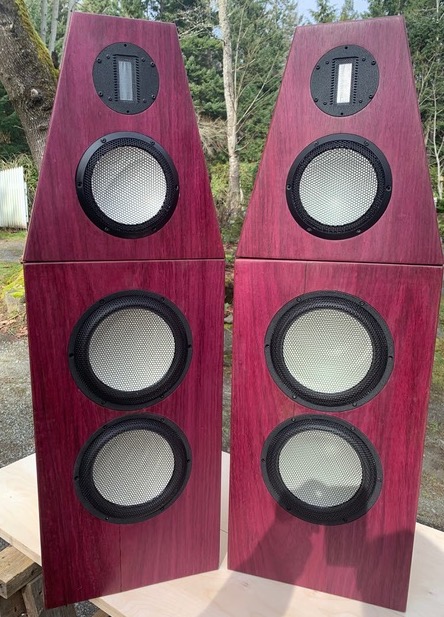

He asked me for a DFX file which I created with only the dimensions of the speaker. The bracing I only showed him examples of what I wanted. The drivers he took all the dimensions from the spec sheets. He then sent me a Fusion360 file to review. It allowed me to view all the measurements. He may have been able to feed the fusion360 file into the CNC machine but I am not sure. I do know he is using CaMaster Stinger CNC machine. The person website is Corona Arts. I was impressed with the variety of work he had done and some of it was quite intricate.

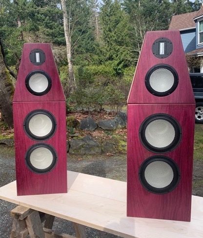

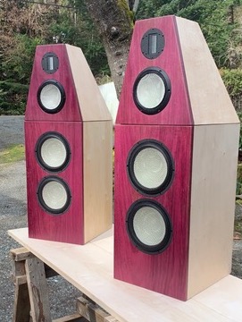

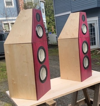

Cabinets and drivers Installed
Installed drivers with temporary screws today in cabinets until Hex screws and platform and feet are delivered. Will start testing crossover settings tomorrow
Nice Job. I like the front baffle colour.
I like the baffle colour and over time it will darken which I am ok with. To have wood that is naturally purple amazed me and it is an extremely hard wood so it also added to the strength of the baffle.
Very nice !
I like the looks.
For the moment I'm experimenting with basotect for cabinet damping, great stuff !
All dampening was wool felt. I used approx 2.5” on all the walls and 5” below the bottom woofer.

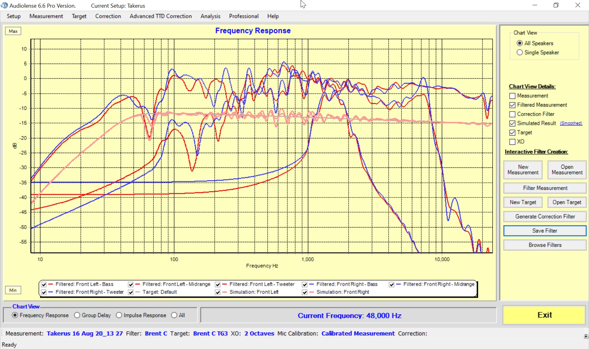

Until I have time to measure them crossovers are 4th order linkwitz riley at 250 and 3000. I will be travelling a fair bit over the next month but will post measurements when I am done. I am extremely happy with the accuton DSP but contemplating trying a Deqx. Deqx makes sense to me as it can replace my preamp and right now I am going from digital to analogue to digital to analogue and seems a bit crazy to me.

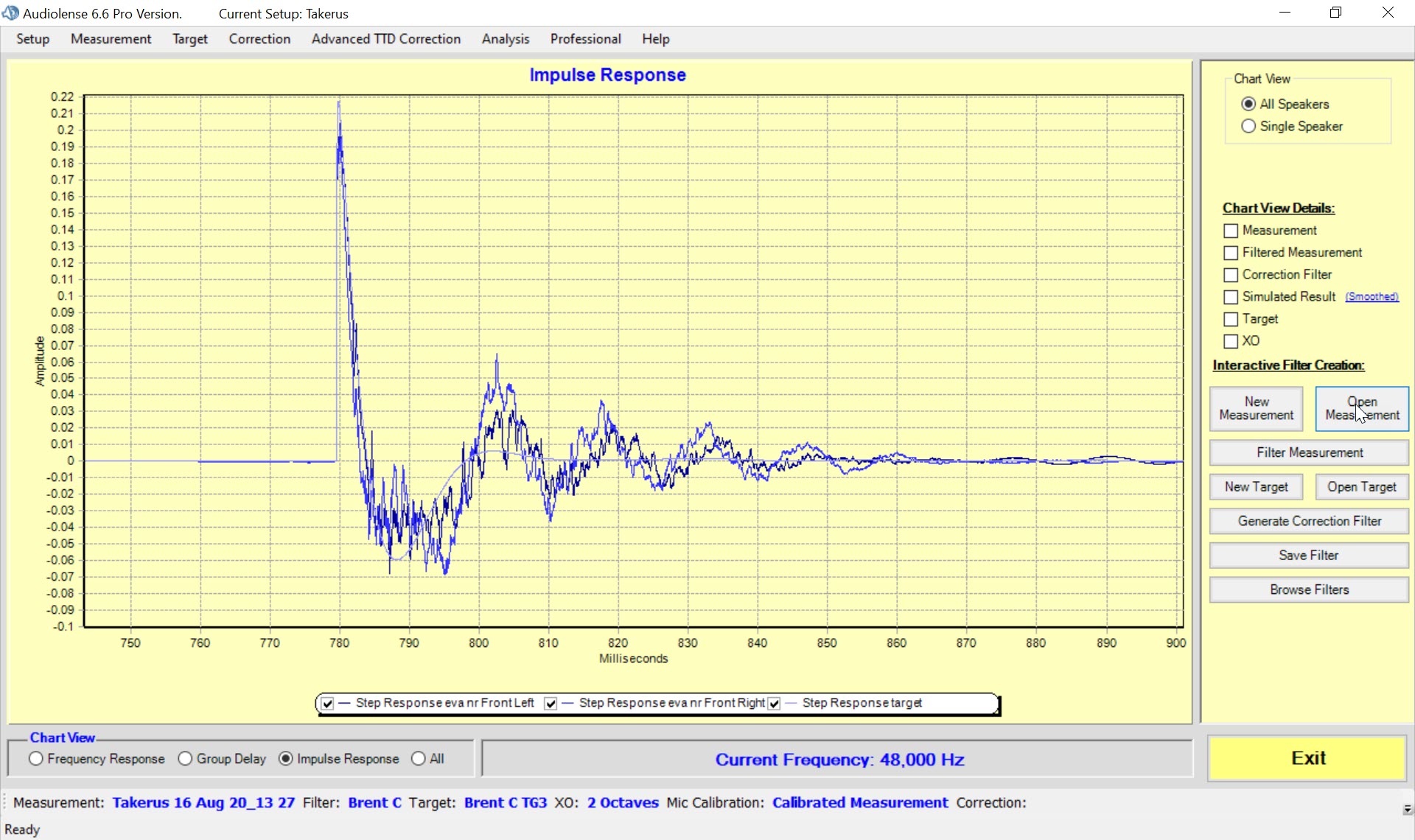

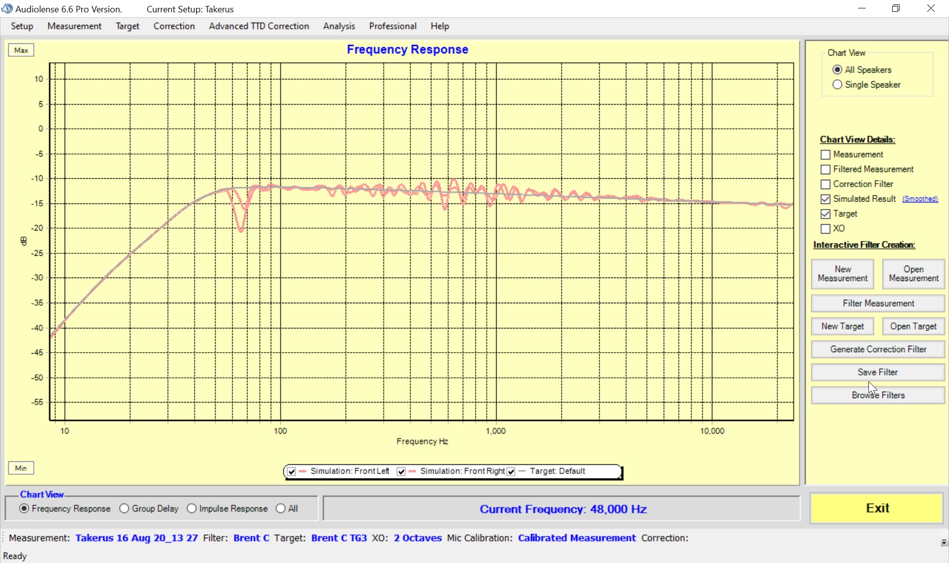

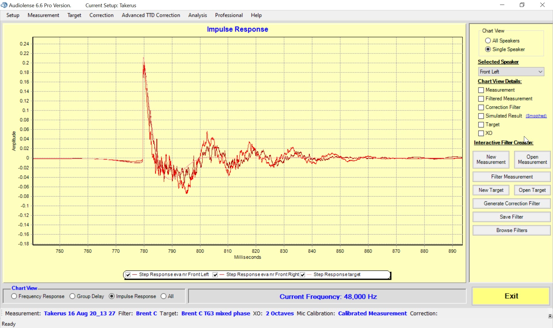

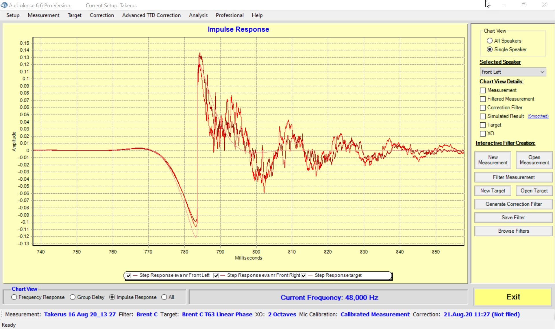

Mitch Barnett from Accurate Sound who completed the FIR filter crossovers utilizing Audiolense Software. Mitch brought out the best that my design could ever be. Mitch did 3 sets of filters for my speakers and I have include the Before and targeted frequency response and the Simulated filtered responses with the step responses for Minimum Phase, Linear Phase and Mixed Phase. For anyone who have never tried FIR filters I highly recommend them as I had made my own DSP crossover using Accuton Modules which did not even come close to the sound I now have with the Audiolense Filters designed by Mitch.
