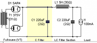

Well, its finally finished. The project got back-burnered for a while when I was getting settled into the new job and new city, but I finally got the amp finished and sitting on my desk. Here are some pictures so you can see how it turned out.

@soonerorlater No, I'm just using this as a mono amp right now with the left and right channels bridged into one. I only use it to play music at my desk, so the mono sound is just fine for me. I've started gearing up for a stereo project with phonograph input that I intend to use in my house. I'm still trying to decide on a schematic, but I know I want at least 50 Watts per channel.
@Bas -- The two switches are so I can turn on the heater fillaments separate from the high voltage circuits. I did this so that I can bring the high voltage online after the tubes had already warmed up instead of at the same time. Additionally if I am only going to be turning the amp off for an hour or less I like to leave the heaters on to reduce thermal cycling. It was my thought that the above two measures would increase the lifespan of my tubes.

Ofcourse. I thought the tube rectifier would take care of that but you are using a 5Y3. Which is direct heated and warms up quite fast.The two switches are so I can turn on the heater fillaments separate
I am using a pre-made vu driver board. You just hook up all the connections then tweak it a little with some resistors to get the scale to work right with the amp. It was pretty easy to do, and less time consuming than coming up with my own circuit.
