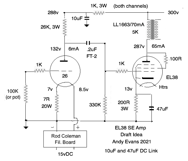

First time amplifier design help, critique, and suggestions
Spent this last weekend learning some ltspice. This tool is incredible! There's so much functionality packed into here. Here's some observations I found:
1. I have a working updated schematic with the gyrator load on the input tube. I used the 6SN7 as a placeholder because I don't have models for 6J5 or EL33. I used a triode connected KT88 as the output tube for now. For all the mosfets in the gyrator, I'm at the mercy of the models I found online. I don't know how accurate they are. Interestingly, I have higher distortion figures using the gyrator vs using a simple resistor load. But there's a chance I didn't do everything quite right or the models aren't perfect.

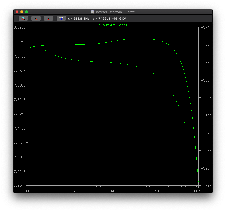

2. I generated a bode plot from the secondary of the output transformer, and I'm not really sure how to interpret it. It doesn't look like a normal frequency response graph. Am I measuring in the correct place?
3. I ramped up the voltage on the input to 3V (6V peak-to-peak) just to see what happens. I saw that the output voltage was cut off on one end of the sine wave. I realized that this is clipping! I was able to play around with output tube bias points and see the effects on how much output voltage I can achieve before clipping. I feel like I'm learning so much by playing around with ltspice. It's pretty fun.
Here are some figures from playing around with it:
2V peak-to-peak: 2.4% distortion and 10.5V P2P output
RMS output = 10.5/(sqrt(2)) = 7.42V RMS
Watts into 32 ohm headphones: (7.42^2)/32 = 1.7W
0.16V peak-to-peak input: 0.16% distortion and 0.81V P2P output
RMS output = 0.81/(sqrt(2)) = 0.57V RMS
Watts into 32 ohm headphones: (0.57^2)/32 = 10mW. Considering most headphones are 90-100db/1mW, that's still overkill for power. But distortion is very low at this level.
I don't have models for some of the tubes I'm interested in (26, EL33, EL38), but results so far with the models I have look promising!

I would look up the capacitor ESR for the frequency you’re using (or pick a rough average). Also add series resistance for the voltage sources.
Ensure your inductors/transformer resistances are also set up.
“Startup” on the trans line helps initial start modelling - look for grids going positive and blanked getting too much current.
You can model the AC power transformer too. Then you’ll start seei. Him, noise and inrush current.
For FFTs used a filter - YT (I can’t remember the name but it’s part way down the list) and set the filter parameter to 20.
Phase shows two lines (there are some hidden options but ignore initially). The solid is the freq response and the dotted is phase.
It shows the trace of where you click. Click on the wire for voltage between the output trans and the 32ohm headphone.
Phase is important for feedback designs and ensuring that you don’t get a phase becoming self reinforcing causing oscillation etc.
The freq response is good as it shows the impact of the resistors and Miller effect and caps - essentially all the low and high pass filtering that appears as part of the signal line that you simply inherit.
There are lots of limitations but it is good to get a rough ball park figure. What ltspice doesn’t do is model some behaviour such as resistor type response with frequency things like the construction of spiral metal foil acting as an inductor outside of the audio freq.
What is nice is that it pushes you to learn more.
I take it you know about the power (button+click) - for the Mac it’s function+click. Also the shift+click on the trance name for integration (gives average and RMS) lastly the double click on the trace gives measurement two lines that follow the trace results so you can measure more precisely.
There’s a thread in LTSpice in the software tools sub forum.
Check out the tube model sticky (forum search).
Also put in resistances for the output trans - otherwise the modelling will be out of kilter.
You can also mode cross talk by replicating the section and connecting to the power supply rails - use a different input freq on each channel and you’ll see if you have cross talk.
Lastly when you build the resistances will need tweaking so you may want to look at a variable resistor (have a normal resistor too too prevent open track causing a problem). This helps you tube for the individual valve section.
