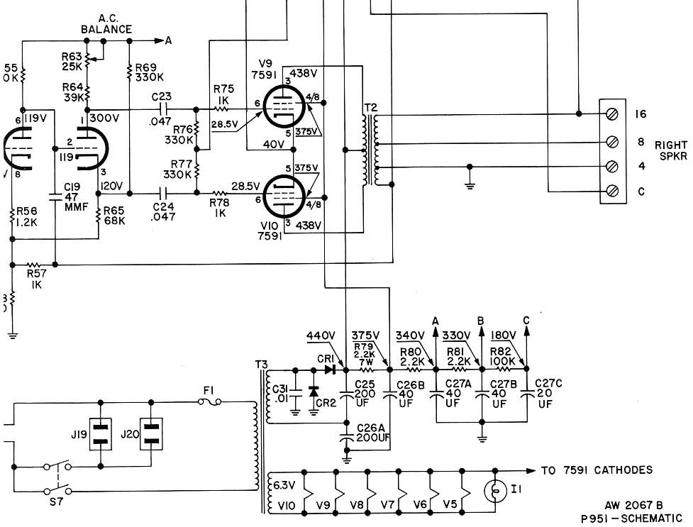

7591A-P
I got to digging in my garage and found four 7591A-P tubes. Can someone direct me to a sample amplifier circuit that uses these tubes. Simple circuit I hope.
Re: 7591A-P
Lots of stuff like old Scotts and Fishers used the 7591. It's a 6L6-ish tube and with some minor changes in some circuits, both could be used. Check the datasheet and this page for 7591 - 6L6 conversion info.Jason Watts said:I got to digging in my garage and found four 7591A-P tubes. Can someone direct me to a sample amplifier circuit that uses these tubes. Simple circuit I hope.
Here's a Fisher X101C schematic. Everything's there except the grid resistor for the first 12AX7 (not critical but 100k or so would do). Lines going off the page are just links to the other channel.
OPT is 6k6 a-a. I'd do a fullwave rectifier myself and ditch the doubler, but that's just my preference.
Not a bad sounding little amp.

Jason Watts said:7591A-P
Fisher 500C
http://www.fortunecity.com/tinpan/beegee/290/page4.html
dave
