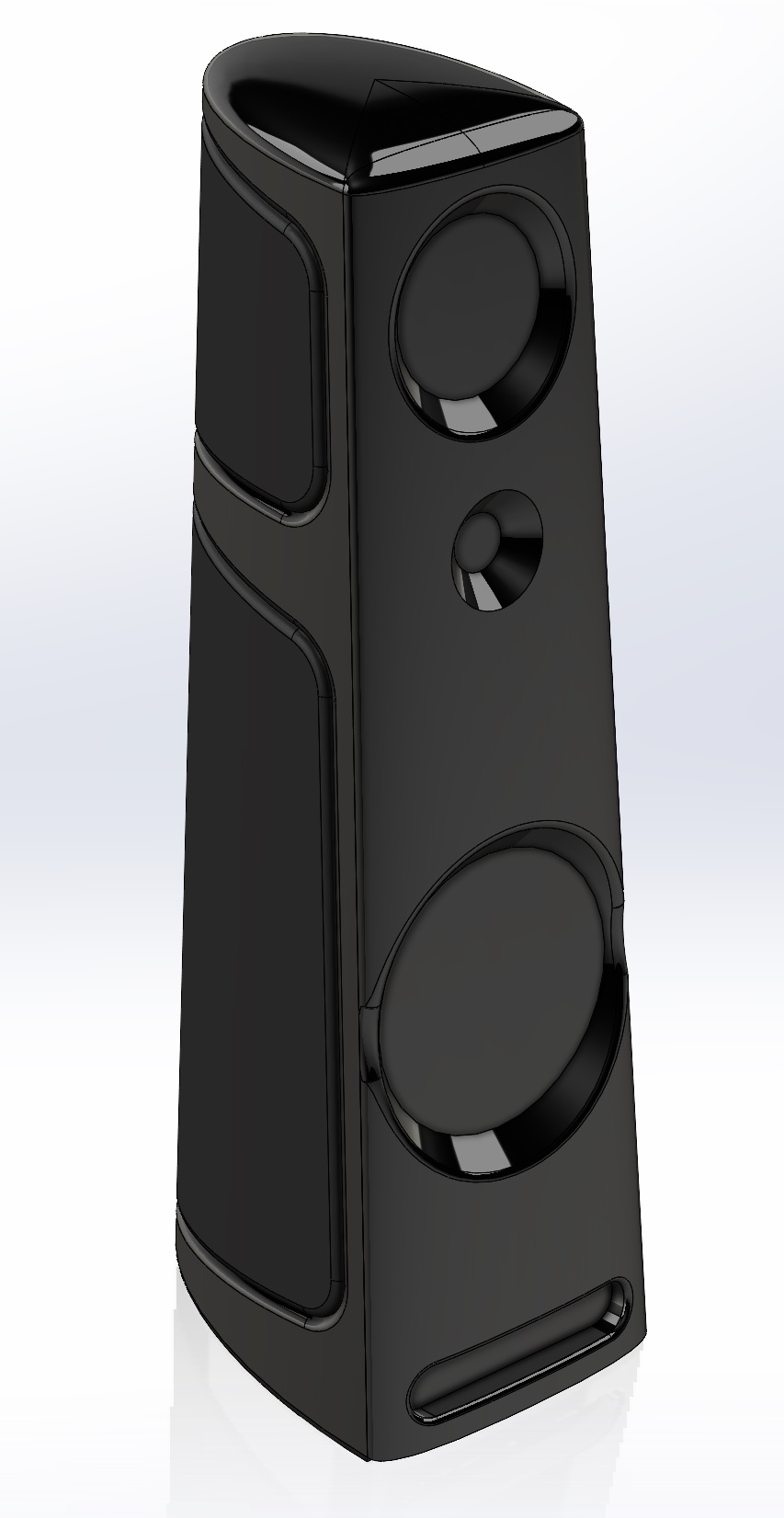

with regards to the enclosures , i really dont want a square box look and would like to do an enclosure with some curves , as i work with composites im sure there will be some carbon touches here and there
so down to the enclosure design ... if i stick to manufacturer recommendations on volume , how important are the proportions ?
i wish to do a slight taper on the uprights but still keep the volume the same obviously
the attached speaker enclosure is v1 and im sure it will change many times before i start the build , but its a start
Not very important. If your enclosure is very tall (4x or more) compared to width/depth then it can start to make a difference.
is the "Visaton HW 3/130, 8 ohm, 300 / 4000 Hz" crossover designed for these specific drivers? Hopefully the answer is yes...
Assuming "yes", then it is important to keep the front face of the speaker (the baffle) the same as the manufacturer plans. The designer expects the 3 drivers to be arranged in a certain way, at a certain distance from the floor.

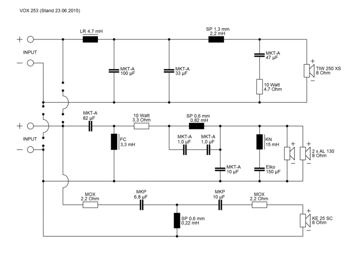

Severely fussy crossover, IMO. I see no need for LCR bass impedance correction with most amplifiers. But a metal driver midrange makes for crossover correction of metal breakup.

The off-the-shelf HW 3/130 NG crossover might work with some considerable tweaking.
HW 3/130 NG - 8 Ohm | Visaton
It's a higher bass to mid crossover point than the Conga, but that is a matter of taste quite often.

Any queries, get back to us. Personally I'd put a 3dB downward slope on a three-way. Flat and Monitor-like is a bit hard to my ears. Boxsim is not very good at tapered cabinets. A straight box might be preferable.

TBH, I am not overly keen on some of these Vox designs. Impedance is too low! 3 ohms in avoidable places. Using BassMids where 2dB louder mids are preferable.
Suchergebnisse fur „vox 253“ – Boxsim Projektdatenbank
