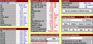

Here's what Unibox gave me for the mid.
See the attached file.
Disabled Account
Joined 2007
There's not a whole lot you can do in Unibox for the mid as it will not be producing much in the bass region.
Since you are not looking for bass response from this driver, you'll use a closed box. Here Unibox can show you how it looks for a certain size closed box, you'll see that you are not cutting the lower response with a box that is too small or having other problems like peaks in the response.
This is about as good as it gets for this driver used as a midrange - a 4 litre sealed box.
Play with the box volume size in Unibox to see what happens to the response if you make the box too small or too big.
