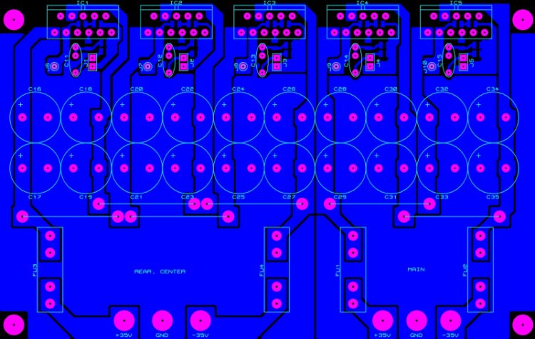

First tests with my 5ch GC

Mika,
That's a great looking prototype you've got on your pages.
I'm hoping to see your fully finished setup soon.
My be i can post a PCB for a 5 channel GC using the 'usual' through-hole resistors and capacitors 🙂
Again, Great work!

Mika,
Thank you for this contribution. I know there are many interested which will enjoy trying the project. Looks like the stuffed PCB could be below $150 for 5 channels of HT. Combined with some TB satellites or something, this could be a potent package for a large group who don't have good HT access. I may well attempt doing my first PCB using your image for a project for a friend.

I must say that this amplifier looks great! Very good job.
Your webpage was very informative, but is it possible for you to share your PCB file? My etching is not very good. Usualy they end up in the trash.
Keep up the excellent job!
