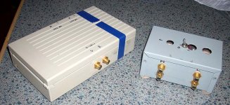

Thanx for the poke, i've had the pictures prepped but never got to posting them...
Here is the outside of the 2 XOs we've done so far... these are for Tysen, we haven't gotten as far along with the fonkenWoof XO (the 2nd order active Ace Audio works well enuff that it keeps getting bumped in the queue, even thou we know it can be improved on)
dave

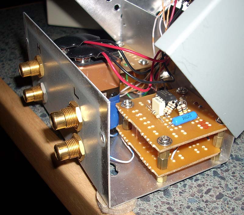

Inside of the completely passive version... this requires an input impedance of at least 50k on the mid-tweeter amp and the actual values need to be tuned for the amp in use.
Even better would be to integrate this circuit directly into the amps -- the HP could be split into 2 1st order sections.
Very simple thou.
dave
Very simple thou.
dave
And the active version... we just put a buffer on each eand of the passive sections so that it could be used almost anywhere. To keep it simple we used opAmps with battery power. Using something like the B1 buffer or a CSS-ed Cathode Follower should take it to the next level (but a lot more work).
In most situations i suspect that one could get away with just a a buffer on the end of the HP circuit.
