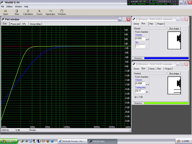

From what I can tell from simulating stuff in WinISD, the ported layout extends the bass while still keeping it a natural 0dB relative to the other drivers at higher frequencies. All the drivers are 91dB efficient (apart from the 10", which is 93), so I assume this means that the crossover design will be simplified, as there are no drivers more efficient than others (again apart from the 10") that may need some kind of attenuation to balance them out. I'm only guessing on this point though, as I don't know nearly enough about crossover design yet and how it is possible to account for such things.

anyway, this pic and the next pic is a comparison of sealed and vented, and sealed with two drivers. From what I can tell, ported is much better, but please correct me if Im wrong!

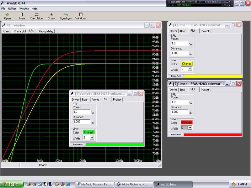

And the simulated SPL... though I presume that each driver is consuming equal amounts of power...i.e. in this simulation the twin sealed driver configuration is consuming 2watts, not 1 like the other two traces. I doubt this is too realistic, but thats not really what im looking to prove anyway....i think...

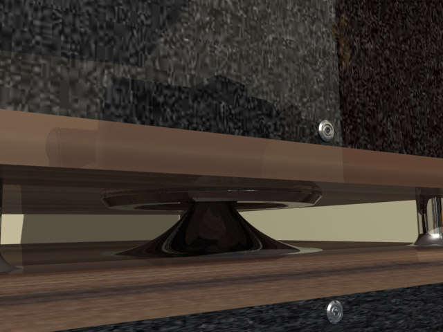

Gonna redesign again to get the trumpets flush with the granite, not sure how it's gonna look though.
Check your email Bricolo... I'm quite proud of it and waiting for some feedback, hehe

Do you like the look of the trumpets or are they there for some other mounting issue?
If you just want to flush mount the drivers, I think what you can do is just cut a hole larger than the overall diameter of the driver. Then cut a mdf donut to fit snugly inside the hole in the granite. If you epoxy the mdf ring to the granite, then you just secure the driver to the mdf ring.

Bit of both really. I do like the look of them, and I was just toying with the idea of flush mounting the trumpets, but decided not to bother as I assume that the accuracy of the hole cut in the granite will be relatively quite poor. I'm also now doing it for rigidity reasons as discussed earlier, so I can get away with solid mounting the mid and tweeter.
