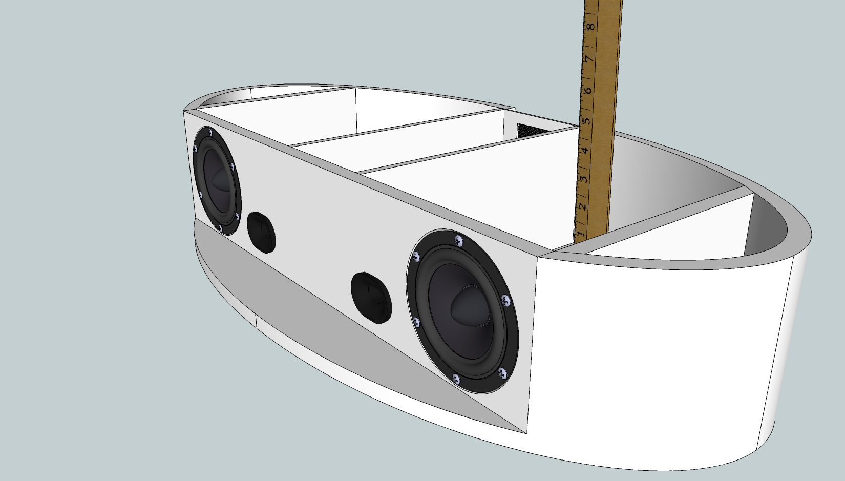

I'm about to start my first speaker design and I've chosen to build a Sound Bar that looks more like a center speaker, because the TV and stand will have to sit on it. (See Pic) The goal behind this project is to produce something that sounds a lot better then the speakers built in to a 32'' Samsung TV, so that can't be hard, right? My targeted audience are my parents who have found the sound quality on their Samsung to be less then adequate, which is true for pretty much every flat screen I guess.
When I visit (at the wrong time due to some soap being on) my mother will often comment on how the tiny TV in the kitchen sounds better then 'That Thing', and she's not wrong, even after extensive tweaking it still sounds pretty awful. Of course there’s more to it then just a poor sounding TV. Neither of them are getting any younger so their hearing isn't what it used to be, it comes to us all.

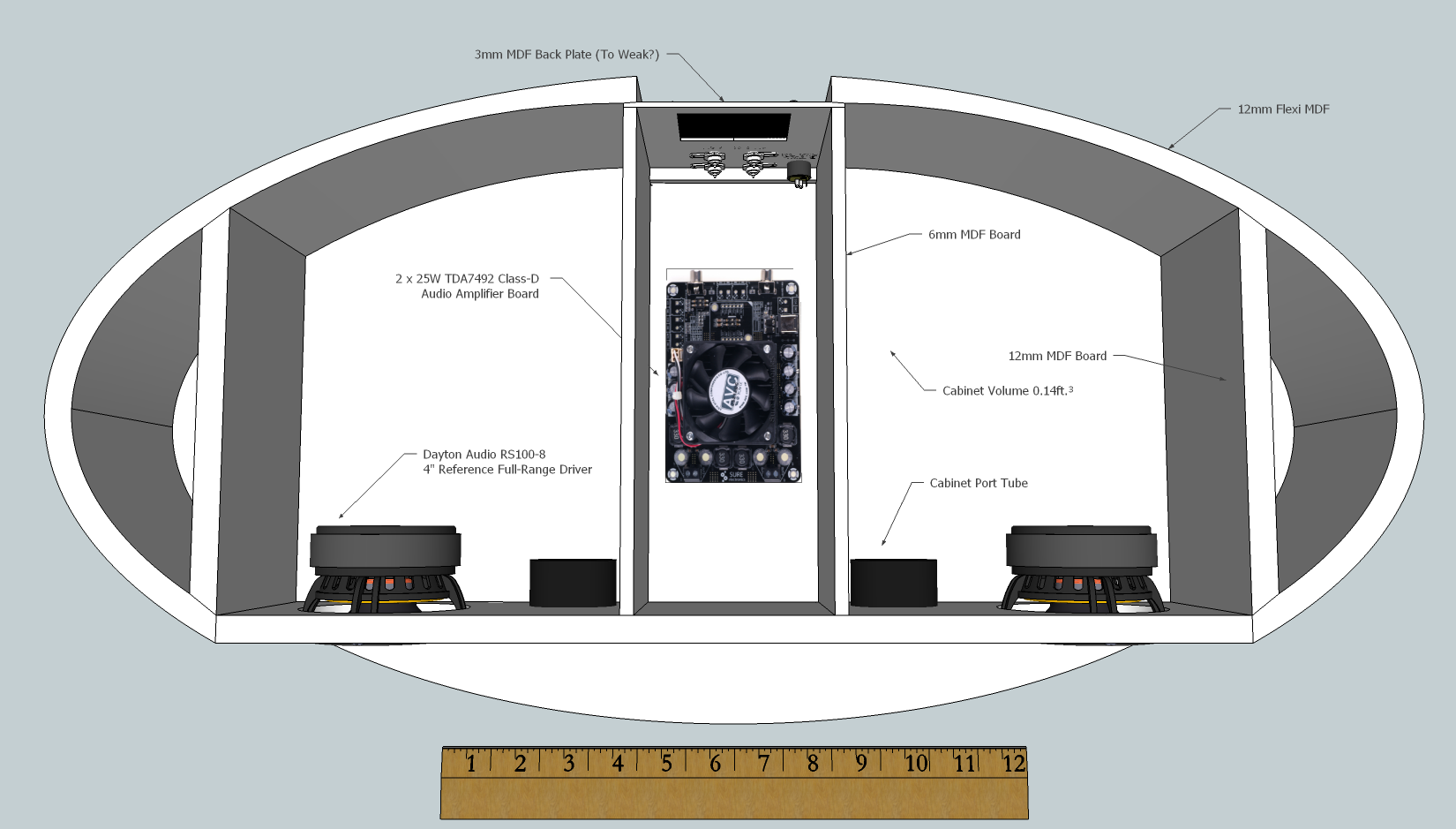

I'm considering using a 25W @ 4 Ohm TDA7492 Class-D Audio Amplifier (14v-19v 3A) by Sure Electronics along with a pair of 4'' full range Dayton RS100-8's in a ported box. I believe the amp/speakers to be well suited for a ported boxes with a Volume of around 0.10.- 0.17 ft3, although I haven't worked out the port size yet.
Like I said this is my first build so I'm not trying to take on Pioneer and their EX series speakers. I understand there's a lot more to speaker building then putting a speaker in a box, in fact I've read so much over the last few days that I'm going have to read it all again, then again...
Any and all advice will be much appreciated, for example the pics I've provided here show how the SB will look. However, each one is different inside. Are round surfaces inside a speaker box a really bad idea due to resonance, even though it will be packed with good quality acoustic sound dampening? Are these voids within the box going to be an issue?
My budget will be around £150 for this project.
Although I expect [FONT=Verdana, Helvetica, Arial, sans-serif]there is no single "right" or "wrong" way,[/FONT] what are the do's and don'ts for newbies such as I?

Curved surfaces within speaker cabinets are just fine; the main reason they're not widely used is the difficulty in construction relative to flat slabs. Obviously the material you build the box out of doesn't want to flex too much, and absolutely mustn't rattle or buzz – which involves using lots of glue, mainly.
I see no acoustic requirement for anything beyond your first proposition; indeed, just one lump running front to back separating the space should suffice (unless they're essential bracing to stop the box vibrating, or you're intending to mount the amp in the centre space).
You're not going to get much stereo effect, but as long as it's not music programs you're probably not going to miss it much.

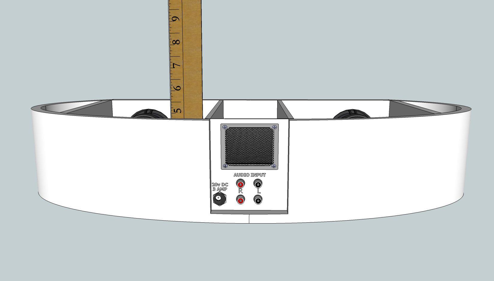

Thank you for the change in pictures; I can now (just) read "amp here".
I assume you'll have a cover on this, not just the TV set? Then your amp is going to need ventilation, or heat sinks on the outside of the box, or it's going to overheat (nothing, neither power supplies nor amplifiers, is 100% efficient, and the waste energy always ends up as heat. It will probably need a connector panel, too, so as not to have loose wires trailing, with an on/off switch, and if this gets a bit warm that's just how it goes. If the heatsink/connector panel can be taken out of the back, complete with the amps, you can glue the top panel on as the speakers can be unscrewed from the front (and it's always easier to make an airtight seal with glue than with screws.

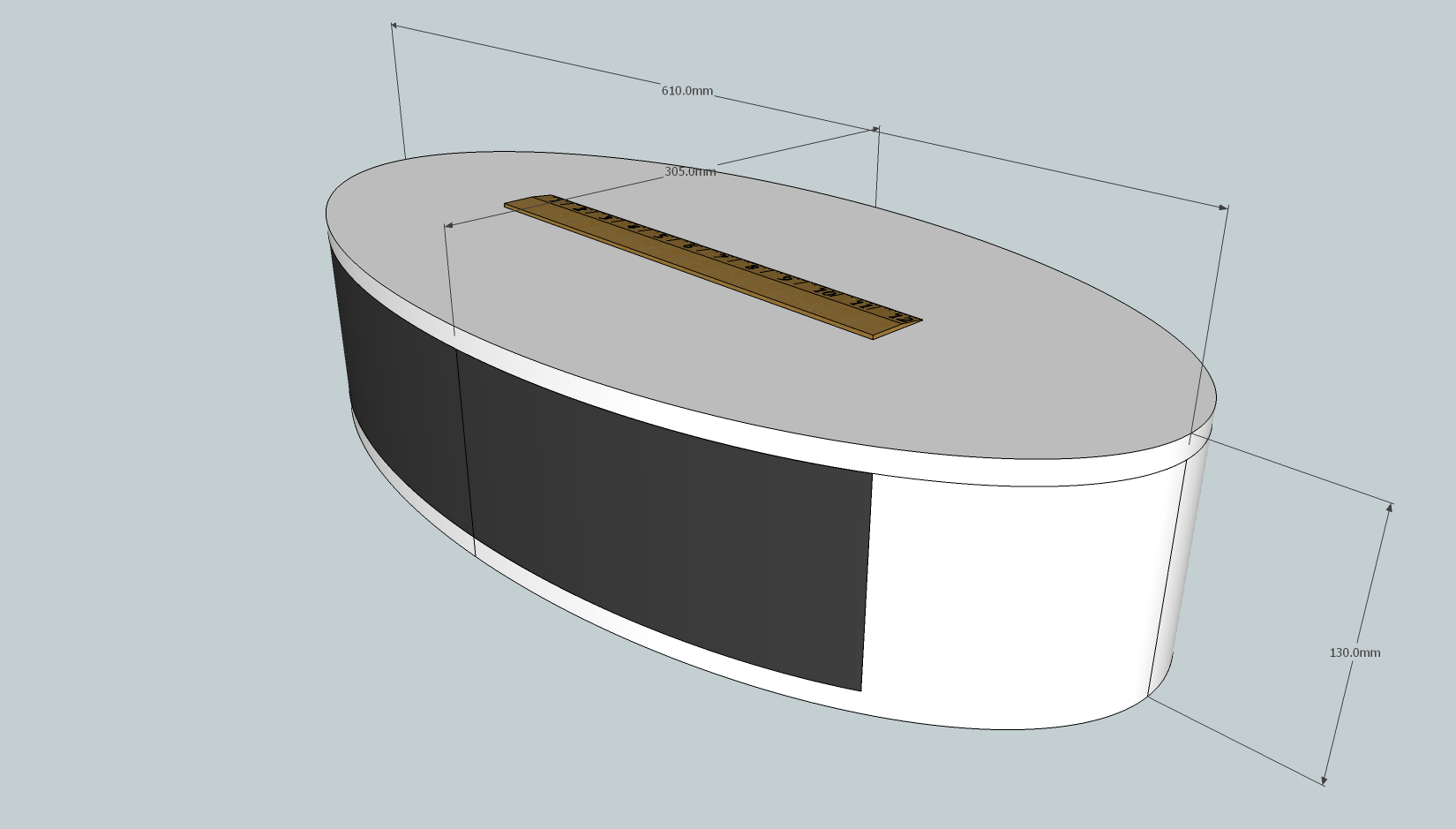

Those Pics I've attempted to add to the original post are not the finished design, just the basics of the speaker shape, my main concern was using curved surfaces instead of right angles. I've added some links to this post (hope these work) to give you a better understanding of my design, again these are not by any means the final design.
My first stumbling block in all of this is getting the ellipse shapes cut, either the local family run DIY shop on the corner street is to small to have a CNC router, or those local companies that do have a CNC router can't be bothered with such small fry like myself.

I think the base part that sticks out in front of the baffles will worsen the sound quality. The sound will bounce off of those and right back up at the drivers. Secondly, as for the central amp compartment... Anything you can do to recess the front part of that - move it back from the baffle - will improve sound quality. You parents will want to make out the TV dialog, and so I think these are important issues. Perhaps you can make some kind of a vent, such as out of slats, recessed, in the center part of the baffle, also to provide air flow for the amp there as well? With venting, I think you could go with an amp that does not use a fan.
Do you intend to cut a stack of oval pieces and glue them all together? It looks like a very ambitious bit of work. Best of luck to you!

Ook, I should add, "the top as well a the base will stick out in front of the baffles". These are both going to do the same thing - add distortion and make it harder to make out the people on the TV. Perhaps you can consider a baffle that is slightly in front of the base of the TV, and which keeps its flat baffle, but is not purely oval in its finished shape?

You are absolutely right in saying it looks like a very ambitious bit of work and correct in pointing out the flaws in the design. In fact the more I read about speaker building and the more I talk to good people like yourself the more I realise I'm making a big mistake here. I think this project is a classic case of a newbies excitement and enthusiasm getting the better of him.
The penny sort of dropped after a few CNC companies got back in touch with me over the weekend saying they can certainly do the cuts (for a price) but were concerned on how I was going to stick it all together, and more importantly how it was going to stay stuck together. I also spoke to a chippe (a joiner) last night who had a few sharp intakes of breath.
Needless to say this project is now on hold until I have more experience, lots more.
I've seen the light, I found The Speaker Building Bible. My first project is now going to be a cheapish off the self DIY kit.

You could stick a pair of those speakers into a shell like what you have depicted, but say 10-12" tall, with a little space left over to place 9" tall speakers inside of it.
Er, actually, build a pair of one-ways like you have already selected, which would be much shorter and could use the horizontal space nicely.
