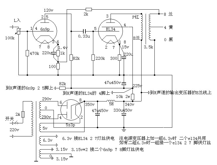

Now, I decided to use these cabinets to build the speakers for a chinese el34 DIY tube amp kit thats on my way atm, similar to this one:
https://www.diyaudio.com/forums/tubes-valves/182989-building-chinese-se-el34b-amp-diy-kit.html
I allready ordered it before reading here at DIYaudio that it is actually a cheap piece of junk, but since I ordered it for the fun of learnig and tweaking it in the first place it should meet its purpose.

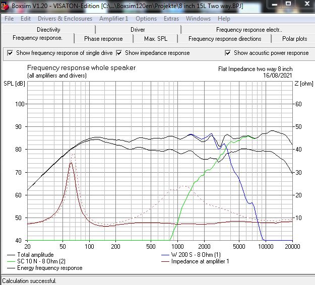

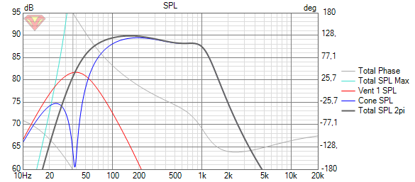

A ported 15.35L enclosure with diameter 40mm, 140mm long port should give me an acceptable f3 of 56,6 Hz/ f6 43,6 Hz/ Fb 38,0 Hz

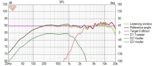

What are your thoughts, feedback of what I've got so far?
All comments, advice are very much appreciated.
Am I on the right track here?

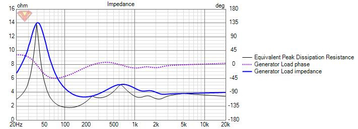

Is the impedance curve acceptable? because I just cant get it flatter without messing up the frequency range.
Is that bump around 900Hz something to be worried about?
The overall sensitivity is around 89dB, will this be enough for the amp?
I attached the curves pics..
3rd pic is the enclosure SPL with the XO applied to it.

One thing that is not really obvious to novices is that loudspeakers and drivers design is and exercise in compromises. For example you can have 2 of the following characteristics, low bass, high sensitivity and minimal volume, but not all three together. You have to choose what is least important for your and leave it.
Another thing that maybe you missed is that all drivers in a finite baffle exhibit a so called baffle step effect, that works in having gradually all frequencies under one frequency dependent on the baffle width reduced in level by 6dB. So if you work with a driver with a nominal 90dB sensitivity in free space, your speaker will have bass at 84dB. In real world situations the baffle step compensation can be only 3-4dB, so your overall speaker SPL can be in the range of 86-87dB, but not more. Your design omits the baffle step compensation (BSC), and you can do this way only if you put the driver in an infinite baffle.
Tied to the baffle step effect there is diffraction, another effect that depends on the baffle geometry. So if you use a finite baffle, you can't simply import frd files generated in free space into a crossover simulator. You have to manipulate them before in order to simulate diffraction and baffle step effects. VituixCAD has a tool to simulate them, but when you use it you also need to have VituixCAD at least calculate a new minimum phase. Last thing to do is to have an appropriate delay between drivers as the acoustical centers of the drivers won't be in the same point.
A last note on your design, impedance is not tube friendly. You need a parallel LCR filter before the crossover to have a really flat impedance. Have a look here for what I mean: Zaph|Audio - ZA-SR71
I think you can have something working out of the drivers chosen, but it won't easy as you think, and the result maybe won't meet your objectives. I still think that the better return on investment is a second hand speaker or a kit that can suit your boxes. You haven't stated the box dimensions, so I can't really suggest something, but as an example I would happily buy this kit, but it requires a larger box than your (I'm not affiliated in any way with the designer/seller): Suzie "Q" | Scan-Speak Discovery compact speaker

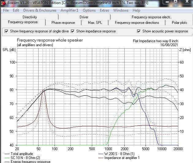

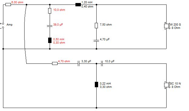

This is how the Visaton modelling turned out. Below. I show the effect of impedance correction, and the surprisingly improved response with a reflex driver, closed box and 6 ohm SET amp. Reflex, I would avoid.

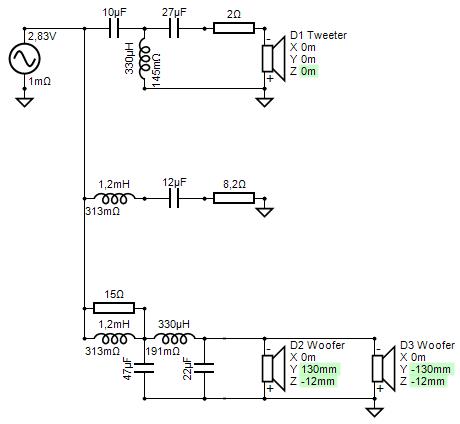

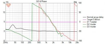

First of all, thanks a lot for all the feedback.. it gave me a lot to read, dive into and to learn to understand. I really appreciate it.

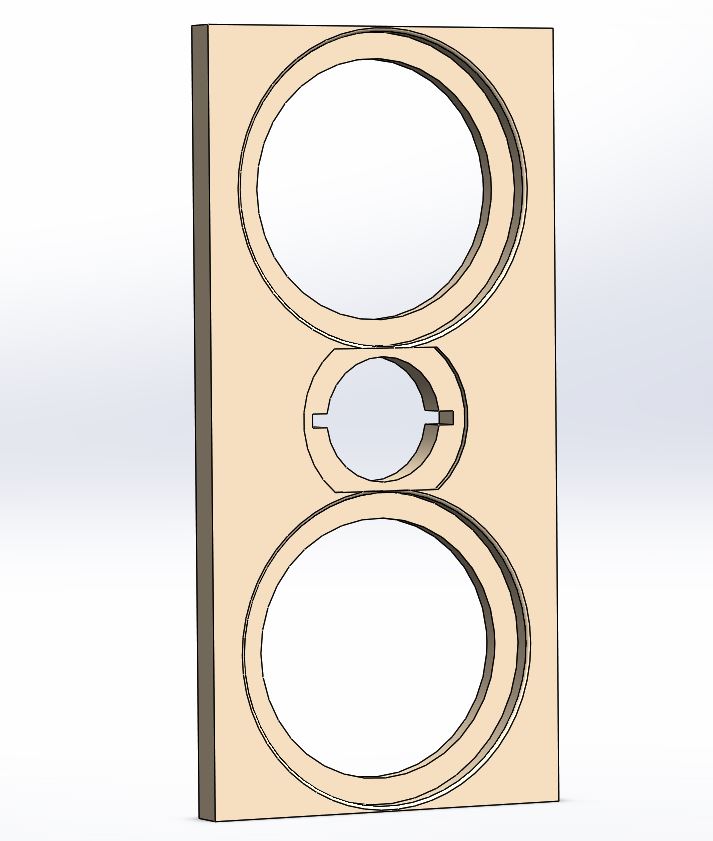

I came up with something different now, an MTM design.. I'll have to CNC out a new front for it but luckily I know a guy with an amateur CNC machine.
So, do you guys think this is getting somewhere?
I do am a bit afraid about the reliability of the simulation software, it definately is an amazing tool, but I really hope its not to far of..
- I hope that I have a better basis now.. the idea is to play around with the woofers XO bypass resistor and tweeter series resistor values to tweak the frequency curve a bit once built. (simulation showed that changing these values have very littel impact on the impedance curve)
I kinda hoped that the speakers could be somewhat "universal" i mean.. 4Ohm speakers, connect to 4ohm amp tap and dont need to worry.. is there something that I'm missing??

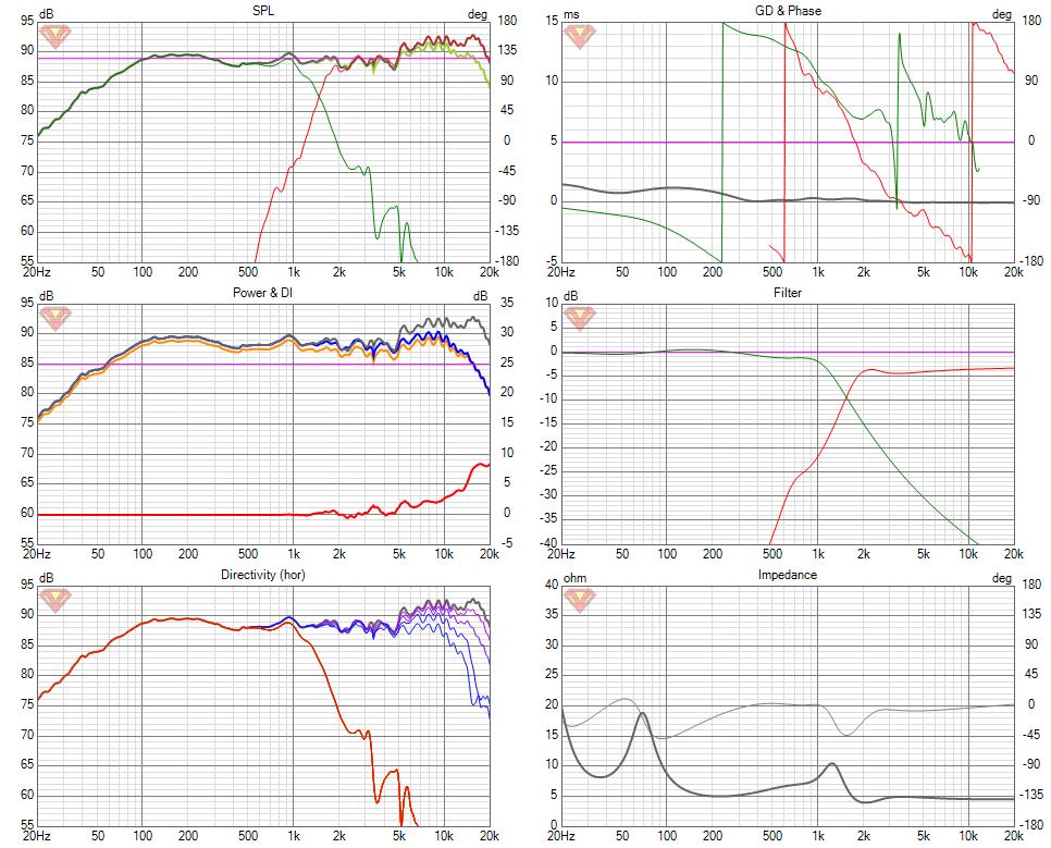

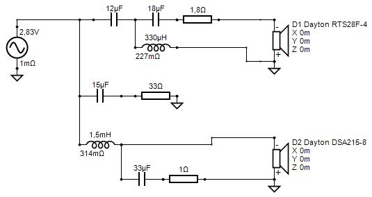

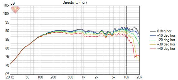

- I now simulated baffle step and difraction, exported that FRD file and came up with a different crossovers taking into account the full -6db baffle step loss. The lower end is reasonably flat, but I think with the speakers positioned near to, or even against the wall I should end up with a slight downslope in the 100Hz->1000Hz range.Tied to the baffle step effect there is diffraction, another effect that depends on the baffle geometry. So if you use a finite baffle, you can't simply import frd files generated in free space into a crossover simulator. You have to manipulate them before in order to simulate diffraction and baffle step effects. VituixCAD has a tool to simulate them, but when you use it you also need to have VituixCAD at least calculate a new minimum phase. Last thing to do is to have an appropriate delay between drivers as the acoustical centers of the drivers won't be in the same point.
- This is what I really struggled the most with, keeping the impedance up together with the overall efficiency drove me nuts.. I think/hope this drivers/XO combo should be OK for the 4Ohm taps of the amp with EL34 tubes.A last note on your design, impedance is not tube friendly. You need a parallel LCR filter before the crossover to have a really flat impedance. Have a look here for what I mean: Zaph|Audio - ZA-SR71
- Couldn't find it anywhere online.. its a chinese DIY kit, very little info to find about itYou haven't mentioned the output impedance of the amp, it may be small?
- I think this new MTM design gives me the desired sensitivity of around 90db and also the possibitity to play around with bass exension. My idea is to make 2 back panels in mdf, a closed one (a rectangle in mdf is quickly made) and a second one that alows me to try ported with different lengths. Simulation shows that I should get fairly low F3 of 56Hz ported, which would be amazing, but I might prefer tighter bass... its just nice to keep the options open.In general, high sensivity on low power needs a big speaker, especially if you want a strong bass response. And baffle step is an issue, so i would also go higher in bass response. In reality you loose about 4dB by diffraction, so you need a woofer that gives +4dB of the wanted sensivity. So i think you try to do the impossible breaking of the hoffman iron law. You need a bigger driver and box for what you want or use lower sensivity speakers so lower maximum volume. Choose your compromise.
- Thanks for the suggestion 🙂, but my goal is really "learning by doing" here. Thats why I prefer the approach to start from scratch, bump into problems, learn, and find sollutions. I understand that for many here at DIYaudio the problems I faced so far with the first design is really basic stuff.. but for me its a new world that Im getting to understand now. Buying a speaker DIY kit would definately be easier, probably cheaper, and maybe sound better (I dont really want to know 🙂) but I wouldnt be forced to learn..This is a good design for what you want: Suzie "Q" | Scan-Speak Discovery compact speaker
- I actually wanted to build a pair of speakers for a while now, the broken Dual speakers and the DIY tube amp kit it ordered for fun gave me a reason why not to just pick up a diy kit. The amp might change one day and efficient bookshelves will allways come in handy.OPs project is driven by cabinets chosen for that great 70s look and by a single-sided tube amp that is sonic junk.

Ok, this is new to me.. more to read into. The circuit diagram that comes with the amp has negative feedback, but I came across a few threats here with improved circuits and my intention is to play around with it.. I do know the amp does not come with a 43% tap on the OT so I can forget UL mode.. (attached the drawing)Question mark over the valve amp. Is it SET or a feedback design? If it is SET, impedance is fixable.

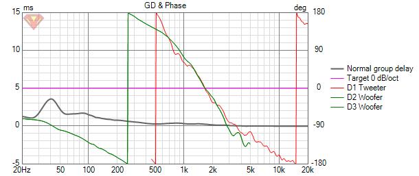

Good evening,
I'm about to order the parts unless I'm missing something here with this design..
I Would really appreciate if somebody could have a quick last look at it before spending my 💶 💶 💶
I was going to order a few different ones for fine-tuning, also for the woofer its XO bypass resistor.Do you have spare resistors in case you want the treble reduced?
