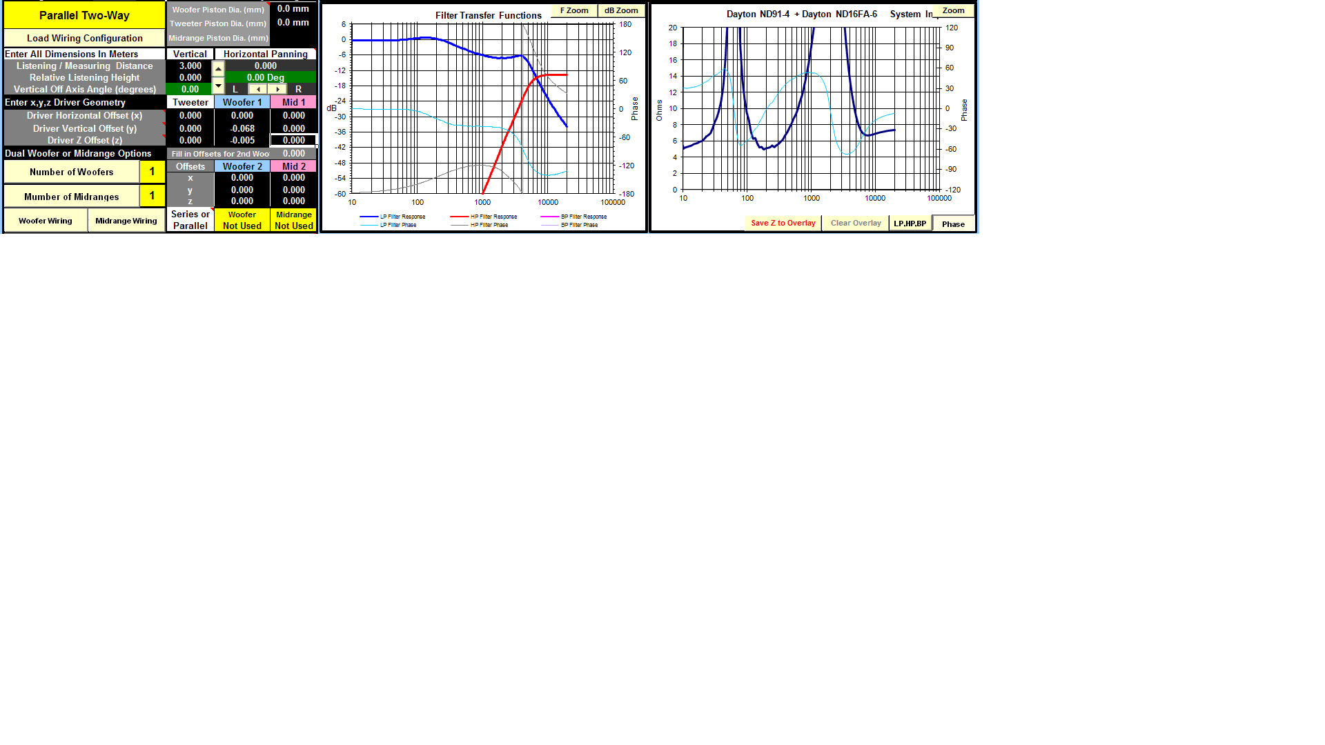

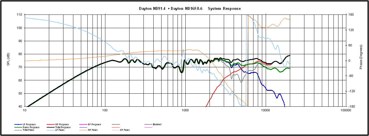

Ok, here are some sims using PCD. For the tweeter, I'm using Zaph's measurements but for the woofer (if you can call a 3.5" driver a woofer?) I've had to rely on Dayton's graphs which actually are usually fairly accurate. I've assumed the driver's are front mounted flush and that the box has no edge treatment. Response is with a sealed alignment.

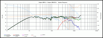

Let's do the last graph 1st. This is with the component values you currently have but with full baffle step loss incorporated (so the drivers out on stands in free space) and the curves echoe what Dissi showed earlier - basically you are just listening to the ND91-4 with those current filters with barely any contribution from the tweeter at all. Driver phases are nowhere near aligned and the bass should be sounding somewhat thin. I'd probably call this speaker shouty.

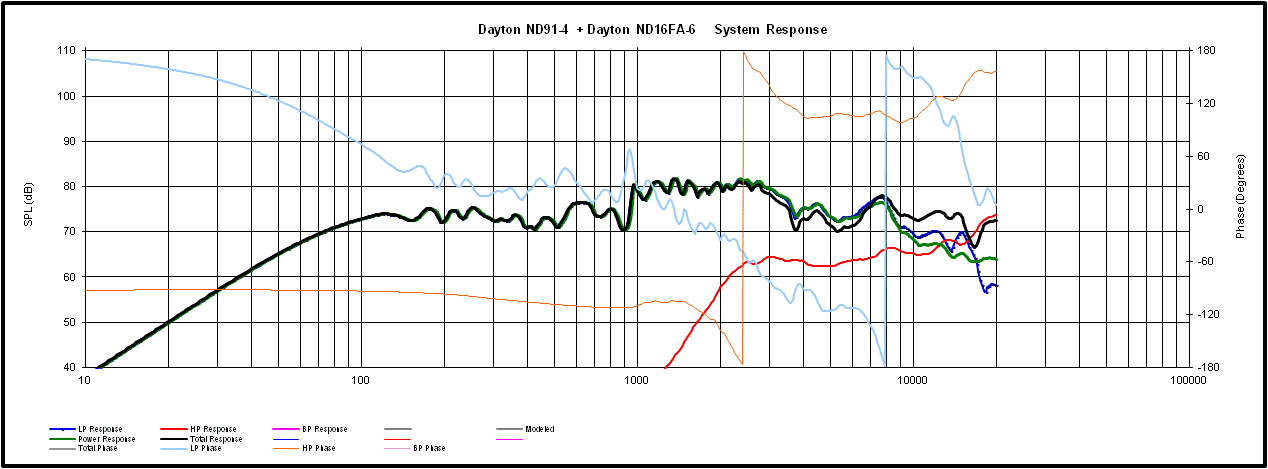

The other graphs show the frequency, phase, power and impedance responses plus the transfer functions of the xo I came up with. I tried more than several xo combinations with these drivers but their phases didn't want to line up until I got to 2nd order on the woofer and 3rd order on the tweeter. I ditched the Zobel cause it didn't need it. Part count ends up at 8 with the added resistors - 2 of them for an L-pad on the tweeter. That may seem like a lot but 6 of those parts are caps and resistors which can really be quite small if you choose the right parts, like PE's non polarized caps for example - tiny and inexpensive.
Cross over point is at about 5000Hz. Sensitivity is at about 75dB. The biggest negative here is the suck-out between 300 and 900Hz which is a product of the driver response and baffle diffraction that I unfortunately can't do anything about with the xo, well...... not without maybe doubling the xo parts count!

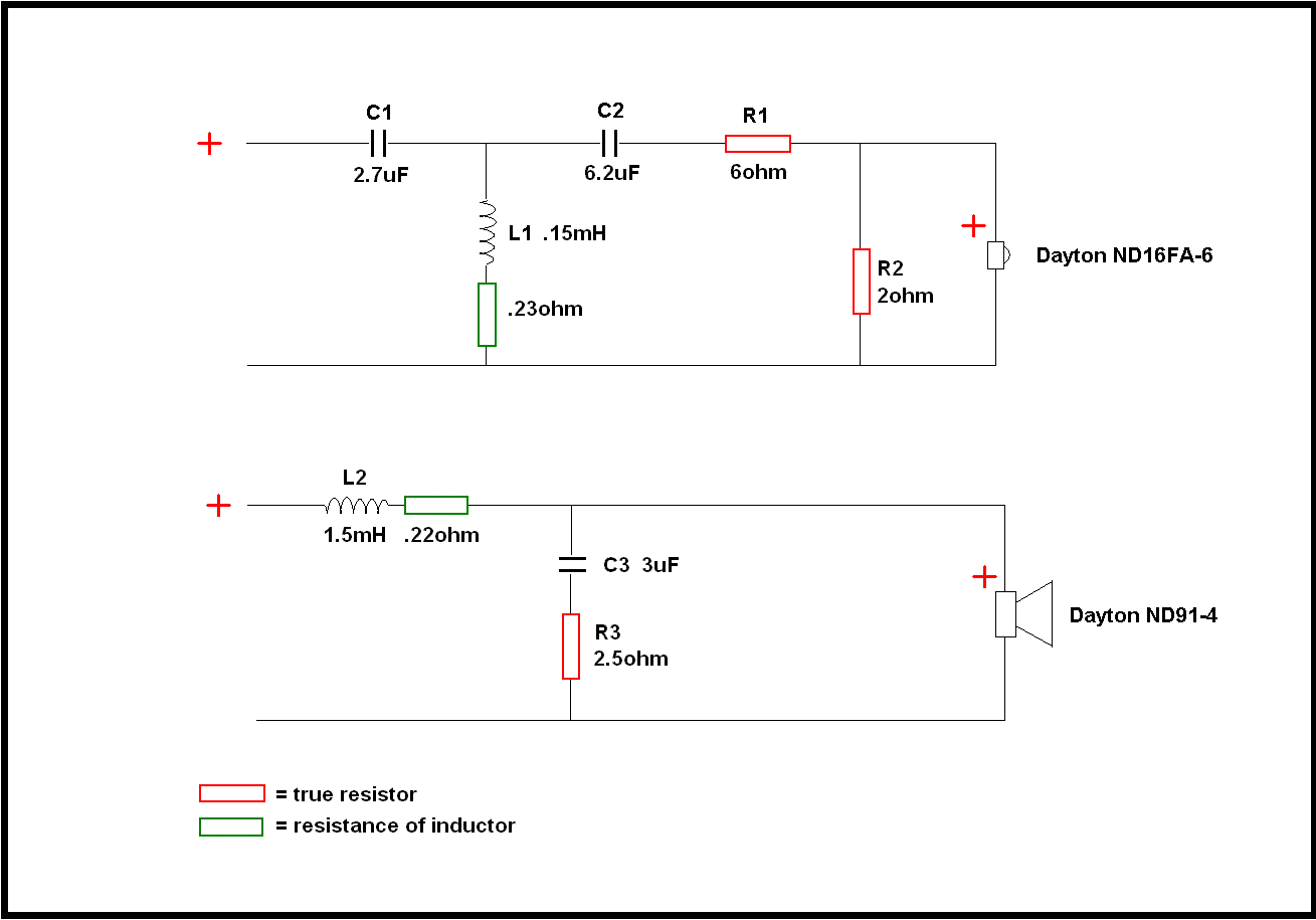

This is outstanding, thank you. If these boxes ever show up, I'll use this crossover design unless anyone has any objections. You mention an lpad but I don't see it in the schematic, how would I wire it in? Also, I really value the bass that I can get out of these tiny speakers, what do you think of my ported design mentioned one post up, I'm I losing a lot of sound quality by not using a sealed design? Their primary location and probably anytime they are moved, they will be within a foot of a wall.
R1 and R2 form the L-pad.
Oh I see, they are like my 50 ohm resistor in my posted setup. I confused them with the variable lpads I've seen on parts express.

ive got a pair of nd91s and was considering adding a tweeter. the woofer inductor that has been posted twice was 0.15MH however the last crossover list that got used had a 1.5mh. theres a big difference in size and price so I don't want to order the wrong one. can anyone type out the correct list? and is 20AWG wire size correct?
Make sure you have the 4ohm version of the driver - that is what the xo was designed for. Your baffle needs to be about the same size too - 6.5" x 4.5" with 1/4" between drivers, flush mounted. You can alter the depth and the port(s) to suit your own preferences.
1.5mH is the correct value to use with the rest of the xo re-posted below. Find a gauge that has about the same resistance, .22ohm .
