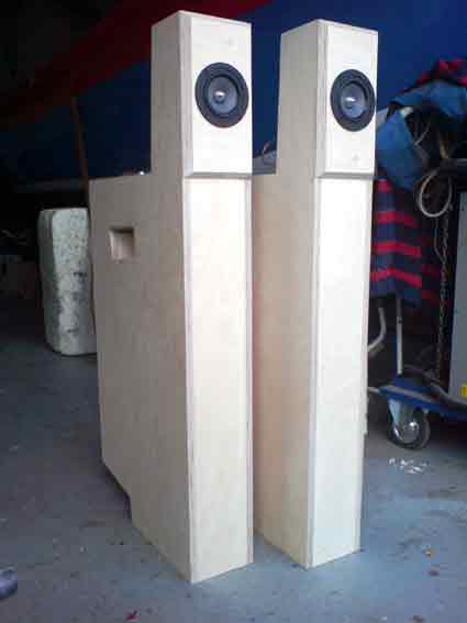

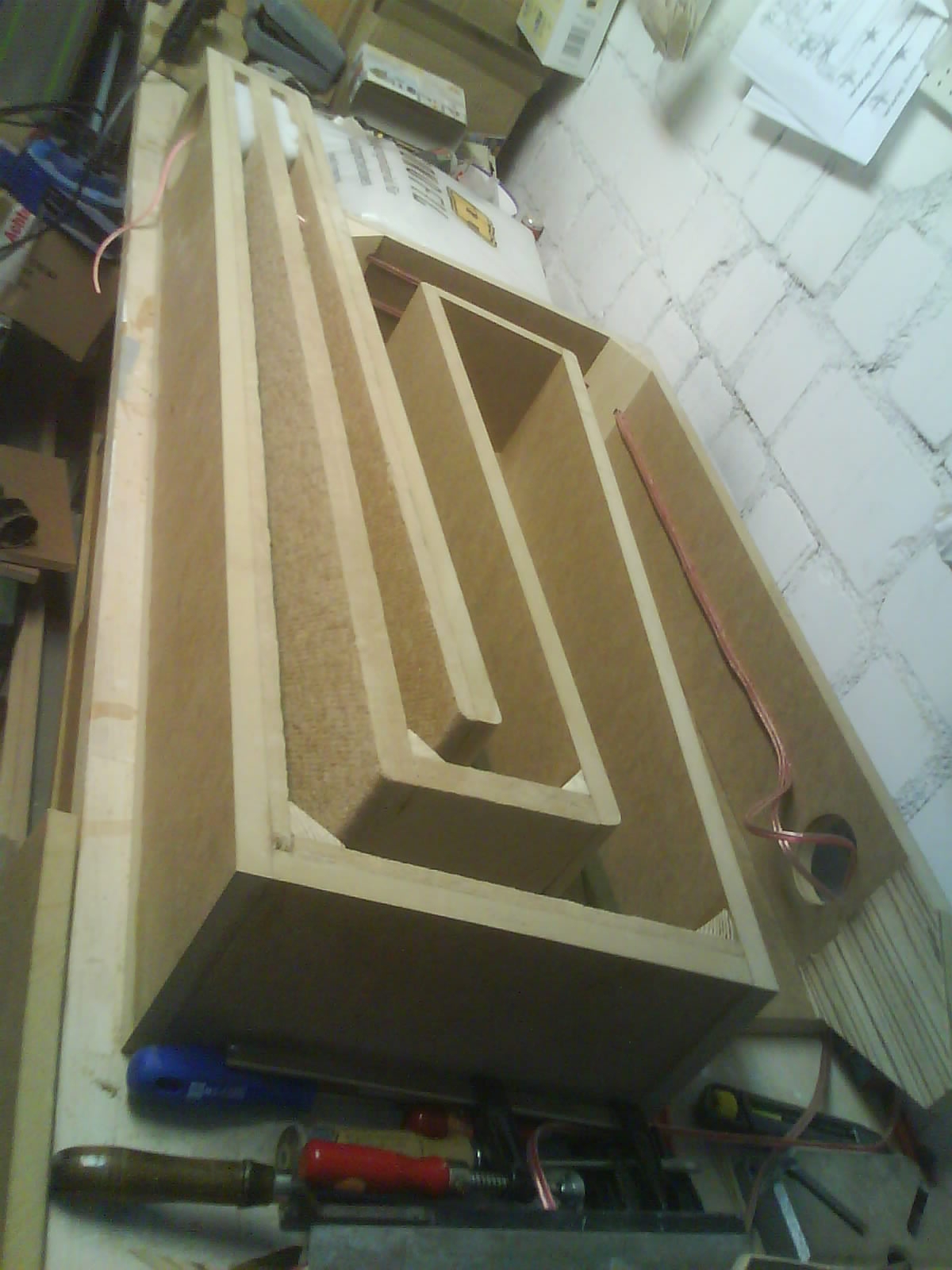

"Or could a dual driver cabinet work pulled a foot off the wall?"
sure,
look my KORNETT, no only good WAF,
also measurements and imp, best soundstage, down to 34 Hz
