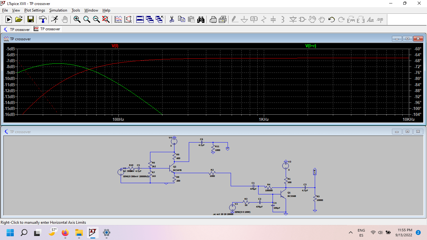

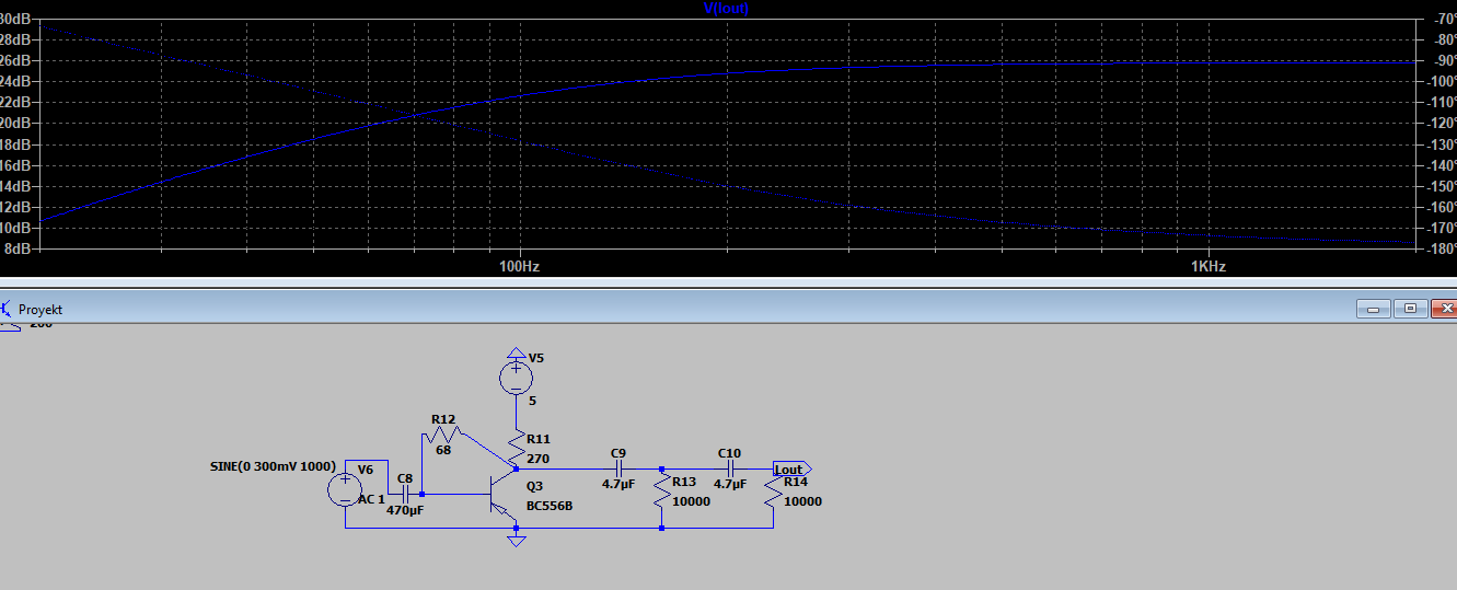

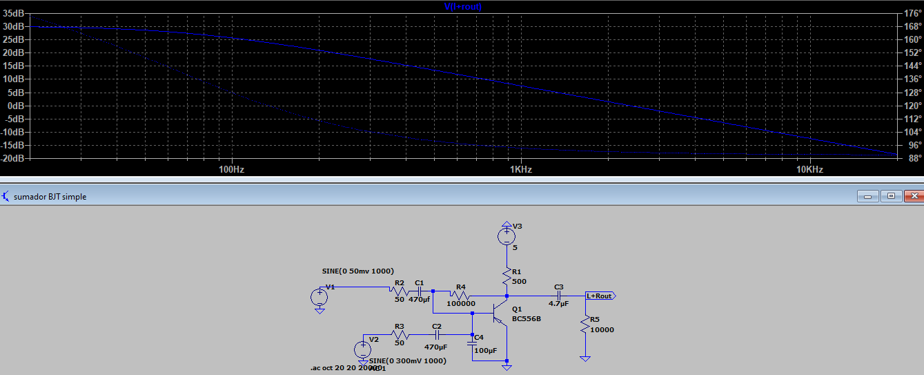

Hi there, i'm trying to make a L+R summer with LP with the least components possible, which also provides the original L and R reparate channels with HP.
Despite both circuits need some adjustment to get the -3dB point coincident, i sort of get what i want, but when i connect both things in parallel to the AC generator the filters go mad. It may be an awfull abomination but this is as far as i got, is there an easy way to isolate both circuits if they share the signal, or my attemps are worthless altogether?
In the pics u ll see the buffer for the L and R with HP and the L+R and then the awfull altogether stuff. Besides adjustmets, it just fails to work altogether when joined:
Here just the LHP:
Here the L+RLP: (incredibly DC is at about -2.5V)
And here the little frankenstein:
The power amps will load the filters somewhat, and may reduce gain and shift frequencies.
Adjusting the R and C values appropriately should be able to work well enough.
