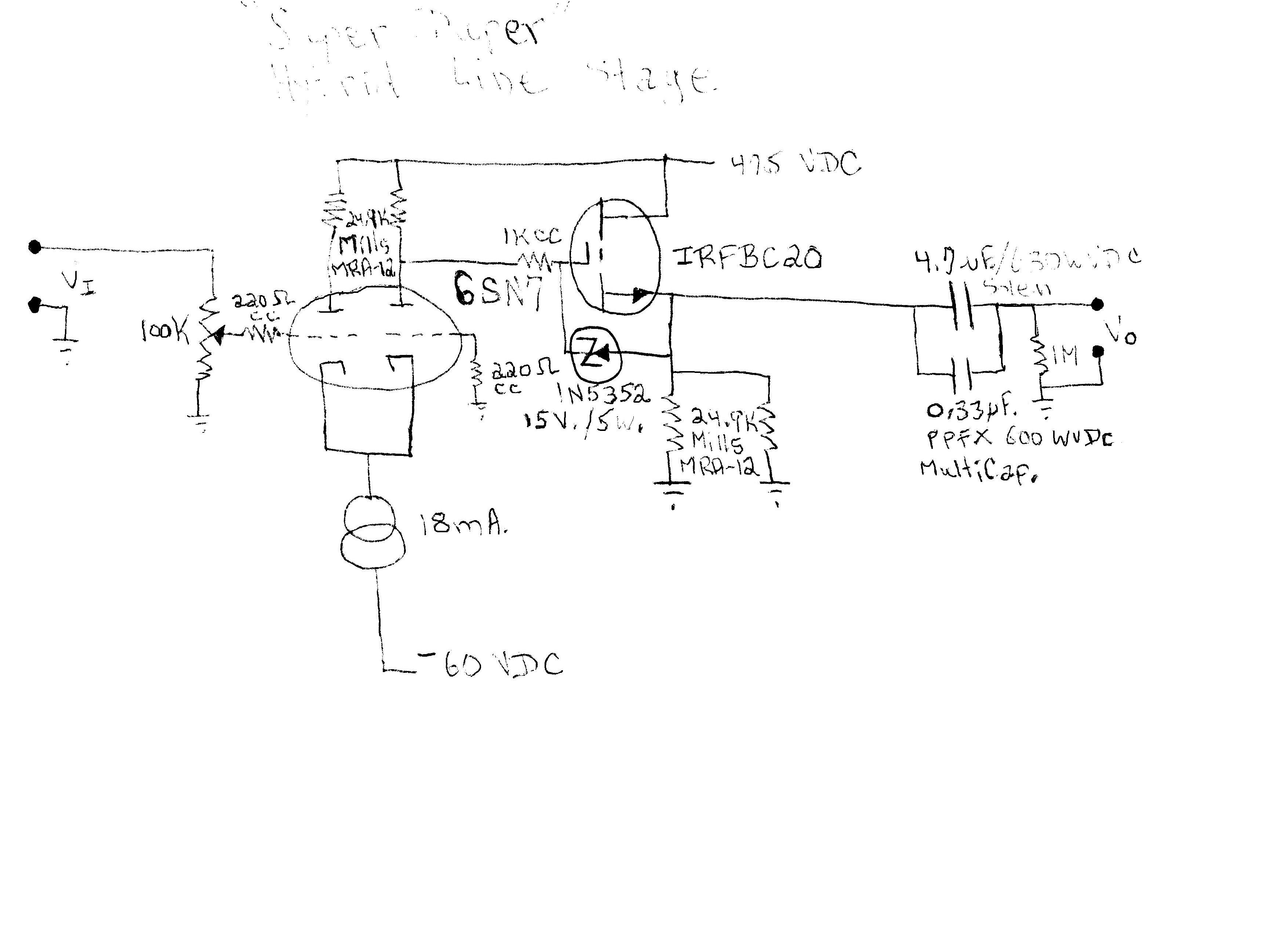

I have built a passive preamp and am happy with the results. My next goal is to build an active preamp. I was thinking of just a buffer using some cathode followers but I think I would like some gain. I am open to any recommendations for cloning a proven design, or kit. I am also tinkering around with some ideas in my own head that I would like to run by you professionals out there. I would like to state that I am by no means an engineer so please be easy on me😱 My giant box of vintage 6SN7's are just begging me to use them in something so I figured a line amp would be cool. I would like to state that I did not look at any schematics using a 6SN7 line amp, I just looked at datasheets and tried to pick some okay looking operating points. I was aiming for a gain of around 14db and I am not a purist so caps and feedback are okay with me. I went with 26db of feedback to get the gain and distortion low enough. Simulation shows low distortion <.002% I will probably be using a B+ of 350V, and most likely regulated, I have some high voltage Maida style regulator boards ready to use.
Any gross mistakes I am missing? Should some compensation be used around the feedback loop to correct any phase shifts?
Thanks for taking the time to look in advance

your design looks overly complicated with one more gain stage than is strictly necessary.
I suggest you look at the FVP5 for inspiration;
http://www.tnt-audio.com/gif/fvp5a_schem.gif
just build the second half of the schematic. An excellent performing amp with low distortion without feedback. Should be adaptable to use your 6SN7
Alternatively look at the Aikido, this has fallen out of favour recently but simply because its so tried and test without any novelty, but a solid performer;

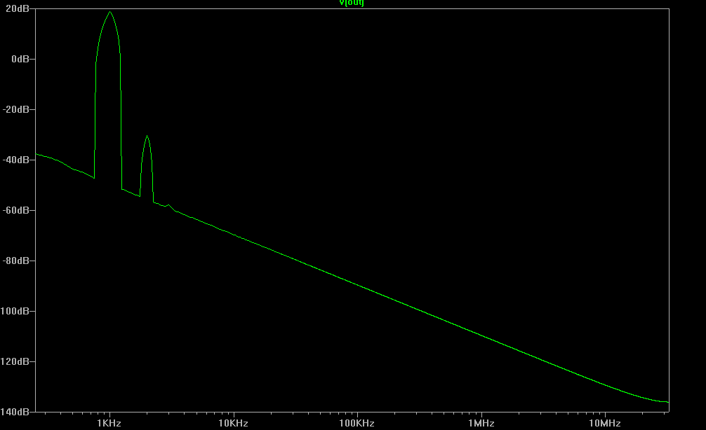

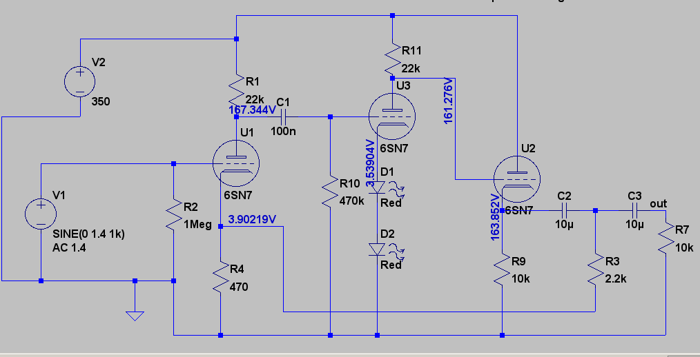

So I had some more time to look over all your suggestions.
Hi Eli, Thank you for your schematic, looks like a very nice topology with very low distortion, .03% THD in a simulation. I might like to do away with the Mosfet source follower and use a cathode follower to keep it all tube🙂
Hi Shoog, That FVP5 looks interesting, but I fail to see how it is less complicated than my schematic😕 It is using four triodes as apposed to my three and has MUCH higher distortion then I would like, see attachment, I think it might color the sound more than I would like. Driven by 1Vrms it is putting out 4.2Vrms @ 1% THD😱 I am not sure if this is because I am using a 6SN7 instead or what.
The Aikido looks very nice indeed, and I have heard good things about it. Distortion looks okay, I would like it to be lower @ .3%THD but the FFT shows it's dominated by H2, just a slight bump at 3rd harmonic🙂
The Aikido uses 4 triodes and mine only uses three, and mine yields .0025% THD 😀
Is the fact that I used feedback the reason it is frowned upon? It seems like feedback is a no no around these parts🙁

The uploaded hen "scratch" schematic can be used, with or without, NFB. A differential gain block driven at only 1 I/P can produce no more than 1/2 μ.

I have yet had a chance to look at Frank's preamp yet, I still can't find the actual schematic.
I really do like the Aikido and is most likely my first choice for a "clone", although Eli's schematic I keep going back to......I really like it🙂 And I haven't looked at Frank's schematic yet so I don't want to count that out. I just think it would be cool to use something I designed. Also I am using tube power amps similar to the Mullard 5-20, since the majority of the distortion will be made in the power amps, and knowing that I really like the sound with just a passive preamp, I would like the active preamp to be as "transparent" as possible, so I am shooting for something with really low distortion still using tubes.......this leaves me using a lot of feedback and 3 stages. If I were to be using a super clean solid state power amp then well maybe I would be looking for a preamp that added a touch of harmonic color🙂
When you find a tube with the very high transconductance of the IRFBC20, please let me know. The large transconductance equates to a low O/P impedance and superb drive capability. Zero heater current draw, no concern about heater to cathode potential limits, and incredible ease of setup are other things the FET has in its favor. Sonicly, properly set up FET voltage followers are highly transparent.
JMO, all tube is a fetish. Carefully thought out tube/FET hybrid circuitry frequently does a better job than either device type, alone, is capable of. 😀
I agree that the Mosfet is better in regards to zero heater current, and easier to setup. I am not trying to use all tube because of a "fad" or "fetish"......it's merely a design goal of trying to achieve good performance using tubes.
In regards to the transconductance I read in the datasheet Vds = 50 Id = 1.3A so this would equal 1.3/50=.026 or 26000 micromhos or .026mA/V
I do have some 12HL7 tubes laying around that have a transconductance of 21000 micromhos. Obviously the IRFBC20's 50 watt dissipation beats the 12HL7's 10 watts.

Peruse the IRFBC20 data sheet again. With VDS = 50 V., ID = 1.3 A., pulse width ≤ 300 μs., and duty cycle ≤ 2 %, the transconductance (gfs) is a staggering 1.4 A./V. In audio service, the transconductance definitely comes down. However, for ID = 20 mA., at least 20 mA./V. is a very real expectation. In the schematic I uploaded, ID is approx. 38 mA. Look for an O/P impedance of about 26 Ω.
Shouldn't 26,000 micromhos equal 26mA/V?
Maybe you meant .026A/V... ?
Yes it's 26mA/V or .026A/V Thanks good catch🙂
I agree the IRFBC20 will not be bested by any tubes I have especially with the ease of setup. The interconnects are good quality and short, it's also driving a 100k load. The Mosfet wins but a good old fashioned cathode follower should do just fine. Nothing is set in stone of course...........I have no issues with a hybrid......my original goals was to just use hollow state for signal path duties.

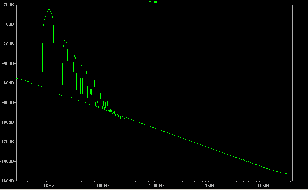

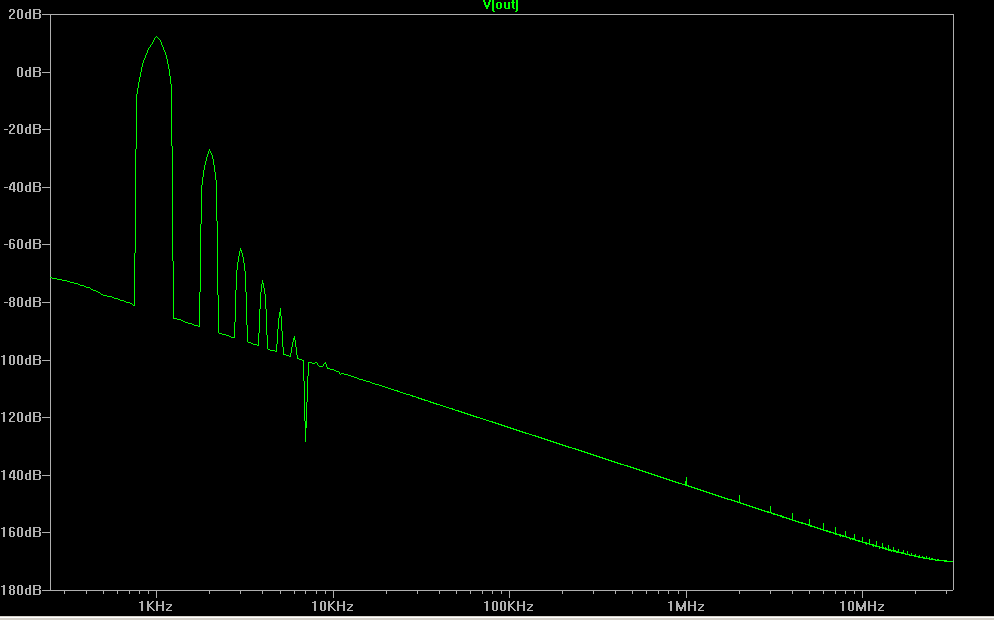

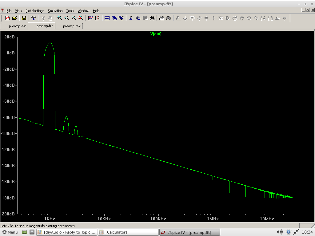

I went back and tried some different tubes in simulation for the FVP. I tried the 6922 and ECC88. The 6922 had 3%THD and the ECC88 had 5%THD. Yes this were driving the input with 1Vrms. When driving them with 100mV things did improve, the 6922 shows .3%. I know not to take the distortion analysis in LTspice as gospel but usually it paints a pretty good picture for what is going on.
Maybe the reason the FVP sounds so good is because of the distortion characteristics, it's not just say 2H, it has high amounts of third, fourth, fifth, etc....I use this technique for guitar amps to obtain a colorfully full sound. I am just thinking it will loose clarity during heavy passages where lots of things are going on, like an orchestra.
I attached an FFT log of the FVP using 6922 tube.
