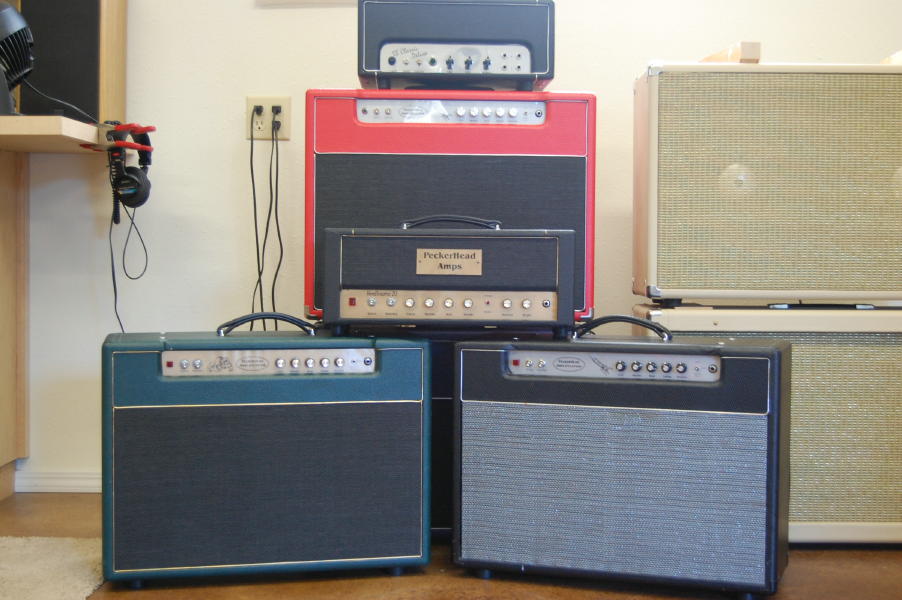

Hers a couple of my amps.

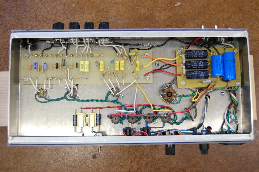

TW Rocket Gut Shot I built from scratch. I didn't punch the chassis.

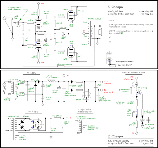

BINGO! Build an "El Cheapo" with those O/P trafos. While 6 WPC from triode wired 6V6 family tubes is not a lot of power, the project is a cheapskate's delight and sounds very good. If by chance Bogen used UL taps, you can tie the g2 resistors to those, instead of the plates, and get 12 pretty darned good WPC. A full set of power "iron" can be ordered from Allied Electronics, at modest expense, should you be interested.

I got the PT out of Bogen also. No UL taps. I've also got some got an Edcor EM0725A 650V/400mA PT, an EM0726 600V/250mA PT,EM0731 640V/250mA. What I don't have is a lot of is audio OPTs. Just the Bogans, but I dont mind buying more iron.
If you wouldn't mind the attachment doesn't blow up to well, would you e-mail me a copy. 1blindlemon at cox dot net

EL Cheapo
I can highly recommend this project, particularly if you have a scrap box of parts.
In my case the major organ donors for a pair of these were old Scott LK48 /222 amps, which required some revisions to Eli's circuit to take advantage of existing parts etc., so I ended up using EL84s, connected in triode due to the lack of UL taps, as well as a PCB kit from Greg at Classic Valve for the LTP CCS.
Unfortunately the complete tube set for this amp put a lot of thermal load on the power transformer for filament supplies (IIRC something like 9 novals plus the rectifier, and one went Chernobyl a couple of years back.
I finally got around to recycling the very fine OPT into another project with Pentode operation. As sweet as the triode sounds with 92+dB sensitivity Fostex full-rangers, the extra grunt of pentode is hard to ignore on speakers like the Mark Audio/CSS EL70 / Alpair 7 that I've been playing with lately.
Ok.....got a closer look at the schematic and I'm not sure I understand everything I see with the constant current LPT. The Bogan PT mains aren't CT'ed so I'd have to use a FWR although it does filament and another couple of yellow wires that if this thing had a CT I'd guess they were Rect filament wires. May need some help converting this to the iron I have.

Given the 450 ft.2 shop, I'm going to suggest an ultralinear mode 7591 based "El Cheapo Grande". That will yield 30+ honest W. and allow some cranking to be done.
Other than allowing for the requisite "taller" B+ rail, the 12AT7 based splitter/driver requires no changes. Edcore's $62.27 model CXPP60-8-6.6K O/P trafo will work well, without causing bankruptcy.
Ok, If I read it right the tubes will pull ~80/104ma ea plus a little more on top of that for the 12AX7. Will my EM0731 640V/250mA running a GZ34 be a big enough PT and provide the requisite plate voltage or run FREDs. I'm thinking the Edcor EM0725A 650V/400mA PT I have would be over kill? Plus since this amp is cathode biased I wouldn't need the 50V bias winding. Or am I not understanding the PT and rail requirements.

IMO, a combination bias scheme is best, in an "El Cheapo Grande". Current production 7591s will not tolerate a violation of the grid to ground resistance limit. OTOH, if the grid to ground resistance is low, LTP gain will fall below that needed to drive the "finals" and the NFB loop. "Standing" each pair of 7591s on a 100 Ω/47 μF. bias network protects against run away, doesn't drop that many Volts, and provides a very convenient test point for setting the "idle" current. The bulk of the bias voltage comes from a C- supply. Use 270 KOhm grid to ground resistors with confidence. ;) Even 330 KOhms is probably safe.
The constant current sink (CCS) in the LTP's tail forces symmetry between the 2 sides. When the current on 1 side increases, the current on the other side must decrease. The coupling at the cathodes is "perfect" and allows the I/P signal applied to the inverting triode's grid and the NFB signal applied to the non-inverting triode's grid to interact correctly.
BTW, the LTP is a 12AT7, not a 12AX7. High gm and low RP are your "friends" in driver circuitry. The 'X7 totally lacks those characteristics.
