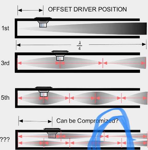

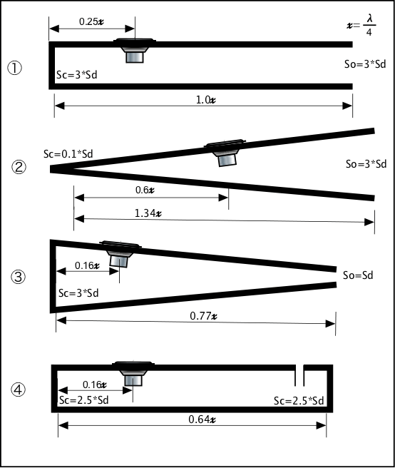

I suppose you mean something like the image i have attached? If i am misunderstanding you might need to show me some pictures of your Hornresp. Because i am completely new to it, So sorry if i am getting it wrong. But your design seems to have a 27Hz or so tuning. The goal is flat down to atleast 19Hz. If my normal ported design had a 27Hz tuning the port resonance wouldn't be a problem at all in the first place.Try 400cm2 for 105 cm (offset driver L12) then 100cm in the L23 and L34 segments.
Switch that From ‘Nd’ and ‘OD’ mode in horn and youll see as Nd is not offset (see schematic) .
But if you start with 350-400cm2 at 270-300cm, its easier/funner to learn(explore) from a size thats friendly for TS parameters...
If i make it tune lower it moved the first bad peak down to 100Hz in this TL design. (See second picture) Which is not great. Am i getting something wrong?

I tapered S3 and S4 until i got a lower tuning and put 150units of filler in segment 3(See Image1), It was interesting to see that the filling in S3 actually lowered the air velocity from 25M/S down to 8 M/S(See Image2). Though i have heard horror stories about putting polyfill in ported enclosures. Where it eventually starts coming unstuck and winds up getting stuck inside the subwoofer, Damaging it.Then go y

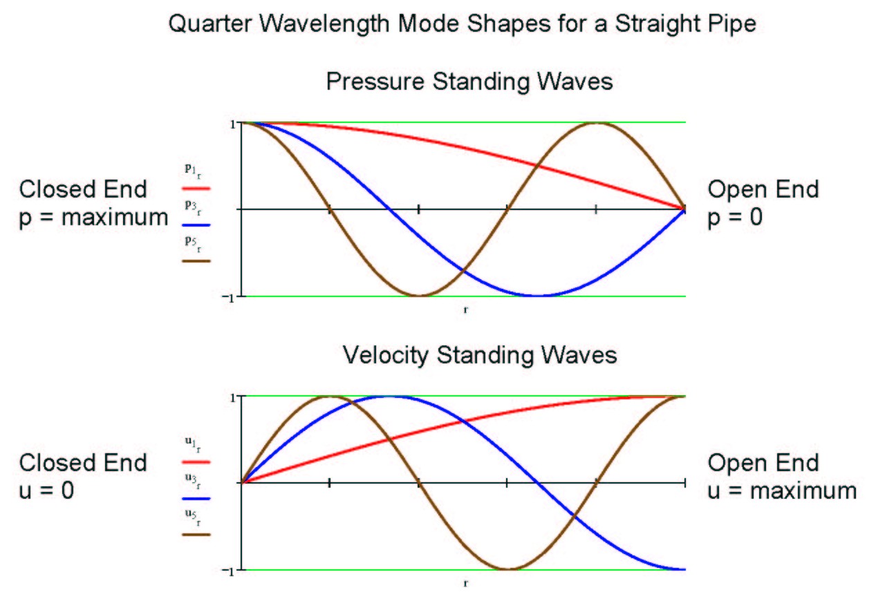

Interesting thread here. CharlieLaub says that even if you EQ out the port resonance they will still occur due to the movement of air moving in the port.

Thanks for showing me that! So the main driver playing near the first port resonance can generate it, Other speakers playing around it can trigger it and also port turbulence can generate port resonance ringing. Which would happen most from playing around the tuning frequencies. Which are 23.5Hz with three ports open, 19Hz with two ports open and 13.5Hz with one.Interesting thread here. CharlieLaub says that even if you EQ out the port resonance they will still occur due to the movement of air moving in the port.
I suspect that's a theoretical construct that practically does not result in any audible and perhaps even measurable difference.
