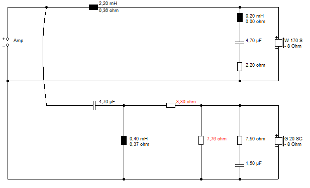

Yes bass light and a bit of sibilance around 4k.
I'll get my measurement equipment and software sorted then get them sounding much better, my baffle will have rounded edges and flush mounted drivers which will improve them again at HF and ready for new x-over.
It's not going to be very different from the Idunn filter:
Idunn

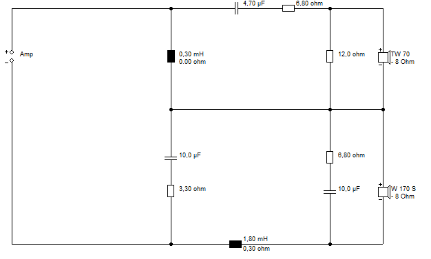

Possibly tweeter 3.9uf/0.25mH/6.8uF and attenuator after or resistor in front. Then you'd fiddle with the bass shunt. 🙂
Looks good to me Steve I might order the inductors and some different value ceramic resistors already got them caps about. Do you recommend a steel-core inductors with low dcr for now till I get values correct?
I wouldn't buy too many coils based on my guesses, but I did find the tweeter filter needs to be quite shallow here. This all looks quite adjustable by ear.
It came out at shallow second order on the tweeter. My original guess was way too sharp. About 2.8kHz crossover.
Just regard this as a ballpark first guess. 😱
I've been playing with series filters again too. Second below is what they look like for a cone tweeter. 😎
Oh, buy whatever coils and resistors are cheap. Ferrite will do. You'll get through a few tweaking it for frequency response. Then fit the expensive stuff. You always use air coils on tweeters though.

Thanks Steve i'll order sum cheap coils and resistors and get tweaking am sure I'll get them sounding better than they do now, until I get measurement gear and software.
