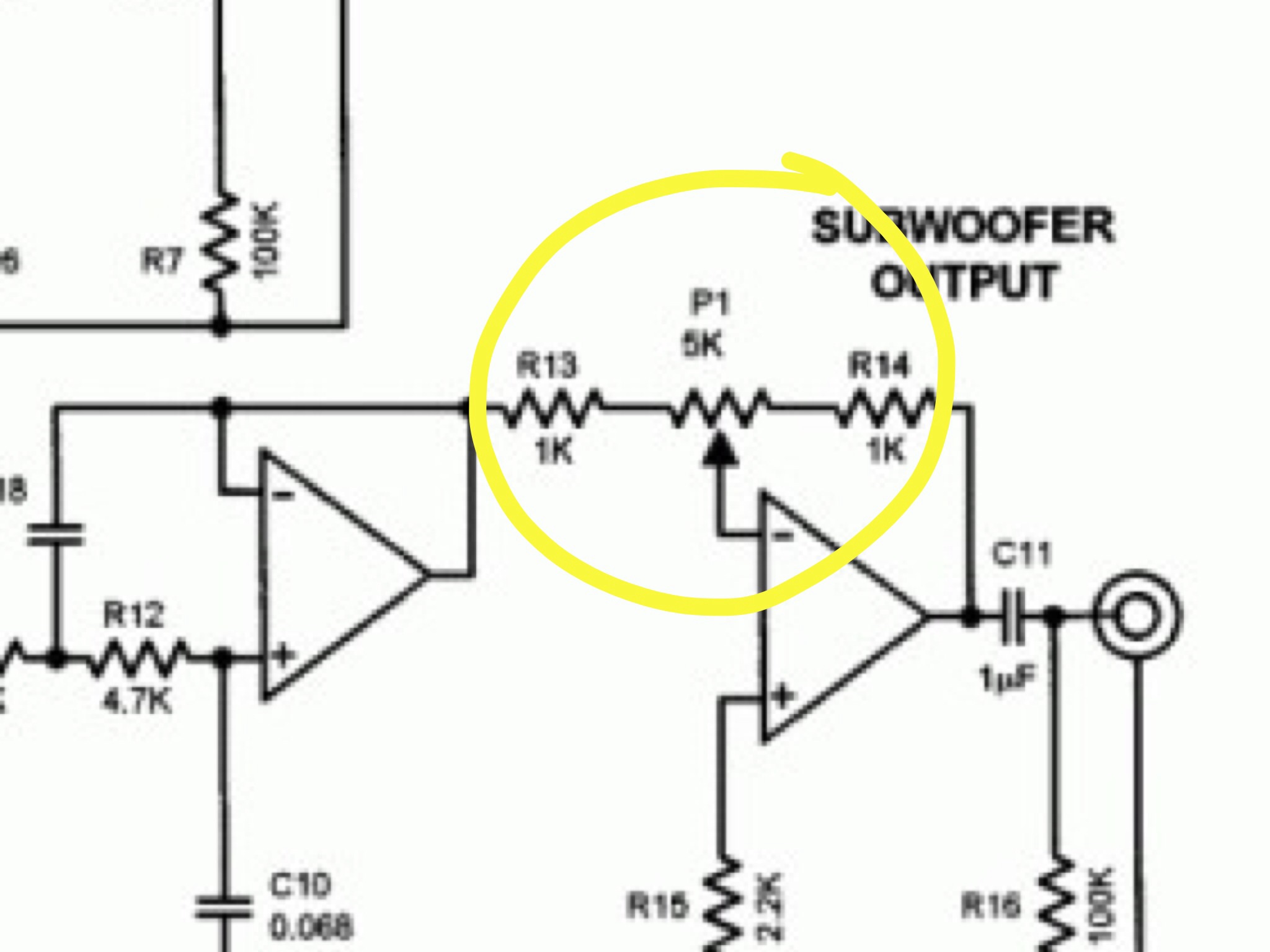

Now I understand the need to adjust the resistors and caps. It sounds like the Ti program (or something similar) will make that easy.
One last question. It looks like P1 is a simple subwoofer output control (not a frequency adjustment). Let me know if I got that right.
Thanks again for your advice!
Yes, it allows one to adjust the Bass channel to match the sensitivity of the other channel/s
But it is in the -IN input.
An open circuit here changes the gain.
Even a very short term jump over a bit of dust is enough to create a pulse on the output.
If you can, try to change to an adjust on the input to the +IN pin.
The reason for doing it as shown is to correct the phase reversal of the summing circuit inside the R8 loop.
If the bass does need that extra phase correction, you can apply it at the speaker leads.
