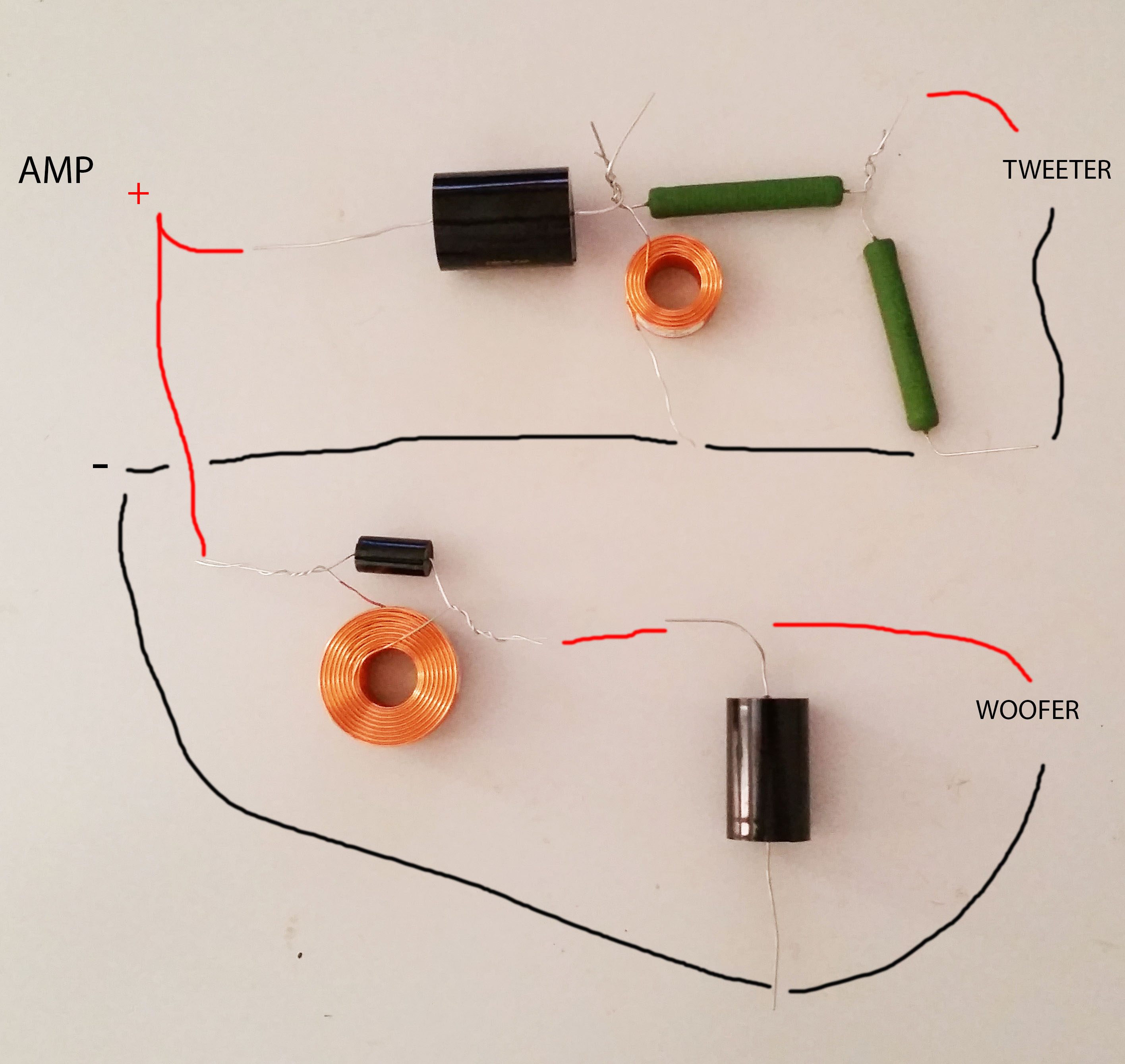

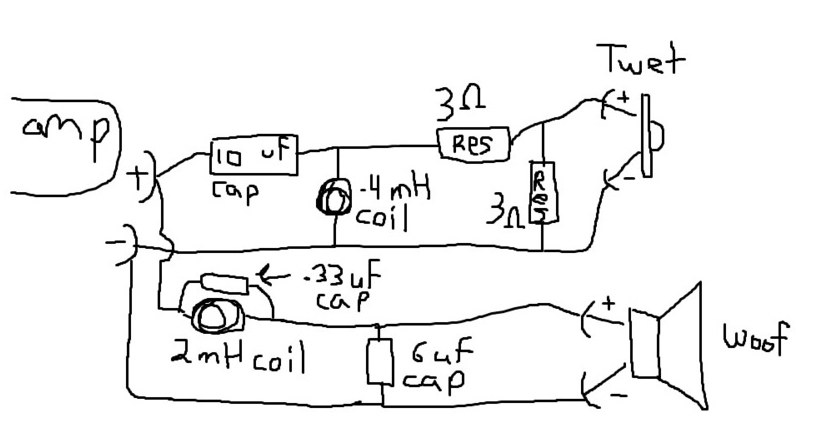

Hi all,
Due to this being my first passive crossover build, before i solder or test anything, can someone pls double check this looks correct based on the schematic?
I still have to tidy it up but just making sure the layout is ok
Thanks heaps!
What woofer and what tweeter? Impossible to say if the correct component values. Did you designed it yourself? The LF .33 cap gives a better roll-off at crossover frequency (probably). The components position looks ok, a repeat from Choong above. Have fun.
