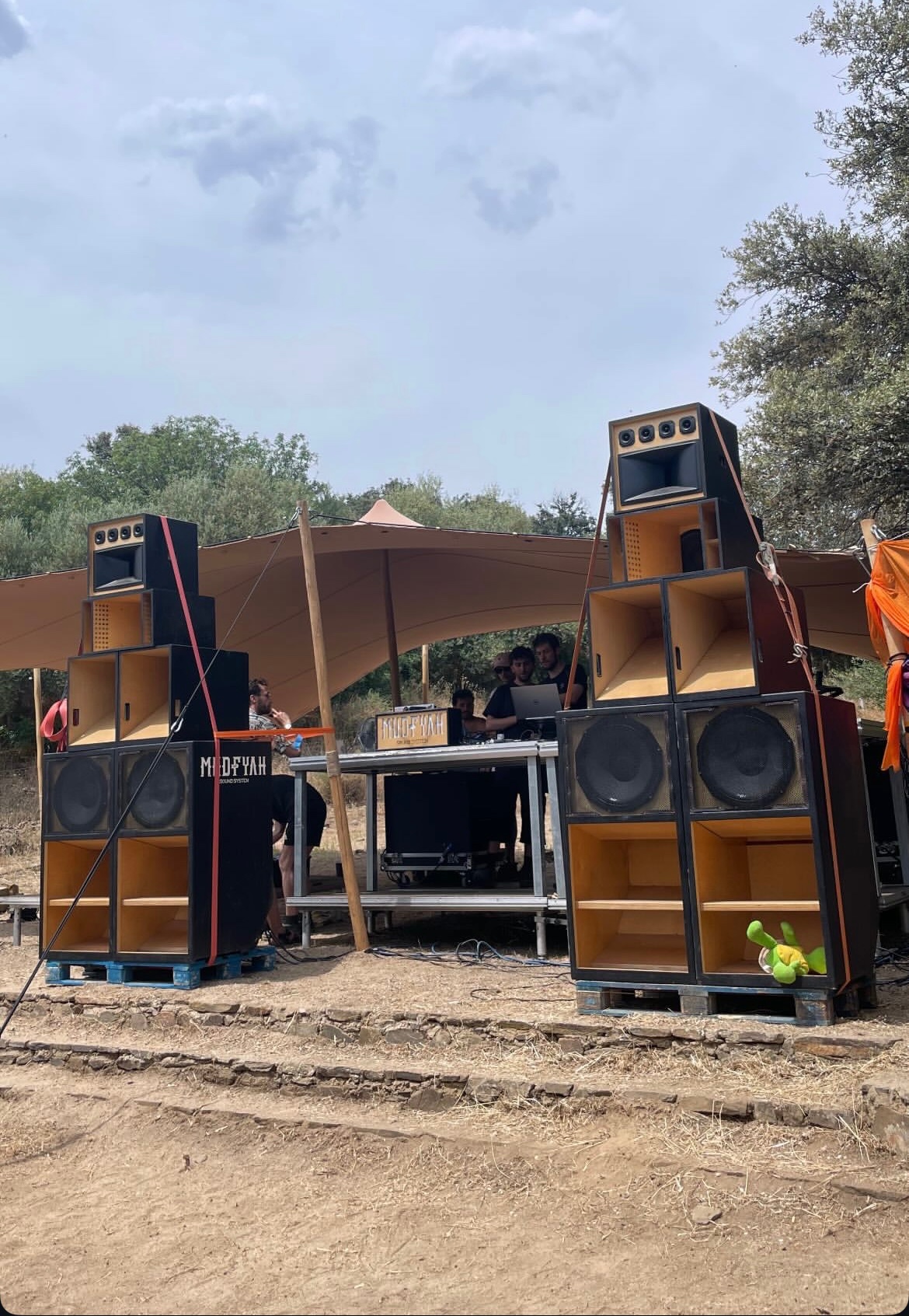

Thank you but i need info on how to build my own PA, I am looking to build something like that:
Do you have a pic of their amplifiers? Honestly, it looks like it sounds pretty bad. The boxes are not going to have good FR, and the boxes will resonate. The audience will have uneven coverage for FR, etc. EQ cannot fix all the problems.
Anyway, do you already have table saw and router? If so you might start adding up the cost to build something like that. From what can be seen, it will take some number of sheets of plywood, and several drivers. Then there is cabling and connectors. How many watts of power and how many amplifier boxes are they using for that?
I mean, if that's what you aspire to, and if you have a budget of no more than $7,000, then first thing to do is figure out if you can do it for the budget you have. IOW, start planning top-down. Then start again bottom-up which is where it seems like you are trying to start from now. Maybe you want something like this: https://audiojudgement.com/folded-horn-speaker-design/#:~:text=Applications,which has around 0.5% efficiency. Or maybe like: https://www.google.com/search?sca_e...HUuPHkQQtKgLegQIERAB&biw=1654&bih=898&dpr=1.5
