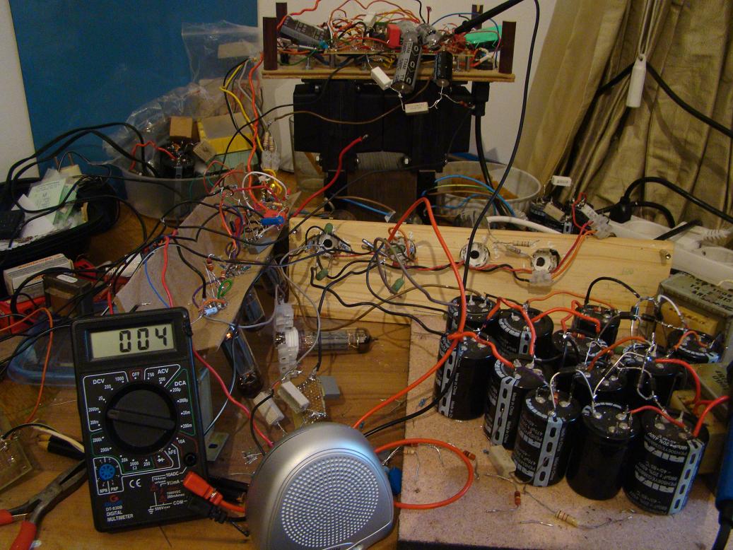

First OTL breadboarded
First OTL amp (circlotron concept) breadboarded and sweet music coming out albeit only with 2 x 6080's on 1 channel.
Driver topology a little different to most.
But with only 1-4mV DC.
You can see the voltmeter on the 2000m setting.
Still trying out different designs of CCS on the LTP but so far so good.
Now it's time to build up the tube bank of 6080's and buy some bigger transformers.
Also would like to incorporate some kind of speaker protection.
Maybe relays?

One question about the DC offset.
If I keep the grid bias below -29 volts the dc if low (1-10mV).
If I begin the increase the grid bias to then the dc on the output increases!
I thought the DC balance was due to the balance of the signals from the splitter/LTP.
Also without a 8 ohm dummy load the DC offset is higher. (100mV or more). When I switch on the dummy load or speaker if falls.

The DC offset wonders a little but only in the 2-15mV range which is no problem. (my SS has 12-15mV)
Whenever I tried setting the grid bias on each rail equally this is when I got more DC offset.
I could reduce the DC to zero but with each grid bias set to within about 5 volts of each other (in any range, low or high).
I check out and saw that one of the floating supplies voltage is slightly different to the other (maybe explaining the grid bias differences).

Working on this more I can achieve 0 volts DC offset if I adjust the grid bias prior to the source folowers correctly.
BUT when they are balanced (zero volts DC), the grid bias voltages are about 8 volts different (-41 and -49 volts for example).
What could this be due to?
1) floating supplies not equal ( about 9 volts difference between the 2 floating power supply transformers)
2) difference is current through the FET source followers
3) difference in tubes
Thinking about this further I suspect the grid bias difference is due to the floating power supply voltage difference.
I assume they must be of equal voltage. Maybe I can reduce the stronger one with a resistor of the correct value and go from there.

Easy to find out.. switch tubes and measure, switch power supplys and measure again,...
Cool, I want to build a circlotron too.
With low mu tubes like this a difference in plate voltage will make a relatively large difference in the cathode, just like u observe. These tubes are not well matched either so that adds up, dynamically that doesn't seem to make much of a deal). Perhaps a slight difference in the cathode followers driving the output adds a little offset as well. The most important is that u can adjust the offset, and that it doesn't drift too far.

I swapped power supplies - no change
tube - no change
I will try more tube swapping, maybe I've got a very uneven tube in the batch.
Or could the source followers be causing such a difference in grid bias to get zero DC at the output?
We're looking at 12-14 volts difference between the rails in order to get zero DC.
Nope, tube swapping still the same.
Also I have 100 volts on the plates and around -40 bias. I measure across the cathode resistor, 0.55 volts, 3.9R = 141mA!!!!! (too high)
But the data sheets show more like 60 mA at 100volts, -40 volts grid bias.!!
I'm assuming now it's the current flowing through the FET's. They are not equal, even with the same resistor and neg/pos voltage on drain and source.
I think I will need to tweak the resistor to source or try a current sink regulator such as a 10M45 to match the FETs.
