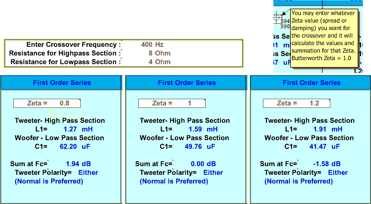

First order series crossover with 8 ohm fullrange and 4 ohm woofer?
Don't worry that much. It's not significant.
1st order series are very forgiving re. driver impedances, etc.
As Planet10 said earlier the term Zeta is the important bit, it will determine the slope of both halves of the filter.
Zeta = 1 is exactly like 1st order parallel Butterworth and by varying Zeta by varying the values of your passive components, a coil and a cap, you get either an overdamped or underdamped response at the desired xo freq.
Get a copy of XSim or VituixCAD and play with it, you'll quickly see what's happening.
This actually applies to second order filters, not first order. (excluding coil DCR & variable impedance correction)
I am pretty sure it does. I wish i could find th simulator that showed the changes as curves in response as you vary the specific C & L combination.
From Jeff Bagby’s XO Calculator

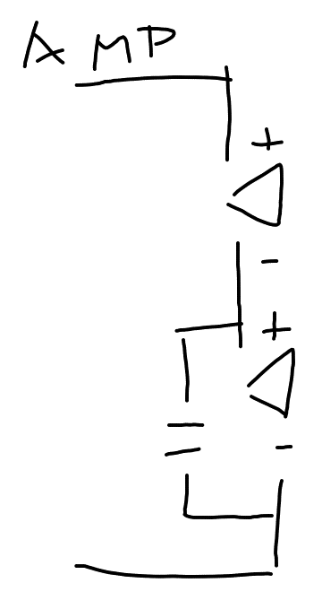

I want to marry a 20cm 8 ohm fullrange driver Beyma 8agn with a no name 4 ohm bass with a series filter as a one and a half way system. The Beyma not being filtered but only the bass.
I have 220uF at hand giving something around 150Hz crossing for the bass. (bass gets shorted with the capacitor)
I guess in this configuration the impedance add up in the bass like 4+8 ohms?

Re: your 1.5way connected in series, the bass driver had better be more sensitive than the fullrange, as it gets less than 4/12 of the total voltage.
...with a series filter as a one and a half way system.....
If you mean a series xover, then this will not work as you think. You have to have the coil in the main leg or you are essentially shorting your amplifier above the Fc of the 220uF cap.
...I guess in this configuration the impedance add up in the bass like 4+8 ohms?
Again, series xovers do not add the impedances of the drivers like you presume. More often than not when using the conventional circuit layout for these, the adjacent driver is shorted in the bandwidth for the intended driver so they stay the relative impedance of the drivers to either side of the xover point.
If this is not what you are referring to, then it is likely not a series xover. Look up Acoustic Reality Series Crossover for clarification. Peter "Friend" recommends removing the cap across the woofer, but in my experience this shelves down the woofer response by placing the (now hot!) resistor directly across it.
If you think none of the above is what was queried, and you have your 2 drivers directly in series with the cap across the woofer, as it could be inferred that way, it likely will not work as expected unless you also place a large value Icore coil across the widerange.
Usually yiu see that with 2 drivers the same. The cap shunts the HFs around the bottom driver so it only reponds at LF. Impendance above the roll-off will be the driver running FR, the sum of the 2 below. It crooses over 1 of the drivers and they are connected in series, it is the simpliest of LP as a single cap in series with a tweeter is the simplest HP.
How it would work with 2 different drivers would be “interesting”
A much better drawing and a more thorough explanation.
http://www.planet10-hifi.com/downloads/Dual-Driver-Wiring.pdf
dave
