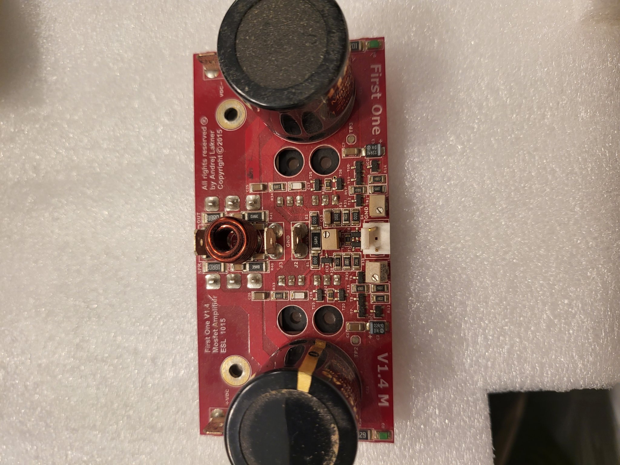

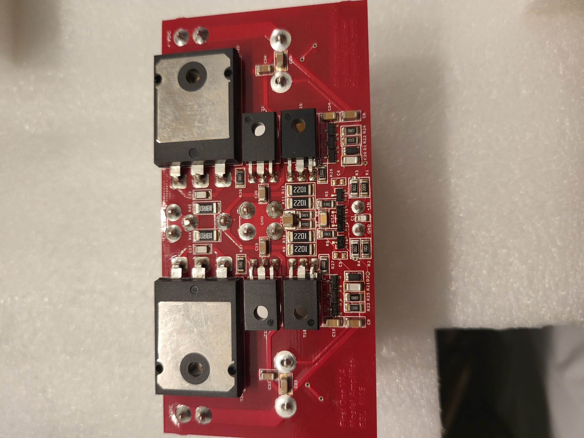

Did anyone managed to reverse engineer the board to get the circuit so we can debug the issues?
take pictures of the board and the transistors/diodes.. There are markings on top. That part i can help you guys with to translate to transistor model.

Any close up picture of The board and traces would be very helpfull. Resistor values and capacitors.
I pretty sure , that I have an idea of how it is made. Then I can do reverse engineering of the board.
I have some boards that I can find soon. But I don't think pictures will be alright taken from a smartphone.
Ok, but you could try.
You are located in Denmark. So you could send me one defective module if you have one.
Within a week I will take a picture. Now I know where they are. I think about using a Smps. What voltage do you recommend. I don't remember.
I have a few of these I never used if you want pics of the 1.4m I think it was I can take some.
