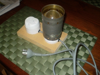

Howdy PJ,
I suggest just forget the switches. I rely on the wall switch or the switch on the equipment under test.
I've attached a pic of my tester. You can see the Aussie spec outlet on the board. I just used a standard mains cable from some appliance or other. Under the bulb is a standard bayonet bulb holder from a ceiling fitting. The shade is a tin can.
Just think of the bulb filament as a continuation of the live wire; in through one terminal on the bulb and out the other. The other two are connected normally to the outlet socket on the left and just pass through under the bulb holder. I just use a 40w bulb for most testing.

Thanks for your comments Stuey.Stuey said:Howdy PJ,
Cheers
Stuey
