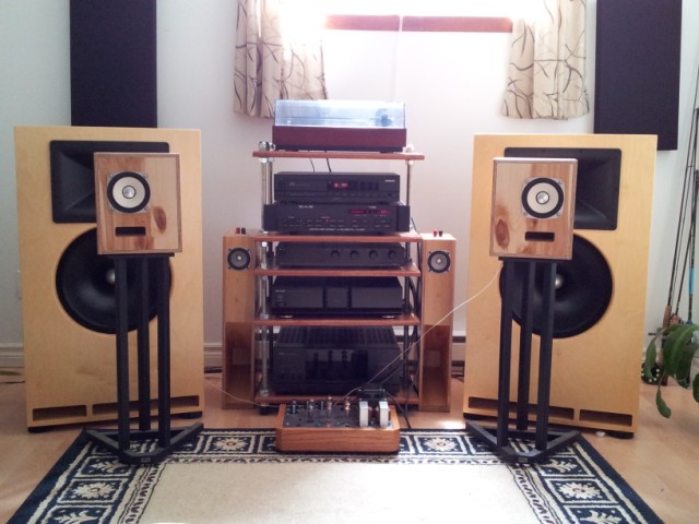

Pro and home hi-fi -why limit oneself to fewer types of toys? 😉
Below, pro drivers trying to hide behind stand-mount Fostex:
attachment.php
