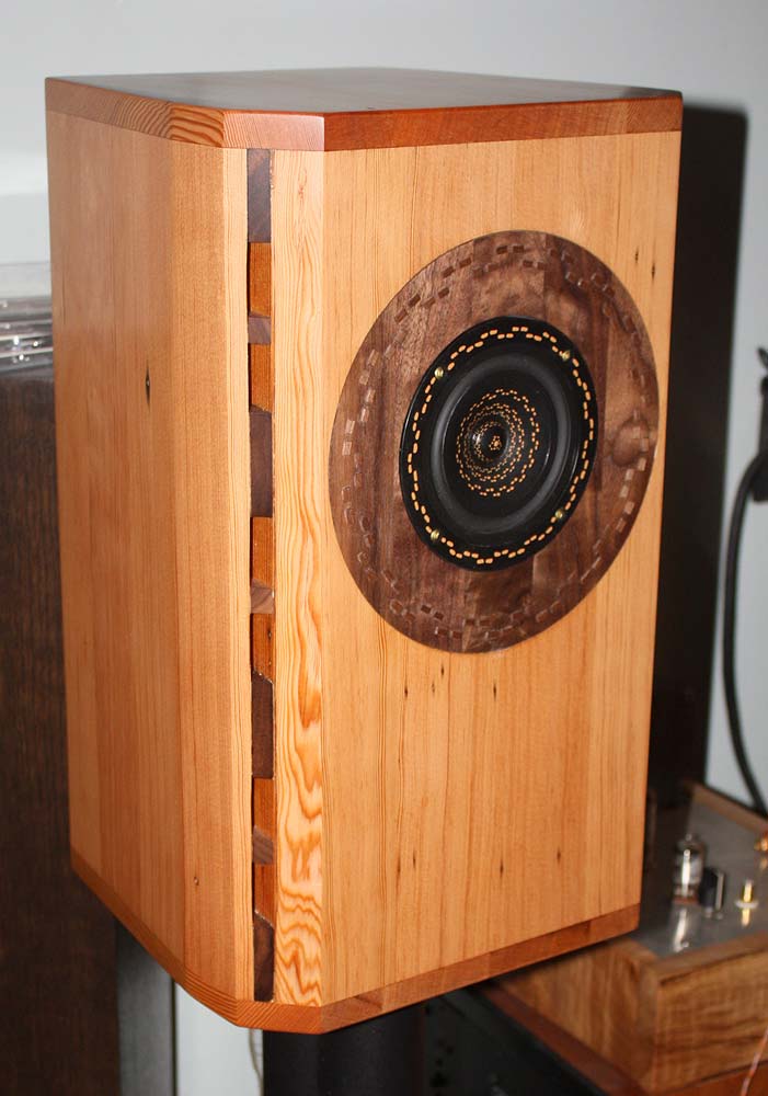

That looks to be dimensions such that it could well be in the transition zone… not quite either a BR or a TL. Actually measuring the bass response when built (not completely straight forward) and adjusting the vent size would be the way forward. Since it is a slot vent, and if it needs adjustment it is likely a lower tuning would be required, a vent spacer to decrease the vent area can be done (we have done that in a couple boxes when we repurposed a box for a different driver — the pictured box started out with 3 vents per side (original box is the 1st one in this thread miniOnken/Fonken gallery pictures only)). The quick bandaid would be to stuff the vent pushing it towards aperiodic.

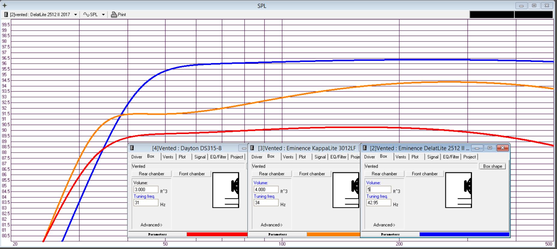

Hoffman's Iron Law Example: Three 12" woofers with different efficiency, -F3, and ported box volume. WinISD plots attached.
-3db @32hz 90db/w 3cuft Dayton DS315-8 $75
-3db @34Hz 94db/w 4cuft Eminence Kappalite 3012LF-8 $ 185
-3db @40Hz 96db/w 5cuft Eminence DeltaLite II 2512 $125 (-3db @36Hz in a tall MLTL box)
