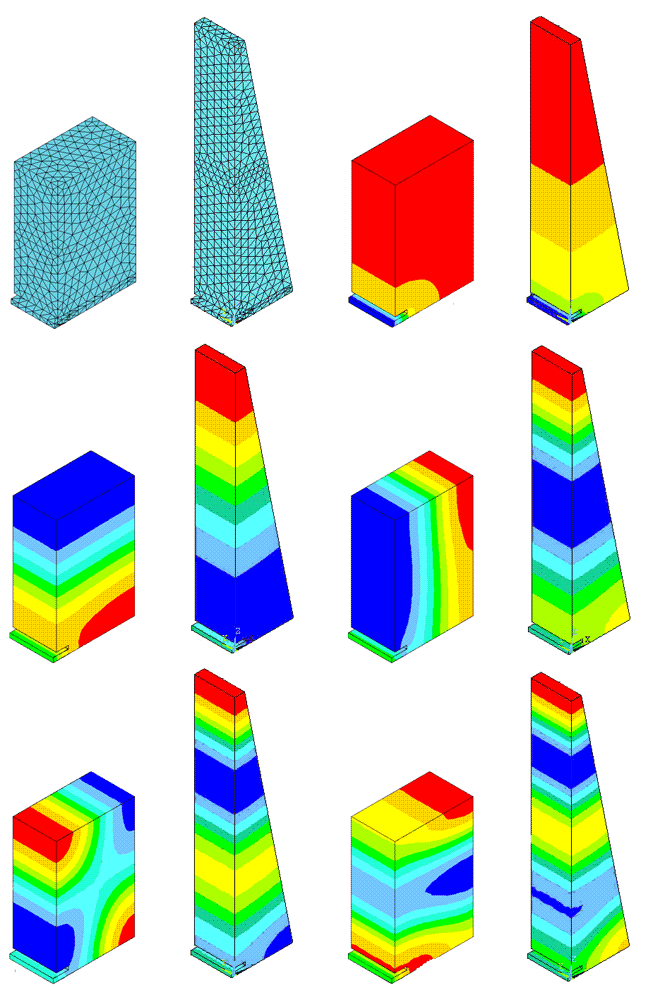

Keep in mind F3 is only meaningful (Toole) in the filter sense, since you aren’t XOing to anything lower F6 or F10 are much more meaningful.
tower
If it is a tower, box dimension ratios will mostly likely make it an ML-TL so your bass reflex sims are not telling you what is happening. You should be able to go lower with a properly tuned ML-TL.
dave
I'd thought about a TL, but I don't have any experience on those at all yet. Seems like it wouldn't make the box much bigger though... Might have to do some research on that.
The fact is that if you build a tower shaped box it will have a quarter-wave resonance and won’t be a BR. So you should approach the design from that point-of-view.

Field tested TL ( actually, MLTLs - "mass loaded") or similar topology designs abound hereabouts for which all that pesky math as already been done. The costs of entry and learning curve for much of the measuring and modeling systems now available to the enthusiast aren't as much of an obstacle as in the past, but there's still no substitute for the experience of many years of builds that didn't quite work out exactly as anticipated - sometimes surprisingly better so.
Yes, a CNC can be a wonderful tool - very effective and repetitive - but the design needs to be right first.
I'm still in the learning curve for sure on these things. I'm getting pretty confident with sealed, and ported, but that's about the extent of it thus far. Is there a difference between MLTL and TL, or is MLTL just the technically correct term for all things transmission line?
No, there's a lot of daylight or "new math" separating "classic" / old school TL theory and the more recent designs thanks to the very generous work of folks like Martin King.
Spending a few days down this rabbit-hole http://www.quarter-wave.com is highly recommended reading. My own personal take away was - let the real math geeks (Scott Lindgren, Bob Brines, Dave D etc) go to town with this - just give me a set of accurately dimensioned drawings.
King & Augspurger’s TL modelers (perhaps more accurately called quarter-wave modelers) showed that the TL space was much larger than we imagined. And that traditional classic TL design was woefully inadequate. A traditional TL is essentially a long line that gets smaller as it approaches the terminus. A TL that expands has in the past been known as a Voigt (or TQWT/TQWP tapered quarter wave tube/pipe). In between are straight pipes with no taper. Mass loading a line means adding a restricted terminus — often in the form of a vent. Turns out tapered TLs are usually best if they have a significant taper ratio, and the Voigts really need to be mass-loaded. A straight pipe can be much shorter if it is mass loaded. Such an ML-TL often looks like a tall skinny bass reflex but isn’t — the way the air works inside is quite different.
This is a ML-Voigt but it gets the idea across.
Horns also turn out to be in TL-space but are further out along the axis as Voigts with more exotic taper and other details.
Something else that modern TL modelers showed us is the advantages of having the driver offset from the end of the pipe.
