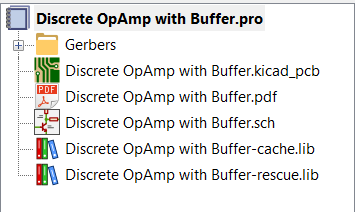

No need to link the cache libraries in 5.1.6, that's implicit when they are created, you just need to make sure that the entire project files are available if you copy a project over to another machine or folder.
Here is an example of what you will see when you migrate a 5.1.6 project to 5.1.8.. (the first attachment)
I'm pretty sure I am no longer using any of the rescued schematic component files, and probably don't need that file any more, but I left it in place.

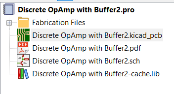

An example of a 5.1.6 that has been converted to completely native 5.1.8
