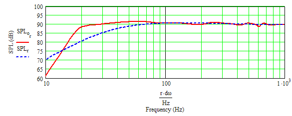

Various forms of damping is normally used to attenuate any spurious out-of-phase mids/HF output due to standing waves in the box and/or in the vent that can comb filter with the mains output, reducing clarity, perceived attack/decay rate of transients, etc..
Carpeting is so dense it's normally only used on subs and then only 'noisy' ones. In sufficient quantity, fiberglass insulation, wool, polyfil, etc. stuffing can increase the cab's apparent acoustic Vb, i.e. lower its Q: http://web.archive.org/web/20021007....cyberglobe.net/caraudio/resources/fiberfill/
Note that a well designed rectangular box only requires minimal density lining of the top, back and one side wall and even less for cabs optimized for minimal reflections.
Can't say I agree with the others about high Q drivers being only suitable for sealed and/or de facto having too low a SQ since some of the highest SQ speakers (including horns) I've built used high Q drivers. As Tom Danley has repeatedly pointed out in both postings and in the products he designs, it's all about using the right driver for the app. Of course none of this is meant to mean this particular high Q driver has any SQ to speak of, just that knowing MTX and many other car audio manufacturers have a long history of selling junk we shouldn't dismiss them all out-of-hand for HIFI/HT apps.
Anyway, traditionally, high Q drivers are used in OB, IB, TL, MLTL, true bass-horns and really large vented alignments, so it boils down to how big can you tolerate. At a glance it looks like ~7.773 ft^3 minimum is required to get to a useful ~20 Hz Fb, though it could be made tall to fit in a corner or lay down along a wall such as this MLTL:
L = 84.875"
CSA = 158.247"^2 (suggest 16" x 9.9")
zdriver = 29.187"
zport = 81.875"
dport = 5"
Lport = 8"
All dims i.d. and approximate. Sim uses 0.3 lbs/ft^3 of polyfil spread along its length.
i dont think this driver deserves 8 cubic feet of box
in fact i dont think any 12" driver deserves a box bigger than 3 cubic feet
im not saying it wouldnt work ... im saying that anybody willing to look at a 8 cubic foot box every day might as well put a 18" driver in there
just because you can do something doesn't mean its worth it

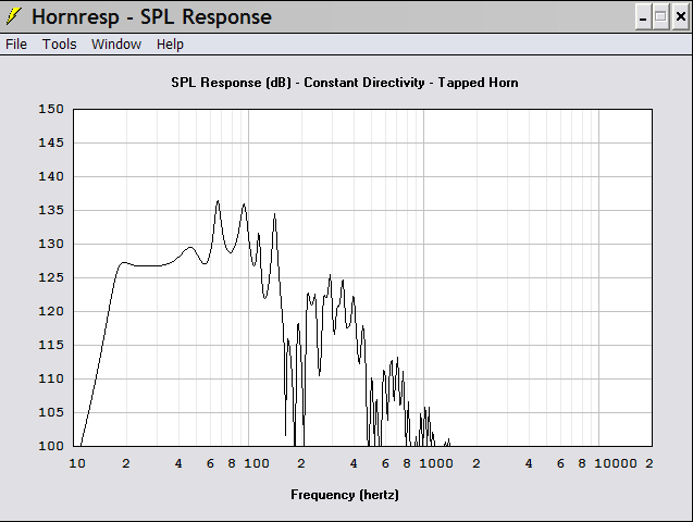

Due to the driver's relatively high Vas, low mass corner (Fh), it takes a big box to go low, 505.914 L net, so a bit large for your room size and with a small room, probably way over-kill, so hard to justify the size.
Still, it doesn't sim too shabbily if the specs are fairly accurate and could have its footprint halved for 375.075 L net along with a ~6 dB increase in output if a clamshell isobaric pair was used combined with a 300 W amp capable of driving a nominal 2 ohm load as simmed.
Really, this one is so overkill for your room size that I doubt you'd ever use > 20 - 25 W unless you're hearing's as far gone as many older 'rockers', but SQ would be a moot point due to it barely moving even on < 20 Hz spikes:
GM
I knew It was going to be an overkill, until I realisez that I had a V.U. meter on my main amp (Aurex St-335 MKII). When on normal listening condition, it seems like im not going really high, less than .5W (that is, IF the Vu Meter is accurate). Then I knew it was going to be one hell of an overkill:bigeyes: Anyway... I'll probably move it out to the basement (we have a 3/4-the-house-size room in which there is a computer and some videogame consoles) and build a smaller, less powerfull, accurate *I hope*, sound system.
