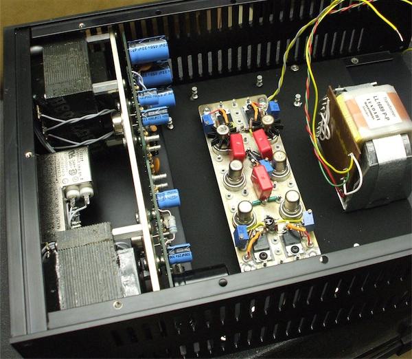

here's a mic preamp I'm half way through building., it's just about as simple as possible.Eli Duttman said:Assuming a "mike" preamp is the object of your desire, I strongly suggest you find a different circuit.
It's intended to use a L7824 regulator to provide the phantom power, and run the valve heaters in series. On sim it gives exceptional performance for so few parts!

Hi Merlinb,
I did built something with very similar front end and ended up discarding it.
The problems were:
1) Noise. I tried a low noise version of ECC83--Telefunken ECC808 (different pinout), but it did not help much.
2) In order to overcome 1) I put an input transformer wired as 1:4 and got into overloading problems, when there was impossible to use with condenser mics.
Also looking at your schematics the 24V with 6.8K resistors won't work. If you increase the current (decrease the resistors values) it could work with SOME mics. There are however many mics on the market without DC convertor for capsule bias and as a result you'll get very limited sensitivity and degraded sound.
As a side note, I am not a big fan of changing gain by means of changing of NFB.
6.8k seems to be the industry standard for feed resistor, from what I can tell. Since I'm running 24V, do you think 3.3k would be a better choice?
I have not heard of any mics that won't work well from voltages lower than 48V, at least not from any of my sound engineer friends. I was under the impression that the 48V spec is a historical thing, and also used to power some more esoteric DI boxes etc.
I am surprised you had noise problems from a triode. Even the crappy ECC83 with its low gm has an equivalent noise resistance of less than 10k...
I know some people don't like variable feedback, but I'm an advocate myself (where valves are concerned at least.) Plus it seemed the easiest way of doing it in this small circuit, granted it wouldn't be appropriate for professional stuff.

Re: Merlinb
When you cathode couple any device be it transistor, tube or FET, you're up against Boltzman's constant. The Johnson shot noise will be multiplied by .707 or the reciprocal of the square root of 2. This will make a diff amp a noisy choice for a first stage in a transducer amp whose input must deal with a voltage in the -57dbv range. Also it likes to be kept symmetrical, balanced in, balanced out to do it's best job. I built a very similar preamp but had to cast it aside for too much equivalent input noise. A diff amp works best for an input of a line amp where the signal is way up out of the noise. The choice of the 12ax7 would be my last, noise wise. Maybe in 1959, in my youth, but not today. A 12ay7 is much less noisier and much better made and balanced from side to side. It also has a unique blend of transconductance to plate resistance. Also input transformer coupling would offer a much lower equivalent input noise figure.
Balancing this for CMRR with those feedback pots would be a pain! That negative tail voltage CCS on the cathodes of the input stage must be very well filtered for ripple will be amplified if it gets on the cathodes.
Cathode followers are another problem. Their square wave turn off time is MUCH slower than their (turn on) rise time. You get this deep curve to the down turn off signal. A White cathode follower would be better but a push pull transformer coupled output stage would be even better IMHO.

Merlinb said:
6.8k seems to be the industry standard for feed resistor, from what I can tell. Since I'm running 24V, do you think 3.3k would be a better choice? I have not heard of any mics that won't work well from voltages lower than 48V, at least not from any of my sound engineer friends. I was under the impression that the 48V spec is a historical thing, and also used to power some more esoteric DI boxes etc.
The 6.8K is a standard, which was accepted long time ago and BTW, currently being reconsidered.
Ideally, it can deliver 48V/3.4K=14ma max current. According to the standard, with 24V phantom the current should be doubled.

Well the IEC states a max current draw for any mic as 10mA, so I suppose I should be ok with 4.7k feed resistors then.Marik said:
Re: Re: Re: Merlinb
They can source current into a reactive load quite easily from the HT, but must sink it through the cathode resistor, which is quite large.Majestic said:Without wishing to hijack this thread; clueless newbie here, and I was just wondering what's the electrical cause/reason for this above behavior?
According to the standard, for the 24V that should be 3.4K.
Let's say, you've got something like Earthworks with current draw of 9mA. Just calculate what is your voltage drop gonna be if you going with 10mA 😉.
BTW, personally, I'd go with 48V.
