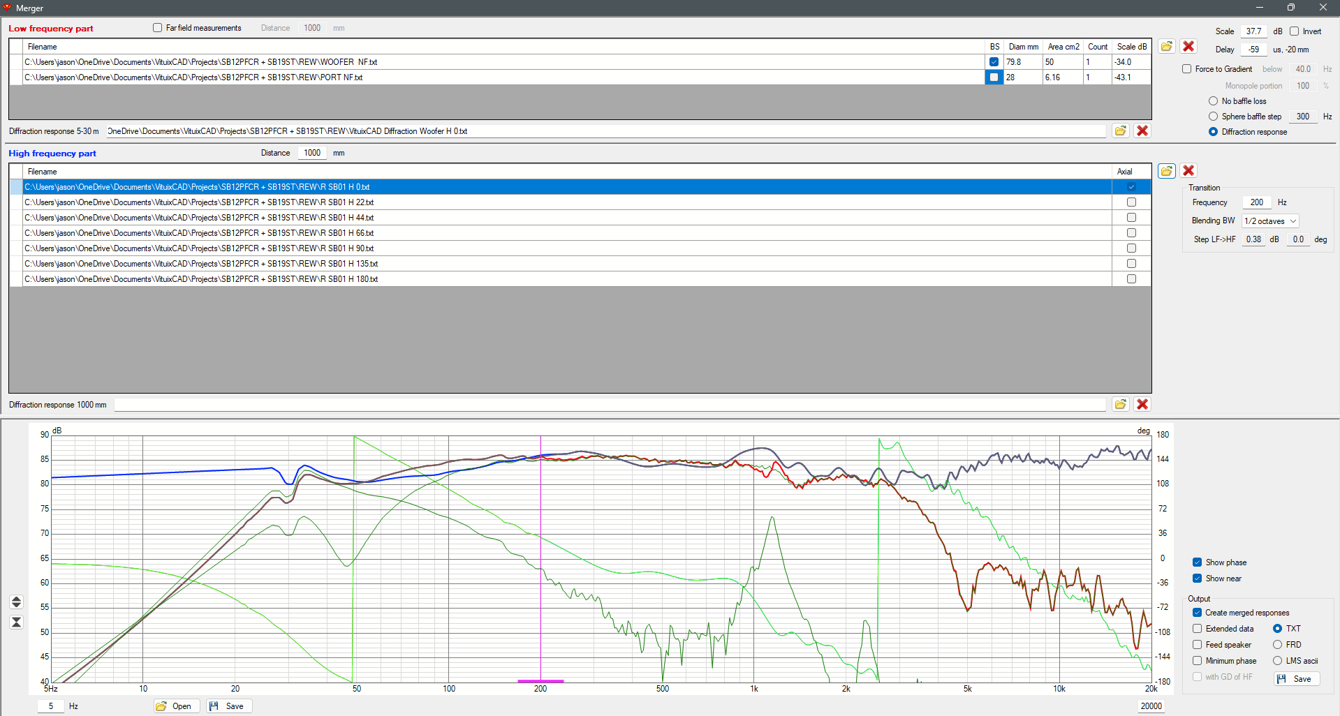

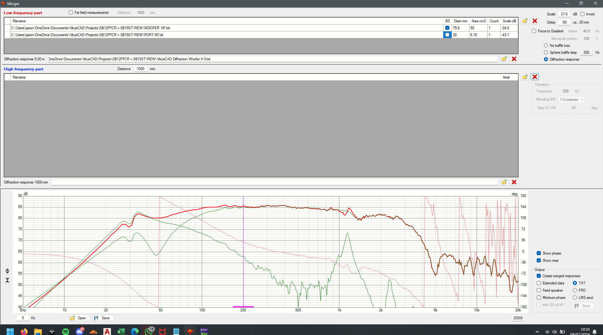

Yes this was my screen, I've inputted the area to be the diameter of the port and Sd of the woofer, what was the third item in ;your screen? It mentions something along the line of diffraction (?)
And this was the screen when I inputted the farfield response (tweeter level)
From the sims though it was quite far, the crossoverpoint was supposed to be at 3k, whereas in the mergerscreen, it seems like the -6db is around 4k

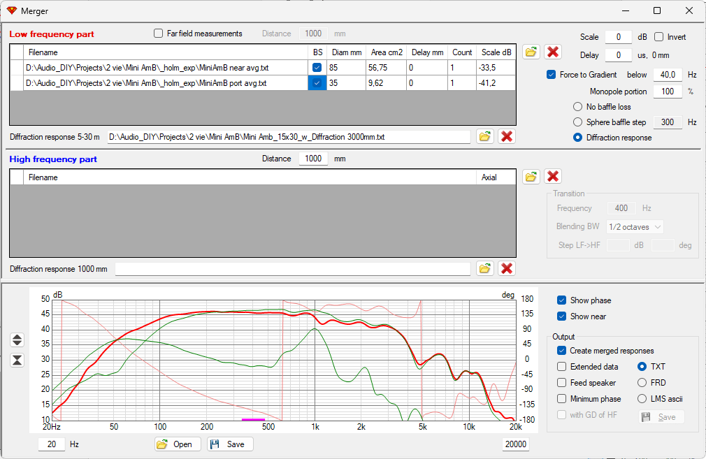

My bad, this is the correct one. The farfield curves are missing as it's a speaker I did a long time ago and I do not have any measurements without dismantling it.
Earlier I wrote about the rather severe baffle step of such small enclosures. In your sims earlier you demstrated a peak of about 3dB on 1kHz. I was not surprised it actually is there.

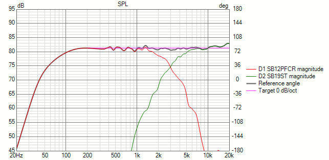

f3 of 61 Hz for a 4 inch seems pretty low to be honest. maybe look at your excursion? it will probably hit Xmax really early. this will cause heavy distortion when Xmax is reached. could you plot the excursion graph and give the needed power to reach Xmax?1. Enclosure Design
I've inputted the parameters on the Enclosure Tool and come up with the tuning below, then I exported the SPL and Impedance
