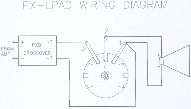

Hi all. I'm in the process of building my first crossover and before I go and start laying out and drilling, I was hoping that someone could confirm if I've wired this properly per the schematic (done by Solen). I know the arrangement of the parts is way wrong but I just want to confirm that my tie points are correct.
Since I'll be fine tuning values and upgrading caps, I'll likely use terminal strips like Troels Graveson to facilitate easy swapping. Like I said, this is my first build, so would be so grateful for a confirmation. Thanks
